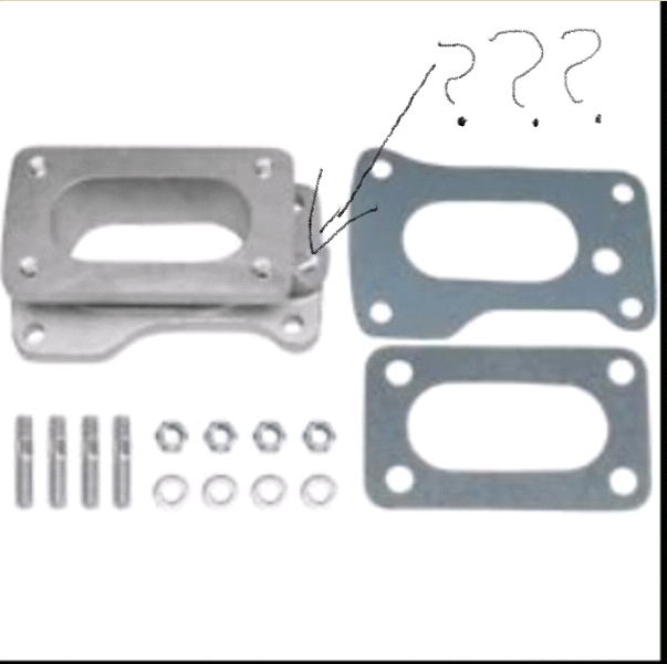

Alright still working in this weber ( I work alot ..hard to find time). This trans dapt adapter is about to drive me nuts. My question is...what is the 4th hole in the adapter?? Do I plug it up? Do I plug something into it? The pic may help

Never mind!....found it...i gotta plug it up.

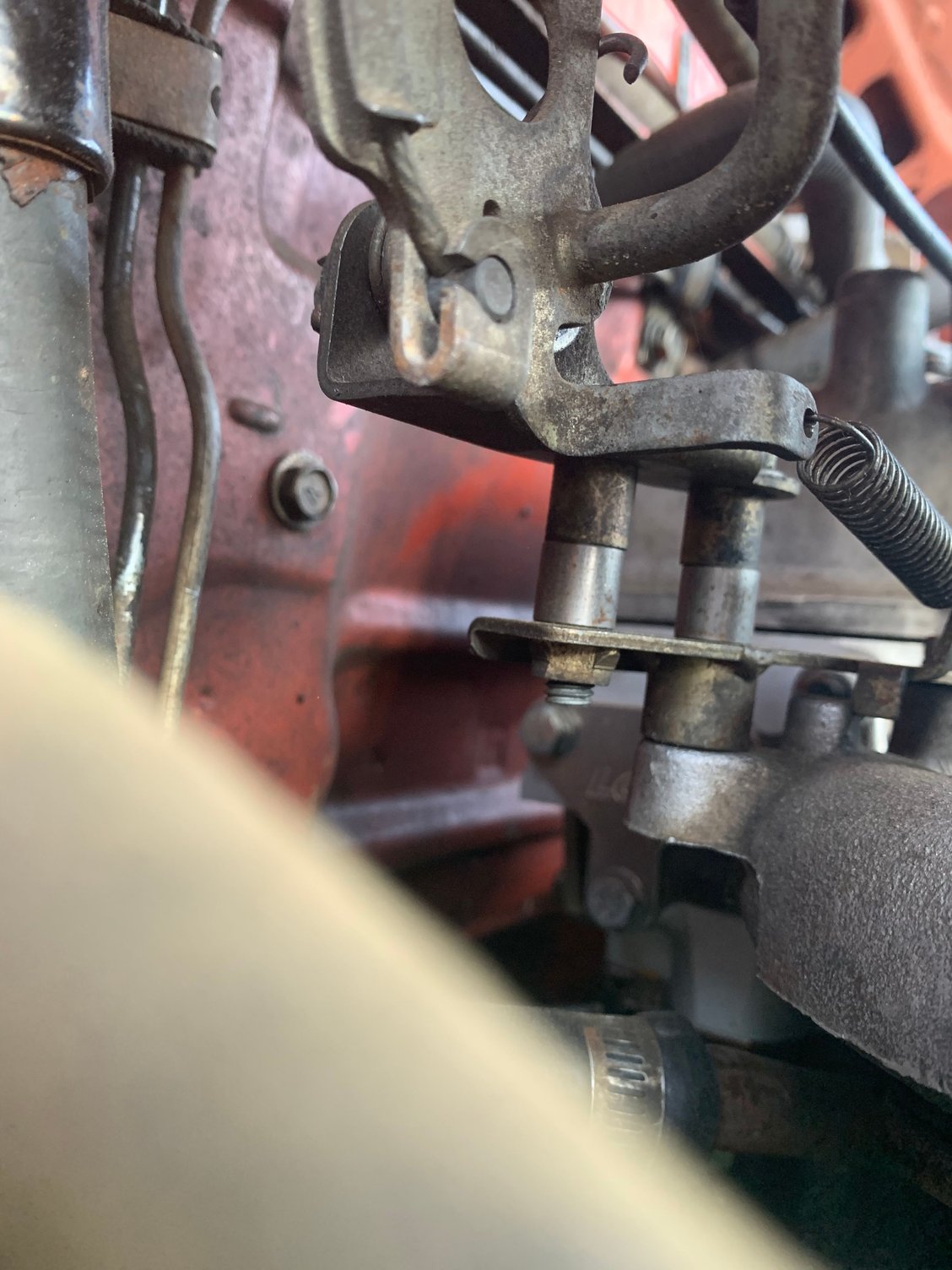

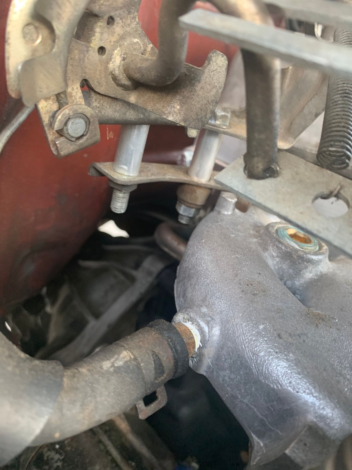

Spacers for throttle linkeage
Two spacers high. The ones that come in kit about 1" high. I bought a piece of straight aluminum pipe and cut for second one. I beleive 8mm inner diameter.
This is on late model 20r intake (1980)
This in on a 20r intake early model (late 70's)
