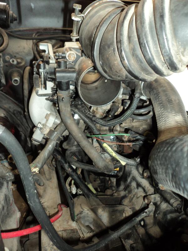

so i finally got my 22rec, 1985 granville 4runner running after a 2 month long head gasket repair. took a while to get materials and funds, along with knowledge and just plain time to do it. anyway.. i keep getting REALLY bad vacuum surging. i am pretty sure i know why. (see picture) i cant find where this connects to on the vacuum diagrams i have looked at. and was hoping you guys could help me out. it wont run if its not plugged up. as far as the timing goes, how have you guys been timing your 22re's? i cant see the crank pully with the belts on well enough to tell. its pretty crammed. any help would be appreciated.

the open vacuum port is right beside the throttle body if you were wondering from the pic. its actually coming out of it.

That line either loops around to the side of your upper intake manifold, on the valve cover side, or it plugs into your aux air valve. I'll figure it out when I get home.

okay. if you could take a picture of everything under your throttle body that would be a huge help. i guess thats asking a bit.

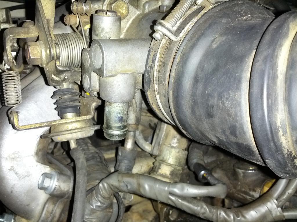

Yep, that one goes to the aux air valve.

dude youre my hero. thanks a bunch. now does your hose taper?

No taper to that hose - same diameter from under throttle body to front of IAV.
There's also an air hose that comes off the back of the IAV. It loops under and around and attaches on the side of the air plenum next to the cold start injector.
