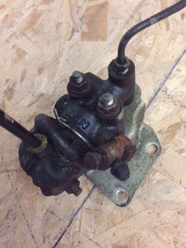

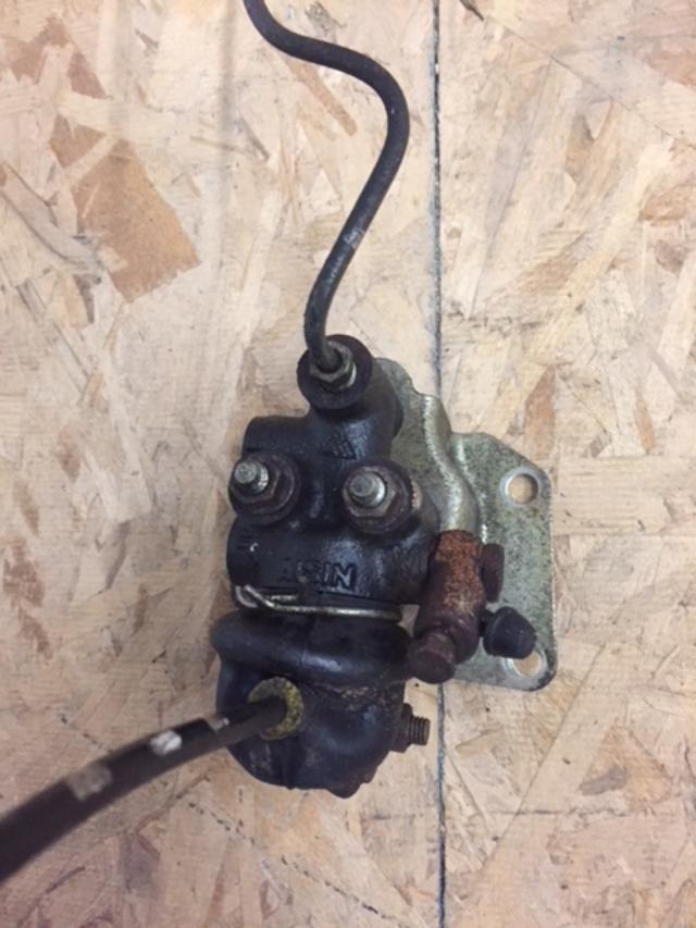

Do you know how I can check the valve to see if it's working?
Here are the pics
It's out of the truck and I'd like to check it out to see if it works properly.

Many ppl simple tie the arm of the LSPV up so it is in the most open position all the time, I did this for years. Some have cut arm off and use a turn buckle to "adjust" flow to back brakes. Is a guy on pirate that machined brass pieces to make LSPV a manual proportionate valve.
I have not troubleshot LPSV to verify function.

See the problem I see where people just tie it up is that you "might" get to much braking power to the rear wheels causing the rear wheels to lock up and cause "fishtailing" I would rather have it work the way it was designed allbeit maybe not the best design to start with. Next would be a way to adjust it so as to regulate the pressure. I still don't know how to check the valve when it's off the truck.

The tests are in the book, you can't do them off the vehicle without a way to apply and measure the hydraulic pressure. Best you can manage is to try checking the flow while you manipulate the valve rod, need some form of pressure tank, catch cups, measuring device..

I've never seen "how to" a LSPV function test. You could test it by measuring flow rate. So bleed all air out of the system then change height of LSPV arm, but get a baseline in either up or down, then measure amount of fluid (quantity) that can be bled off a rear cylinder on a single pedal stroke. Fluid quantity should change with arm height adjustment. Will need a to be able to measure small quantity. Maybe a syringe would with CC/ml scale with just enough brake fluid in it so no chance of air slipping into brake system. Us medical types call it "bleeding the the line."
I fully understand concerns of fishtailing from rear brakes locking up under heavy braking. Makes me cringe every time I see a member posting how the removed the LSPV and do not run a manual proportionate valve. With disc brakes rear I run the manual valve just above the lowest setting. How I set it was find a relative safe straight away and hit the brakes hard. Then adjusted accordingly, I did want any surprises when a hard braking situation came up while regular driving rig. You can do the same means of "adjustment" with tying up LSPV if you decide to go that route.
