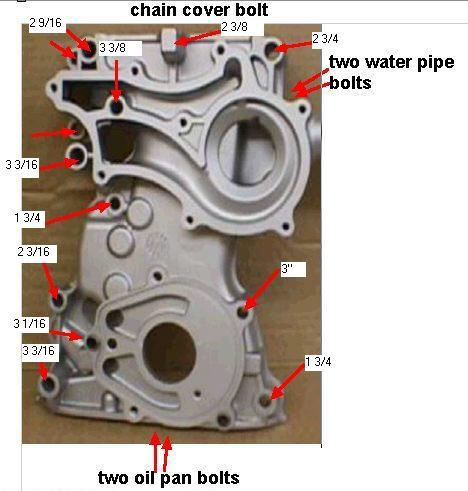

One more surprise...the hidden timing cover bolt below the distributor drive gear was not there when I took it apart. The po did say the head gasket had been replaced. Anyone know the specs on that bolt?

Thank you but not what I need. The hidden timing cover bolt below the distributor drive gear was missing when I took the engine apart. I don't believe the timing chain has ever been replaced so apparently someone replaced the head gasket and didn't put that bolt back in place. I hope they got the others right.
​​​​So I was wondering if anyone had an idea what thread and length on that bolt was. Should I use grade 5, 8, ss?

Oops, I figured you had a bolt in hand. I just replaced a hardware store bolt in that location with an oem bolt. 8x1.25mm threading, 50mm long threads. The hardware store bolt was 8.8 metric grade (comparable to grade 5) and never sheared or snapped for the 15 years it was in there, so it was fine. I only replaced it with a Toyota bolt cause less sockets and wrenches I have to use.

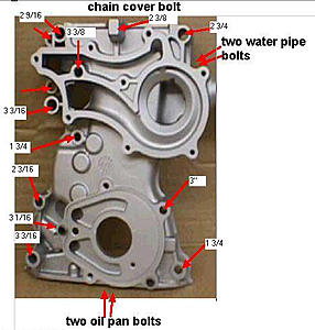

Ok try this link for more info. Grade 5 should be plenty strong but if you have doubt go grade 8.
http://www.4crawler.com/4x4/CheapTri...ingChain.shtml
