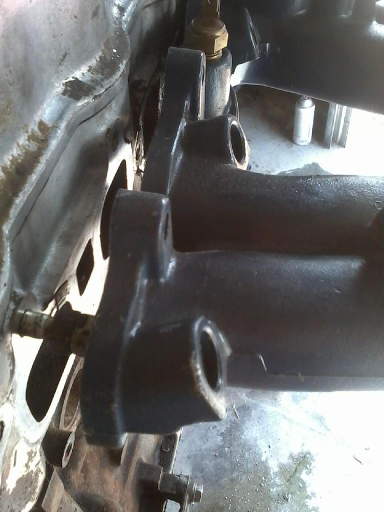

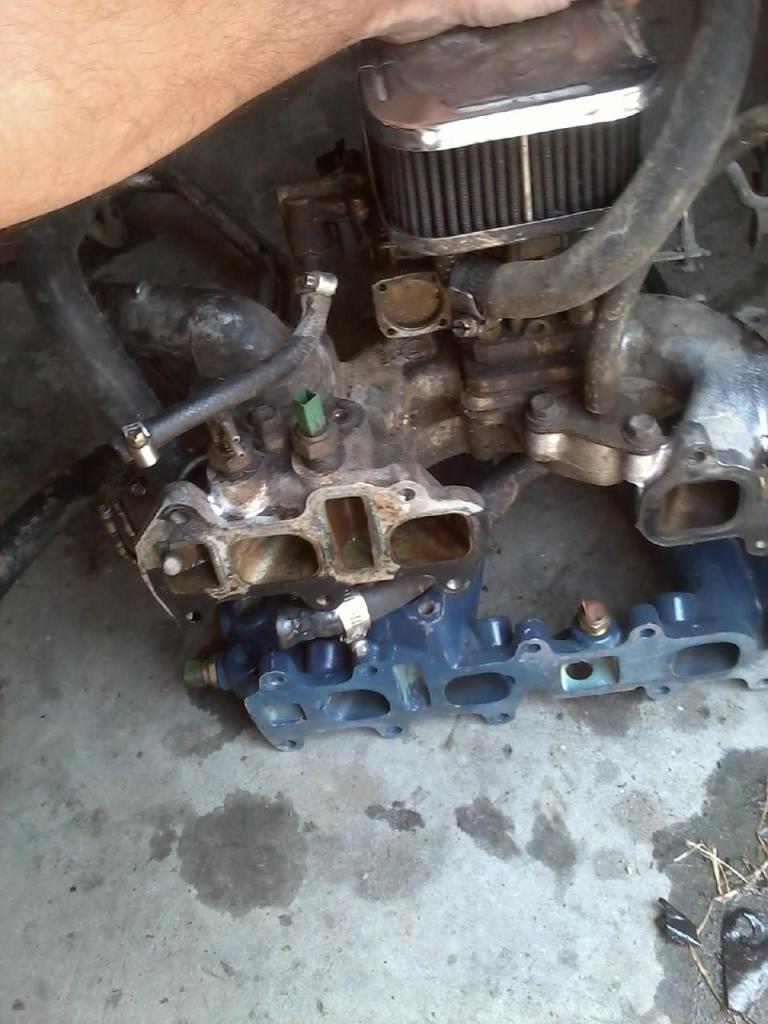

Here is a intake manifold that I used for my 86 Runner and something wasnt right on it and had to use another. The first stud up by the fuel pump lines up but nearly all of the rest dont as you get furhter to the back of the motor.

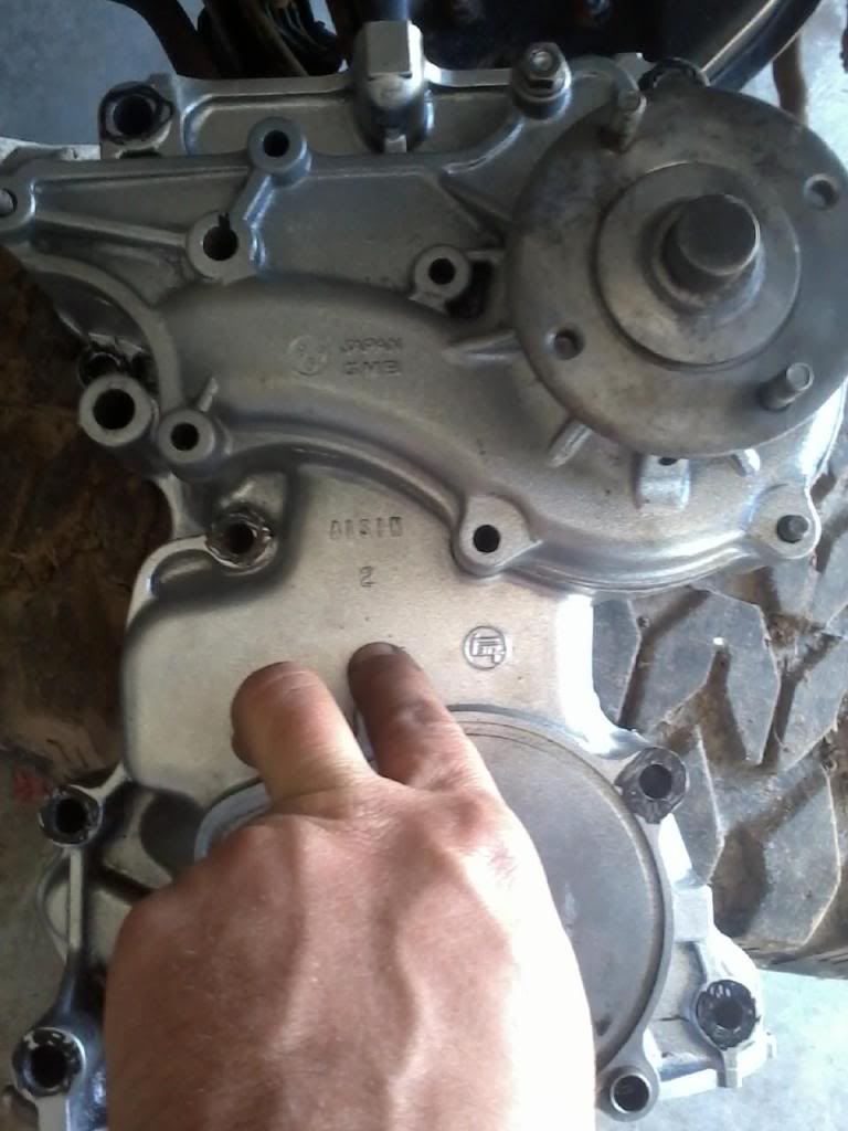

I got my Timing Chain on and had to replace the Timing Cover due to it being worn. I tried to use a early model 22r and they wont interchange. Thought I would put some info up to help others identify what they may have.
84 and older. 22r has no dimples/circles and the number "2" on it. Twistedyota got it right on the height thing, see the last picture for a good example. I also tried to mark which bolt holes for removing the timing cover on down the road when I have to do a chain again. Hope it wont burn off but it if does I tried to come up with an easier way. Never can remember which bolts they are.

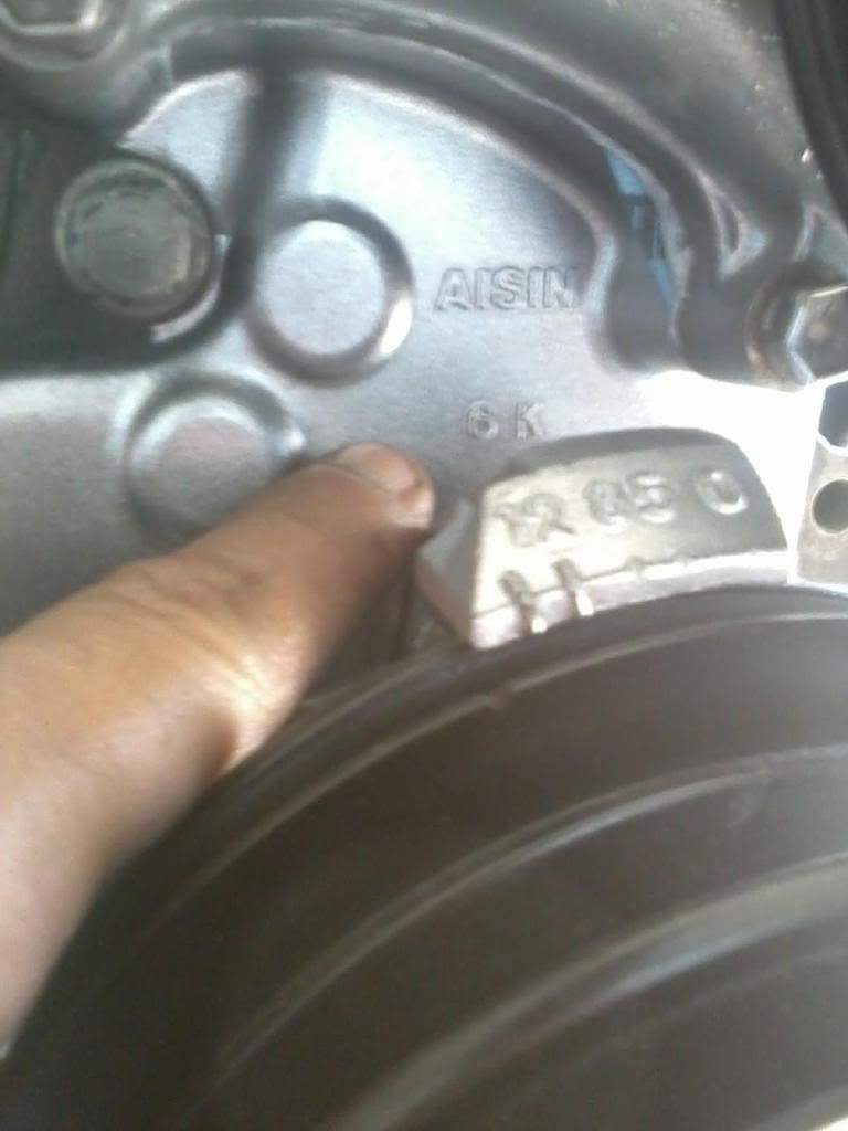

22re has "6k" and dimples/circles. 85 and up.

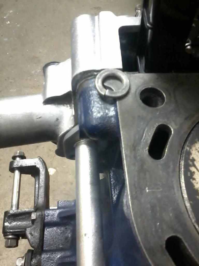

Here is what I am talking about on the 1/8th inch height. I used a lockwasher to help show how much of a difference. This cover is 22r. Seems like the oil pump bolts were to short. Hope this will save some one some trouble. It is an early model 22r timing cover on a newer 22re block.
