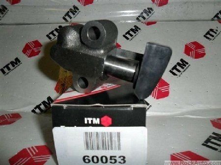

I also use a strong light source to have a look down into the timing cover, to see the guides & tensioner. The tensioner is located on the passenger side below the chain guide; it can be a little hard to see, but you should be able to see enough of it for this..
It is operated by am internal spring and oil pressure, and as the chain stretches over time from use and wear, it will continue to extend out further, taking up any chain slack.
But even with the engine not running (no oil pressure) the tensioner can give you an indication on whether the timing chain is stretched or not, thanks to the spring inside it.
On a brand new timing chain, you should see about 1'4" or so of the tensioner shaft extended, between the tensioner body and the black "rub pad" on the end of the shaft. If the tensioner is near or fully extended and you have slack in the chain, the chain needs replacing.
Here is a pic of a new tensioner, in the fully extended position, for reference:
20R, 22R, 22RE Timing Chain Tensioner, in fully extended position.
I do not recall the exact measurement on a fully extended tensioner & I don't have one on hand to measure, but it should be around an inch or so.
