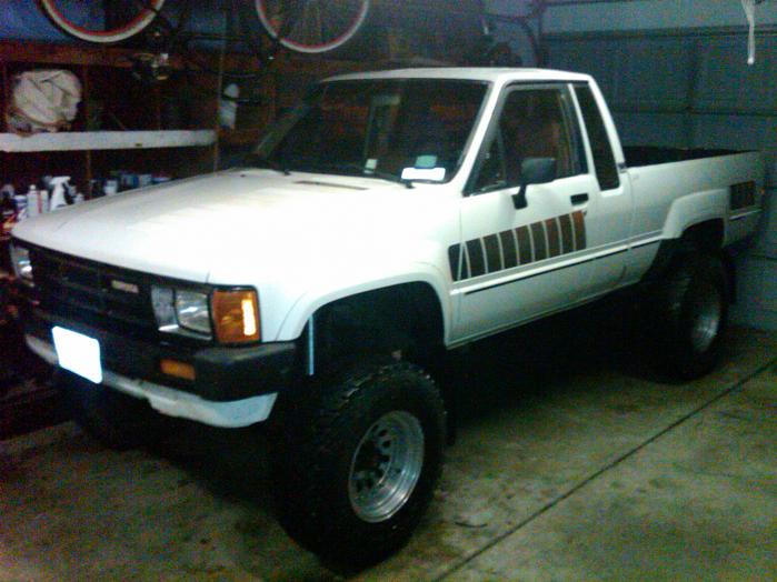

Just finished installing new bushings, 5" greasable shackles , long travel bilsteins 10" rear and 12" front. I still have stock steering setup and a total of about 4" of lift right now. The problem I am having is that there is a vibration at the beginning of acceleration that goes away once momentum occurs. My truck is an 85 ext. cab 4x4, 22re, stock gearing, 31" tires (may change to 33" tires and 4.88 gearing). I am in the process of setting up for distance Australian type off-road trips (Moab). Long story short I am having trouble locating this vibration. I will be fabricating a new torque bar up front, and traction bar in the rear. The u-bolts don't move at all, and I checked the rear pinion seems good to me. I might add that the rear drive shaft is not perfectly in line with the transfer case but don't have anything to reference if this is correct or not. My truck did this before I added the latest parts I forgot to mention. Any suggestions will be greatly appreciated.
