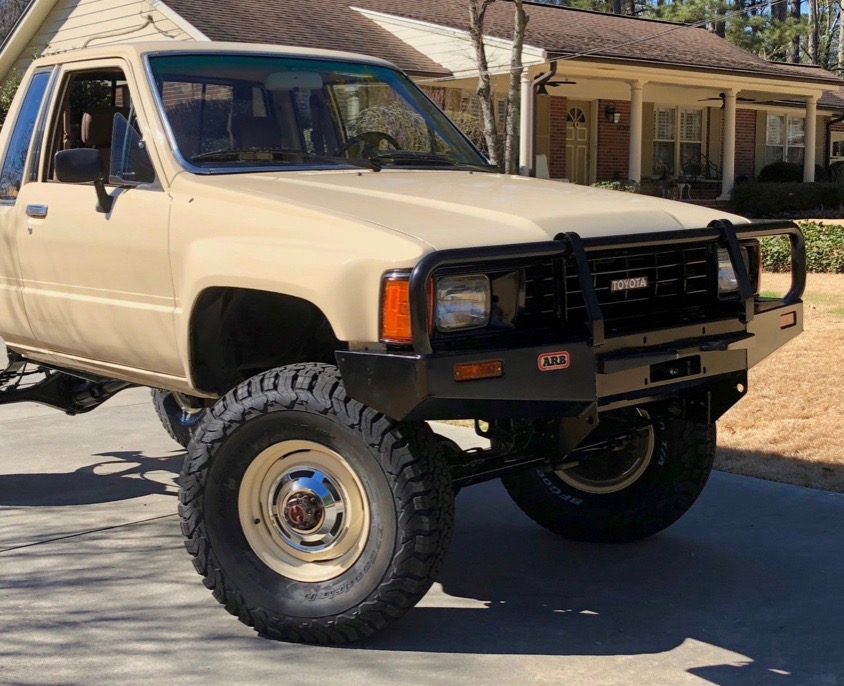

I ended up going with O.E. FJ40 steel wheels (powder coated to match the body) and hub caps.
