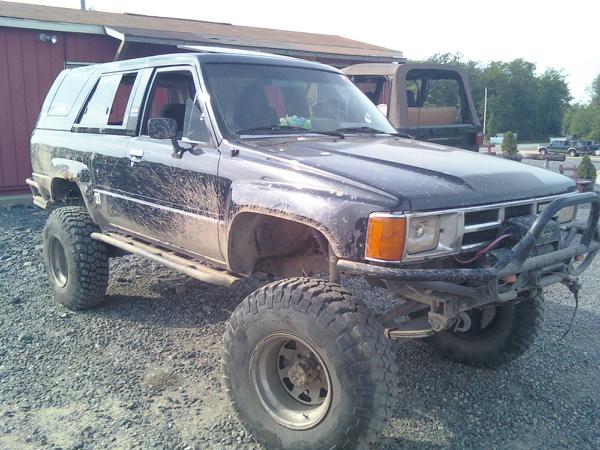

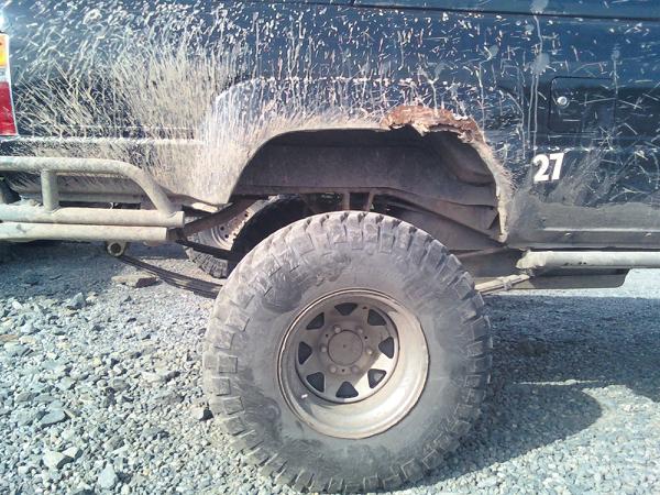

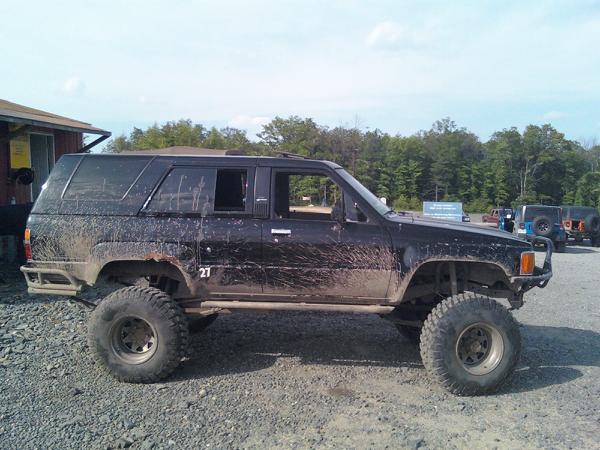

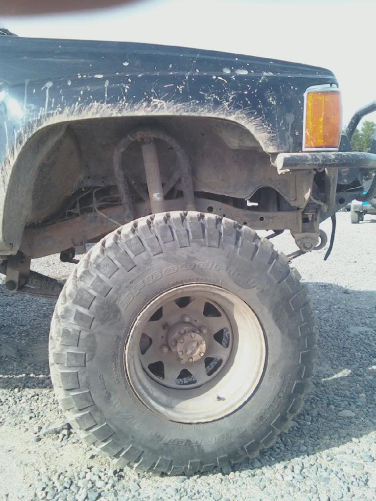

Got everything installed and tested it all out at Rausch Creek over the weekend. I really like the new setup. The flex was amazing and the truck seemed much more stable on and offroad without the worn out old springs. Here are some pics as promised...

As you can see, the stance is a little longer now with the front axle going forward a couple inches. Please ignore the cancer... I'm getting replacement panels for the rear fenders and rocker panels as soon as I can, but it was more important to get the truck functional than pretty.

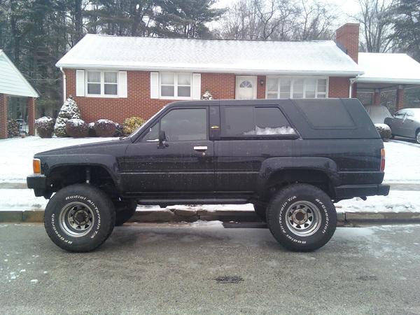

Here's a pic of the old ride height for comparison...
