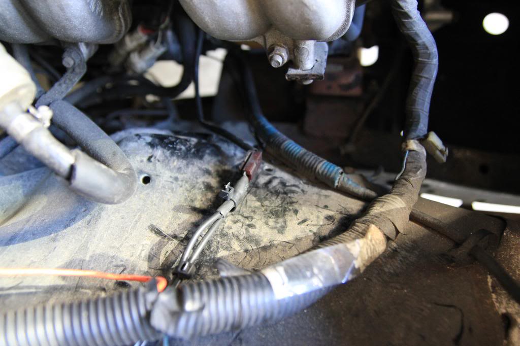

Wire 1: This wire connects to pin "86" on your relay using a female connector. The other end connects to the "ignition side of the starter wire". Meaning, when you disconnect the little brown plug from the starter; Wire 1 connects directly to the plug using a male connector.

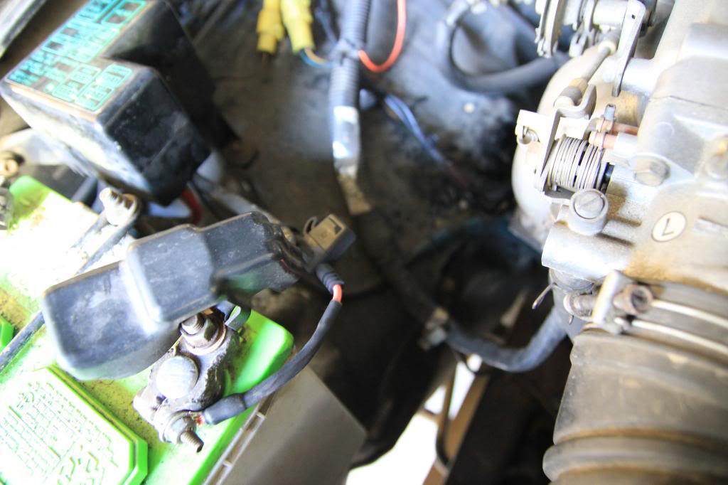

Wire 3: This wire connects to pin "87". This is your 12V power source (directly from battery). It is recommended that you wire in, an in-line fuse (30AMP). I wired in a mini 30AMP fuse holder, close to battery for easy access if need-be. I then connected it to the battery(+) using a spade connector.
Wire 4: This wire connects to pin "30". Once you have unplugged the brown connector on the starter (for Wire 1); you will then connect this wire to the starter using a male connector.
So now for some pictures. Here is what "Wire 1" looks like. The other wire running along side it is "Wire 4":

This is how "Wire 3" is connected to the battery with its in-line, 30AMP fuse holder:
