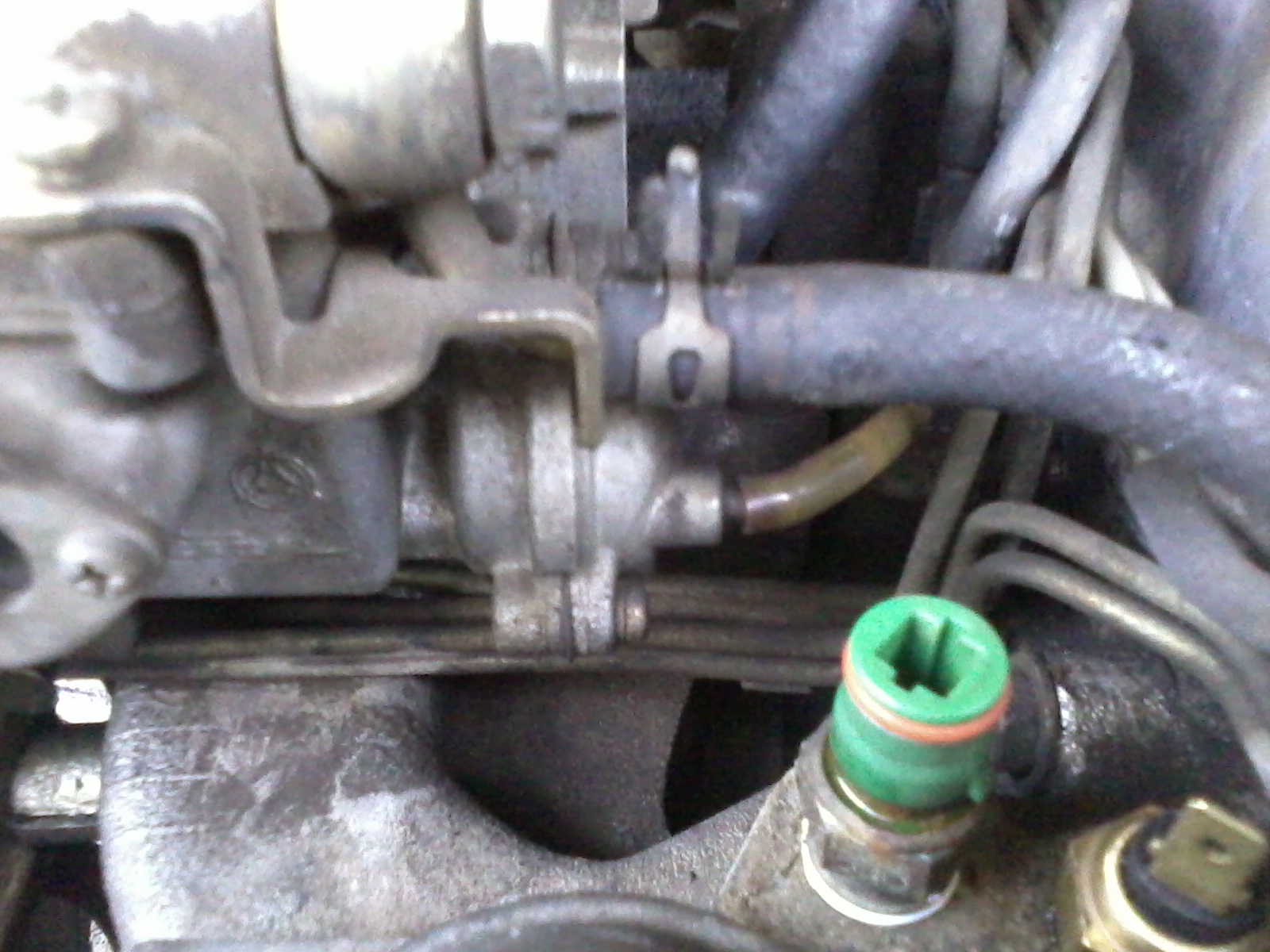

Yea Yodaforce your right! I got a buddy digging me out one of his old webbers right now, he replaced it due to rough idle when all he had was a vacuum leak. So looks like this ol' boy lucked out on a webber...BTW Staceman1 this is a picture of my carb. The black fuel line coming off the pump is on top. Is the AAP the tan line underneath it?

Old Dec 21, 2012 | 05:19 AM
Staceman1's Avatar
Joined: Oct 2009
Posts: 134
From: NW Phoenix
Yep.
Just pull that little hose and plug it. It's just a vacuum line.
