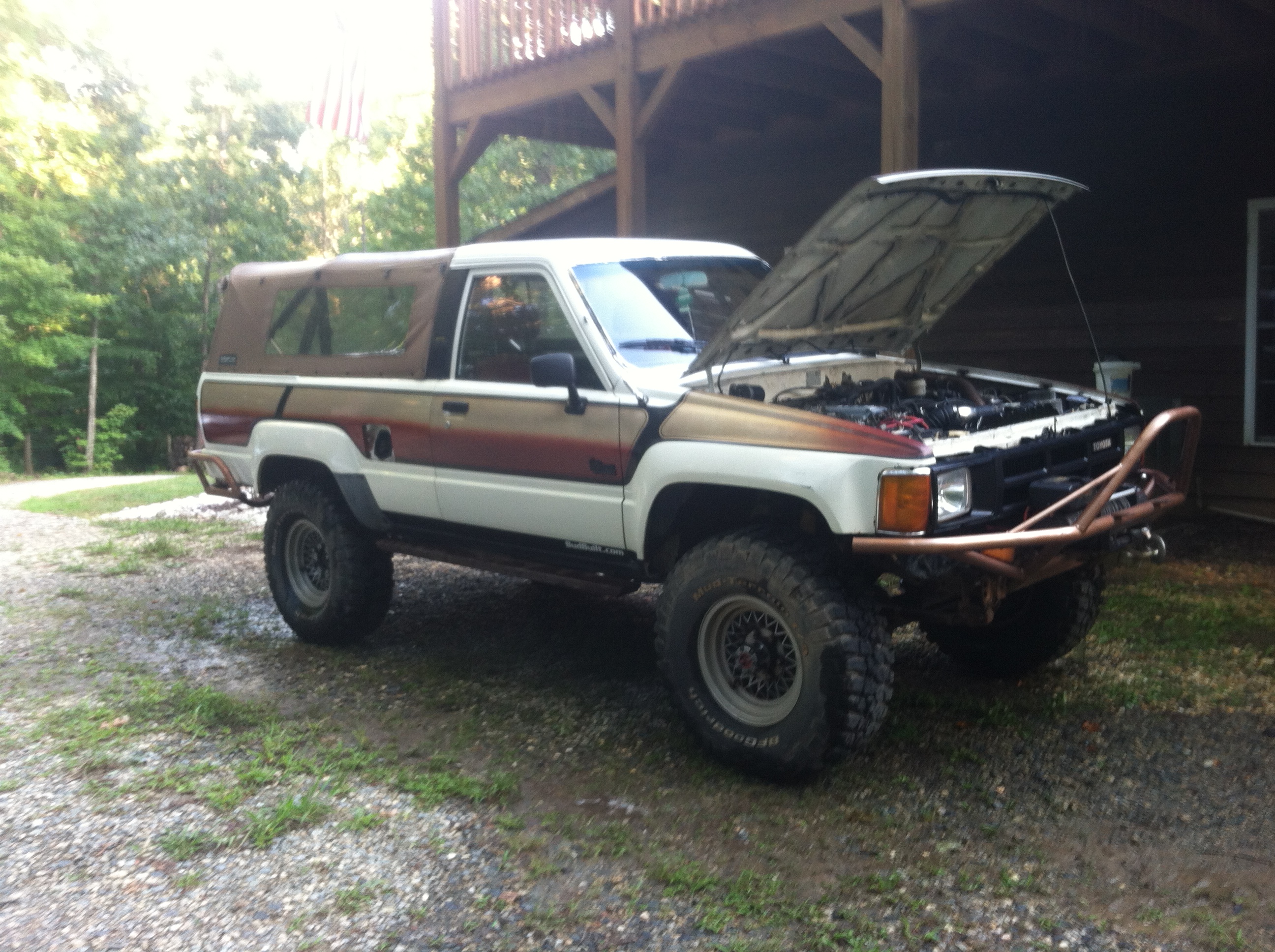

I'm still subscribed! The tiny pictures of the new engine look terrific. That's probably the builder I would get a new engine from when I need one. Did you have it delivered to a garage or to your house? How many miles have to put on the engine now?

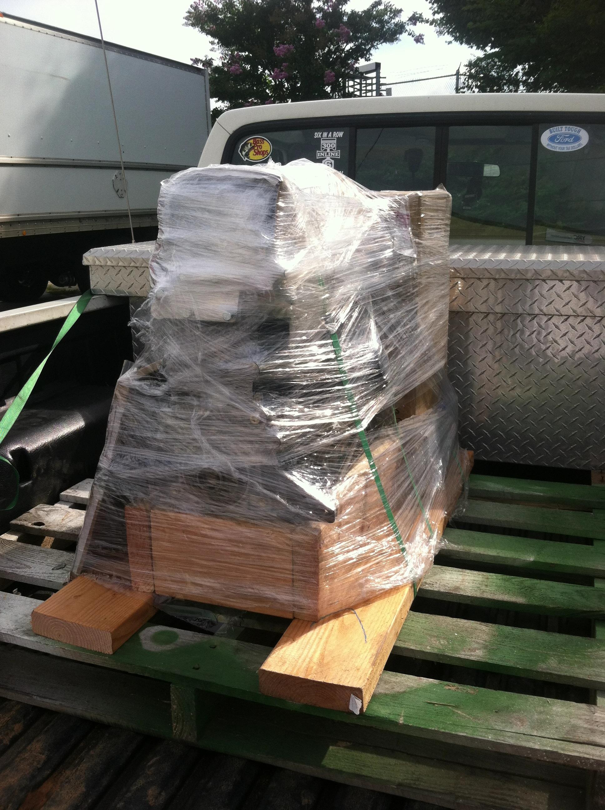

do the pics not get big when you click on em? it does for me. and i had it delivered to a shipping dock and got a buddy who lived nearby to pick it up in his f150. miles on the motor are close to 50. haha. more pics are coming!

a couple pics
Attached Thumbnails Reviving a tired 85 4runner-engine-truck-bed.jpg   Reviving a tired 85 4runner-photo-15-.jpg

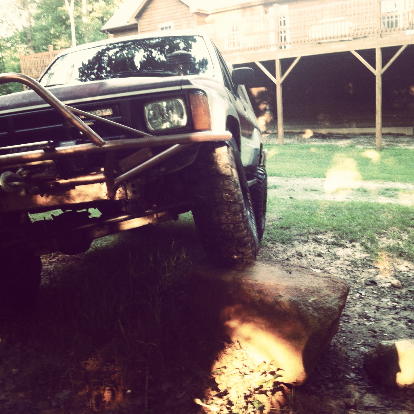

Ehr meh gerd! Lerk at url that flerx!

^^^ I think that's flexin' almost as much as my IFS does, lol! J/K there is the potential for good flex there, just need the right springs.
If you want to save a few bucks and are planning to relocate your spring hangers anyways you could throw some chevy springs in the rear. It'll give you a few inches lift and they ride and flex pretty good.
The new motor looks sweet! Sounds like a freakin' work horse too being able to go up a hill in 5th with 4.10's pushing 32's. Might have to look in to those guys if my motor ever dies.

Lol. Yeah potential is def there. But I've thought of Chevy springs. I hear the departure angle sucks when you use em though.
