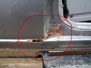

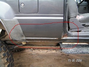

Thanks for replies so far . These are the panels I need to repair/replace :
Attached Thumbnails repair panels-yota-repair-1.jpg   repair panels-yota-repair-2.jpg

ahhh ... ok you want http://www.toyotafiberglass.com/t4r31.jpg
but you realize , this will not fix all your rust I see there in the pic ? you will still have to make some panels on your own to weld in ...

OK , thanks again for your help . I can fab up the rear bits fine , its where it goes inside the door shut I need some difficult shaping I thought the repair panels might cover .
May make some templates up and heat some steel plate and beat it to shape .
