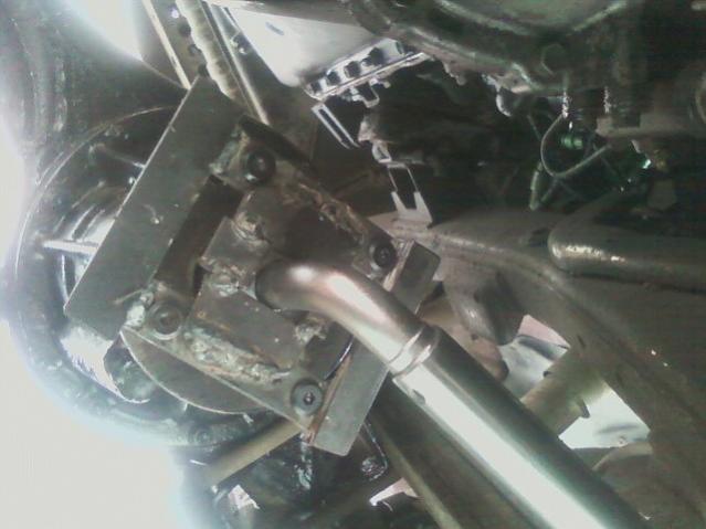

Here is something I made up. Took a while, but had to get he measurements right for it to actually be effective. Should be obvious as to what it does. Don't harp on the welding. haha.
I put the bracket thing on there, then put a breaker bar on the socket and rested it between the frame and the leaf spring. After that I started the truck, put her in reverse, slowly gave it some gas, then some more, and finally it popped. Sounded like my gears blew up when it came loose, wasn't quite sure what to expect when I went to look and see what happened. It simply came loose and everything else was normal and good to go. Thanks for the help everyone.
I had to make this thing because I didn't want the socket to try and come off while there was weird torque on it from putting it in reverse. This way it was certain to not ruin the nut, or at least a lot more certain. lol

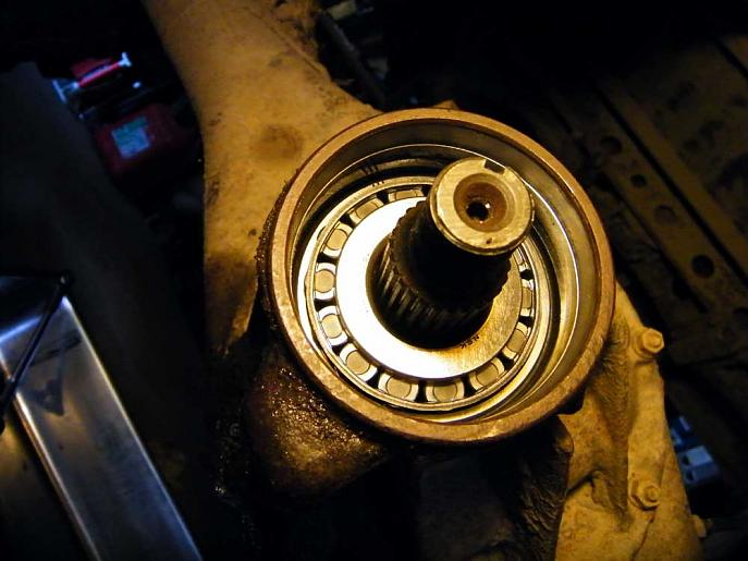

Well, I used an impact to get the nut off, changed the seal and put the nut back on where it was.
I didn't "re-do" the gears or anything, if there's a problem, I'm hoping with as much as I drive this thing (not much) that it will be years before I see a problem.
The seal must work well, this bearing as about 5 years worth of wheeling in mud\water and it looks clean clean clean.
