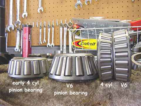

The 4-cyl gears and locker you got are somewhat different than the V6 3rd member. I think folks have installed 4-cyl gears/lockers in a 6-cyl diff:
- http://www.gearinstalls.com/cus.htm

Wow after checkin that site there Mr. Brown, its not so much the brakes i want the V6 for, its those bearings. Wow, quite the differance. Thanks again 4Crawler. What about the 5 speed out of the donor any insight on that? worth the trouble? Peterson has an article this month on the R150F is this the same tranny as the one in this donor? they did not specify years just said v6 runners. I am not going to be out of control rough with this rig just lots of early and late season camping trips so relibility is what im lookin for here.
