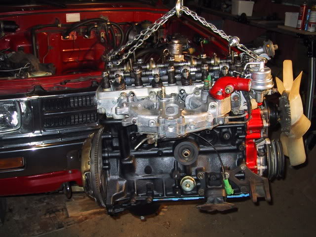

One problem with that is that I dont have the stock spacer anymore. Also, the stock spacer has two holes (one for each barrel). I am currently using the two aluminum adapters that came with the Weber carb (these have an oval opening), and to match the adapters I machined the intake manifold into an oval as well by connecting the two holes.
I figured that this would allow the bigger weber carb to breathe a bit easier by having less restriction. A new spacer could be made to either fit the stock two hole design (like the LCE adapter) or opened up to fit an opened manifold like in the picture above.
