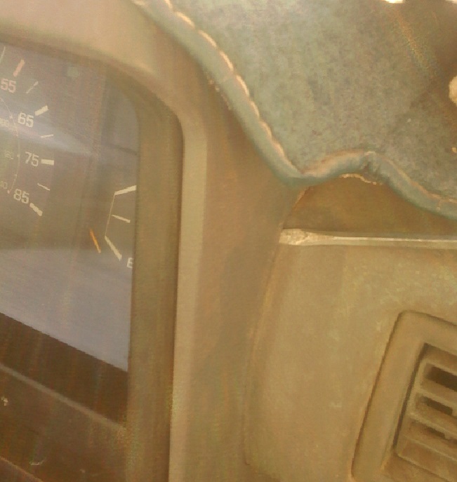

Here's a pic (crappy phone) with a small screwdriver in the gap I'm referring to.
If I can do the job by only taking out the passenger side of the dash that would be great.
I'm kinda guessing that what is see is the gap between the dash padding and the gauge outer trim.
So now I'm wondering, if the dash pad is all one piece across the truck, would it be a problem if I slice the dash at some point and only remove the passenger half.

If you are wanting to remove the dash pad, you will need to remove the bezel as it covers a 10mm nut in the upper left of the pad. If you are wanting to clean the Evaporator then you do not need to remove the dash pad.
The bezel just has 2 screw at an angle above the clear lens, two at the bottom of the bezel and on that you will have to open the door to get access to if I recall correctly, I may have missed a nut or screw off the top of my head. I would not cut the dash pad, you wont gain anything by that as it is along metal base that is covered in plastic/foam.
