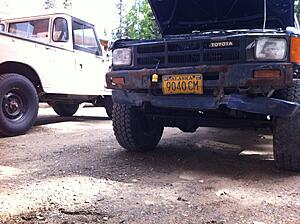

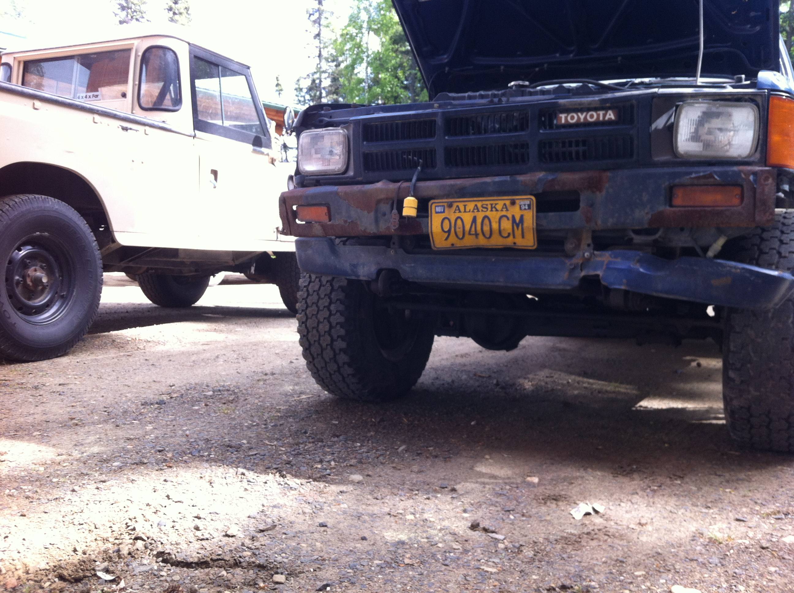

I saw a yota on Craigslist, but by the time I called the owner, he had already sold it to another person. He said that I might still be able to get the truck though, as the new owner was only interested in the front axle for a SAS project. I couldn't let a truck like this get torn to pieces, so I asked for the new owner's number and offered him a bit more than he paid for it. I suggested that he look for an axle at a junkyard instead, and he agreed to sell it.
The engine threw a rod threw the block, but I already sourced another running (I hope) 1984 engine for $250. The body is kinda rough, but it came with a topper as well, and I'm probably going to brush up the rust spots and hit them with Zero Rust for the time being.
My goal is to get it running well enough to make the trek down the Alaskan Highway to Tacoma. I'm going into my senior year of college, and I am going to need a vehicle to transport all of my stuff to graduate school. If I don't get it running, I'll have to convince my mom to keep it around while I'm in college, but even if I have to sell it, I'll have saved a truck from the scrap yard, and that makes me happy. Plus, I might even make enough money to fund my new homebrew system.

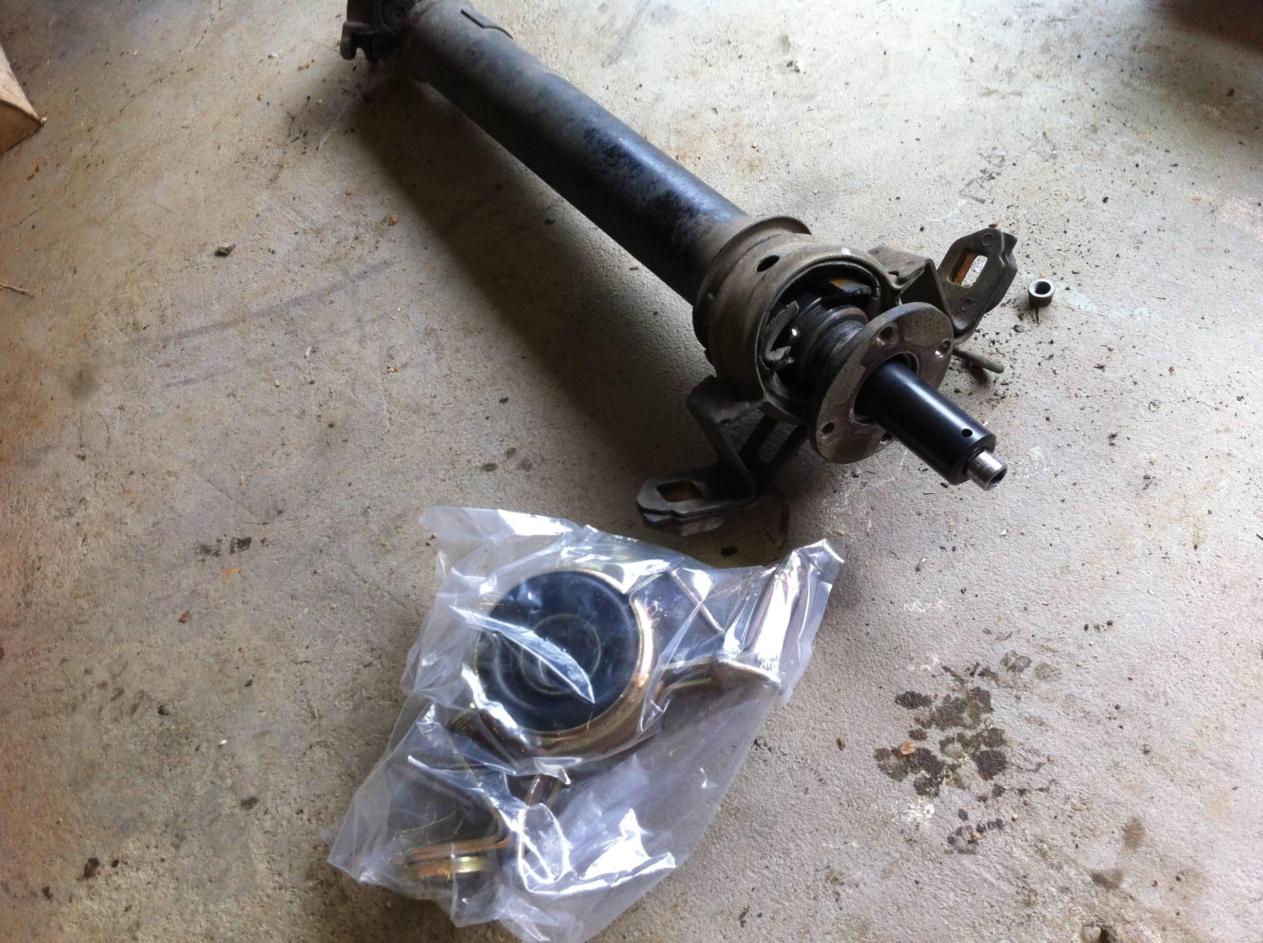

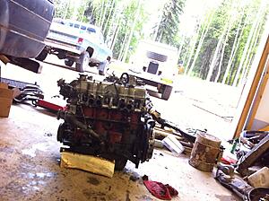

I'll start with the happy pictures. My $250 engine came with a bunch of free parts.

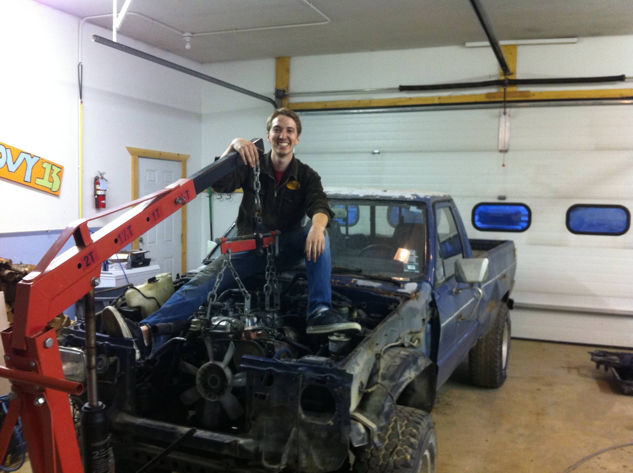

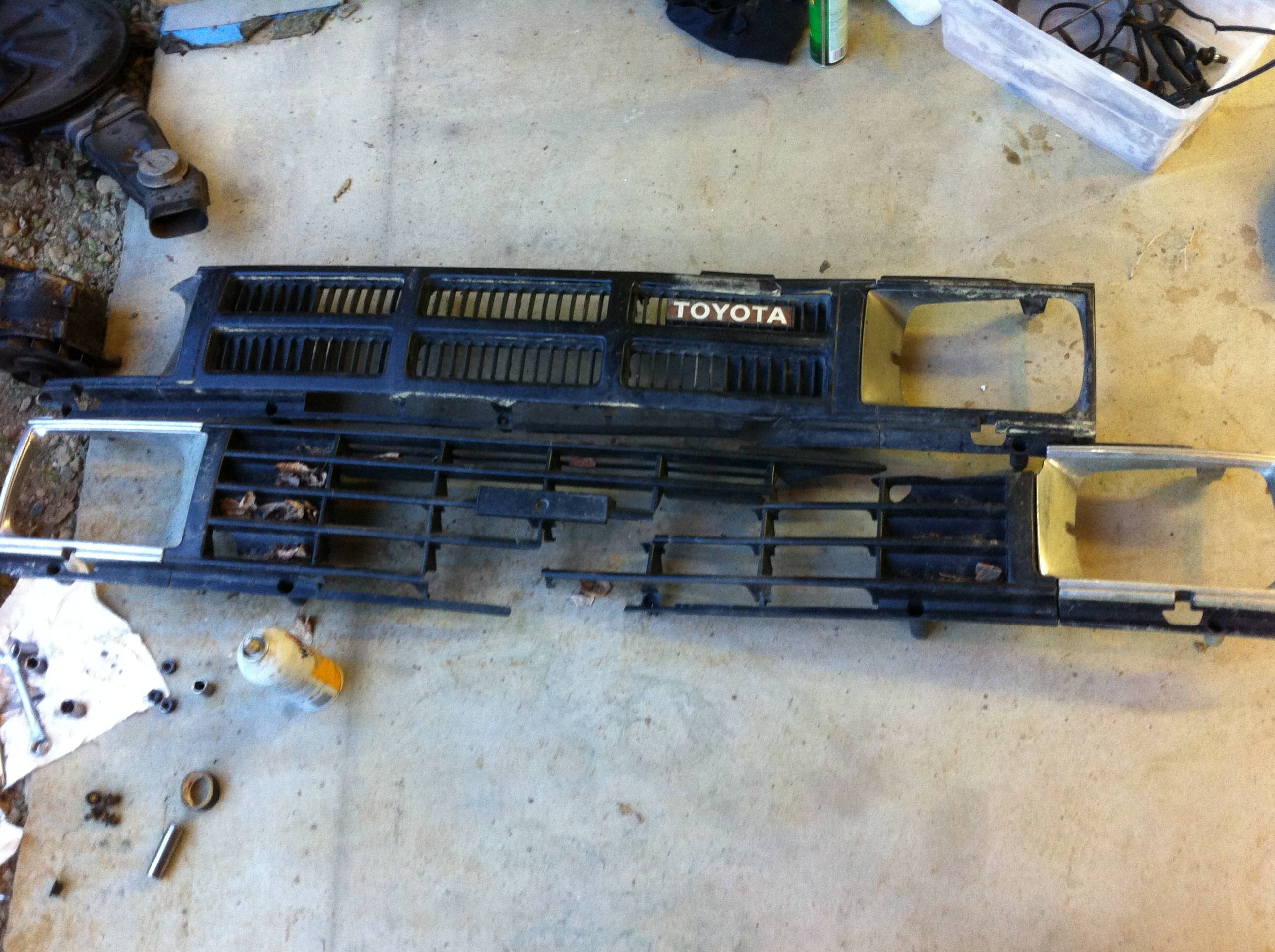

So... This is the part that you all are probably going to hate. Hope it's not a ban worthy offense :p.

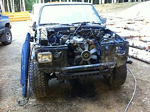

I cut my perfectly decent radiator core support out with a sawzall.
Why? I dunno, it was late and I decided it sounded like a good idea.

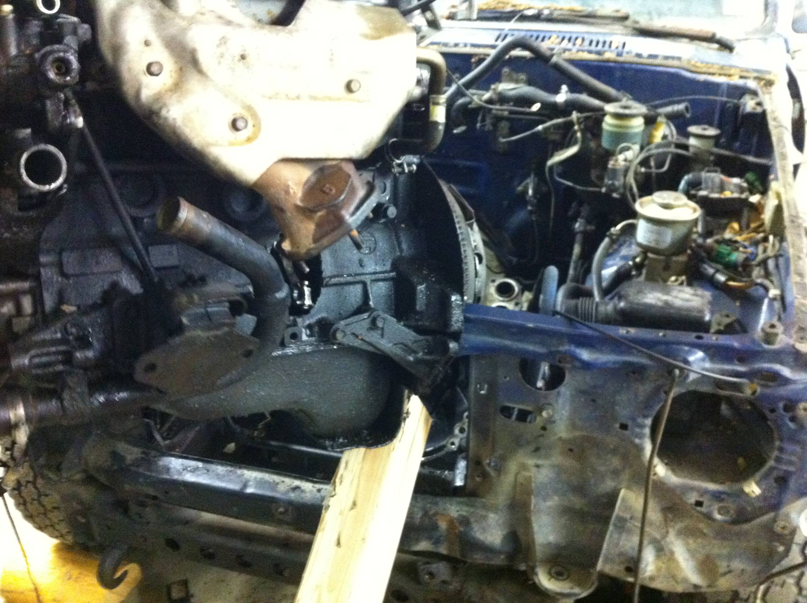

Just kidding, it was more cold and calculated than that. I absolutely hate that radiator support, and without it in, the engine slides out super easily. I know it holds my hood latch, but I like the hood mounted latches that my land rover has, and I'm either going to rob a jeep for a pair, or going to install a pin system. I know I'll be pulling the engine again in the future, and this makes it easy to do.

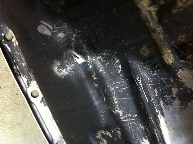

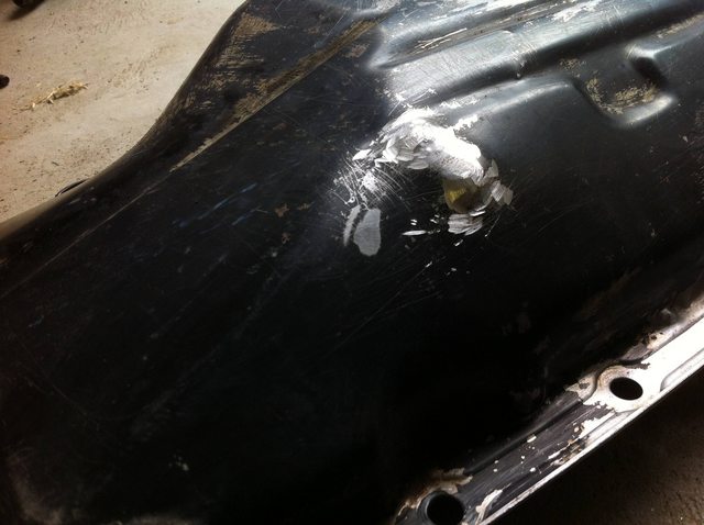

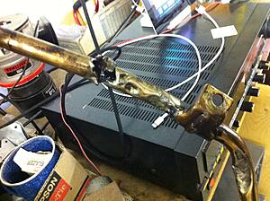

Going to attack this with some epoxy and a plastic welder, see if I cant make something sort of decent looking.

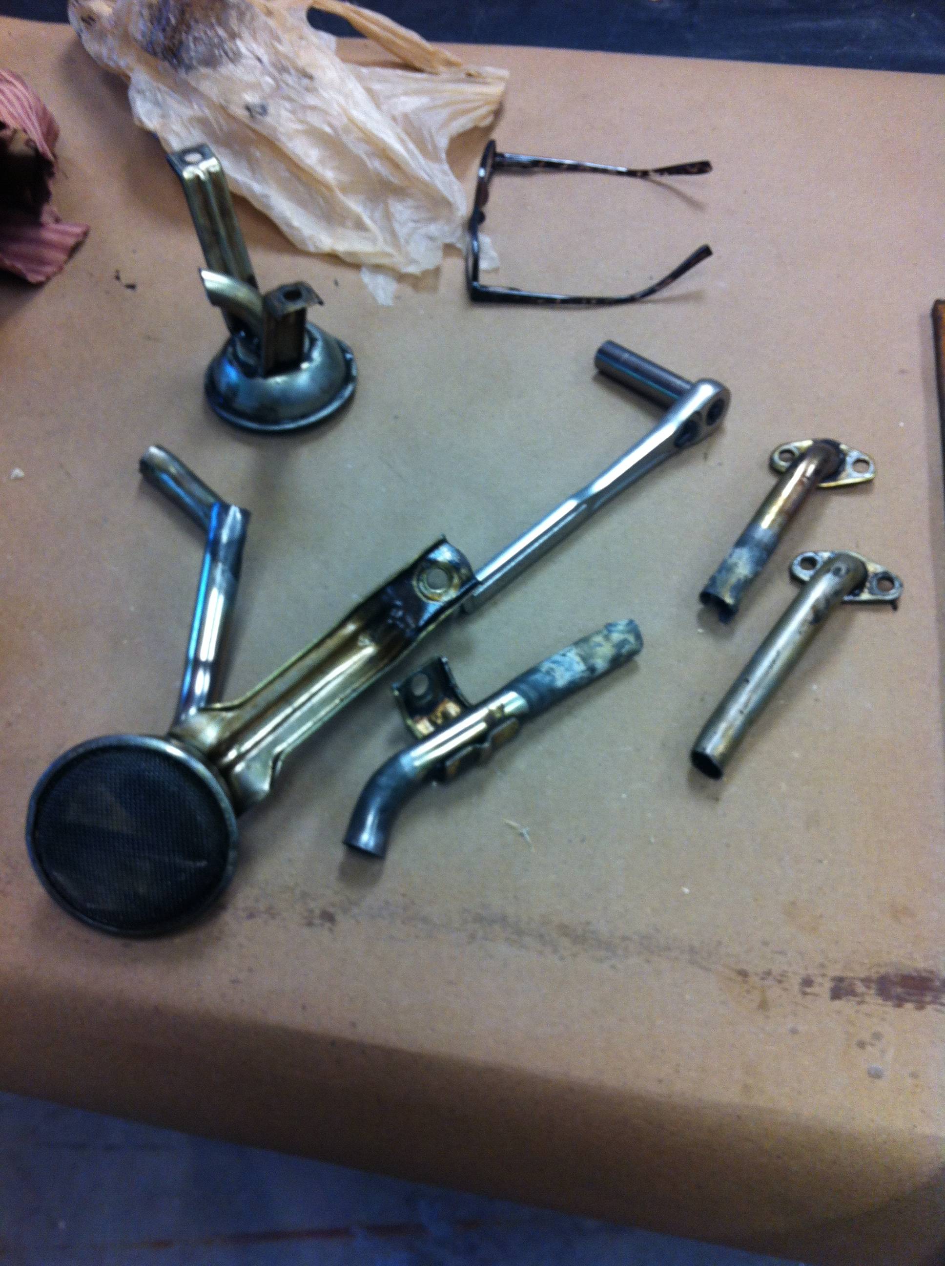

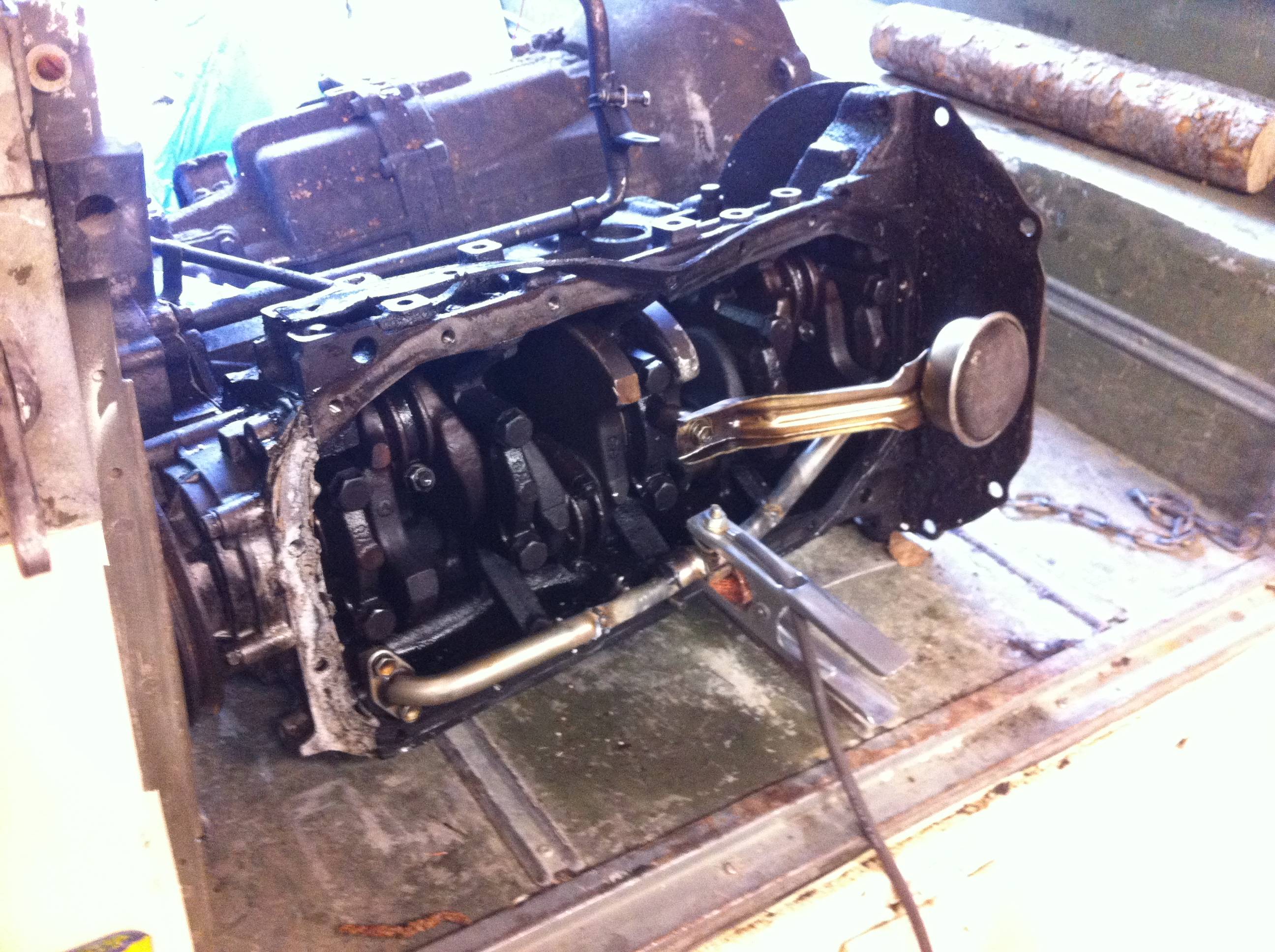

I was planning on using the pan and pickup tube from the 4x4 engine, because my 2wd engine didn't clear the axle, but... I guess that rod did more than punch the block.

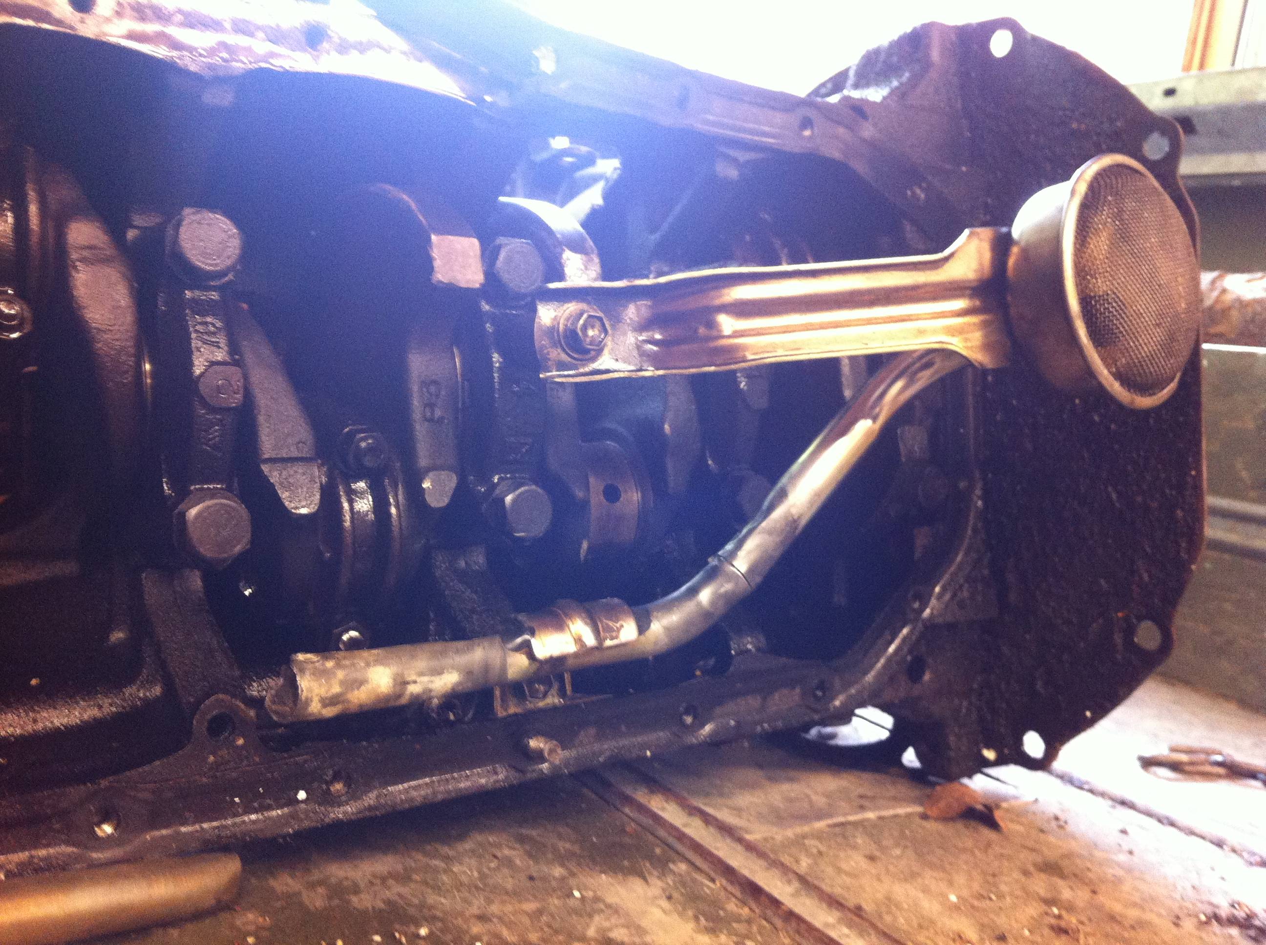

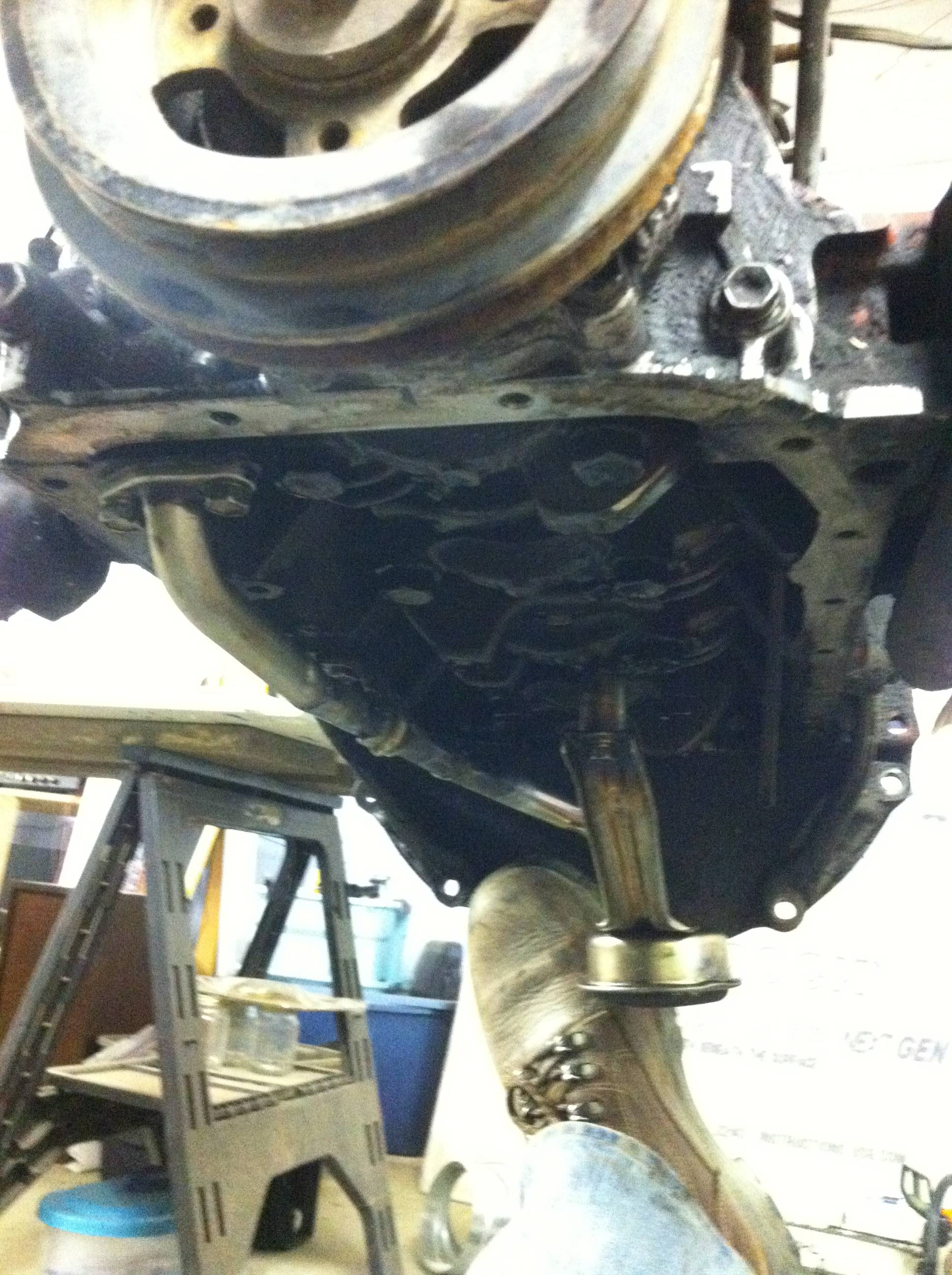

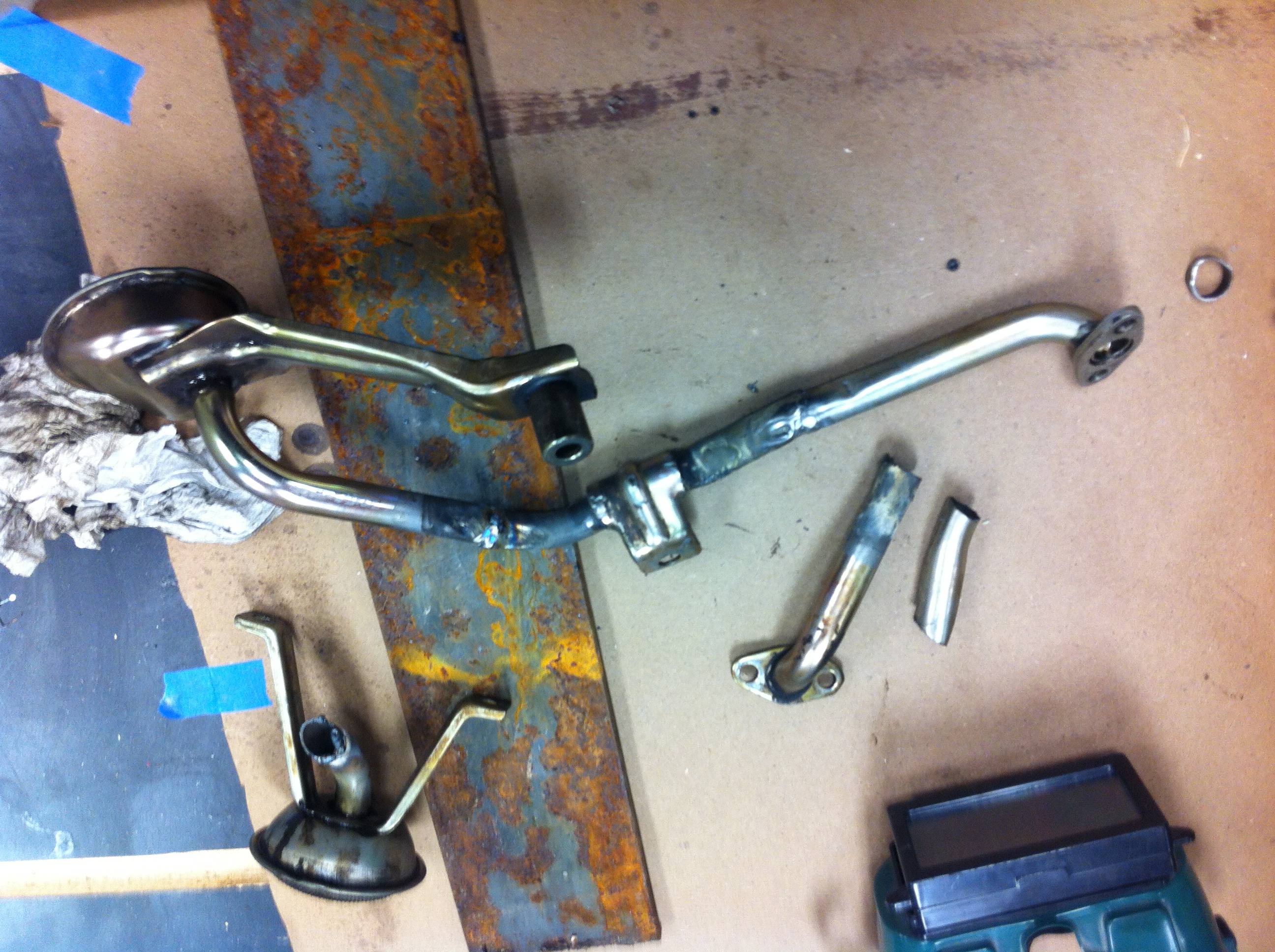

Decided to try and fix the bent tube using the 2wd one and the blown block as a welding support.
I hope it works! Seemed to be leak free and had good flow.

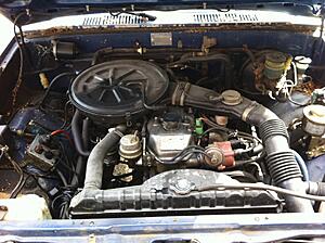

Alright! I'm home and working on the truck. Pulled the intake and am installing the LCE Block off plates and doing a complete desmog.
Still thinking about buying a weber. It would make my life a lot easier.
I have until the 25th of August to have it running. The countdown begins.

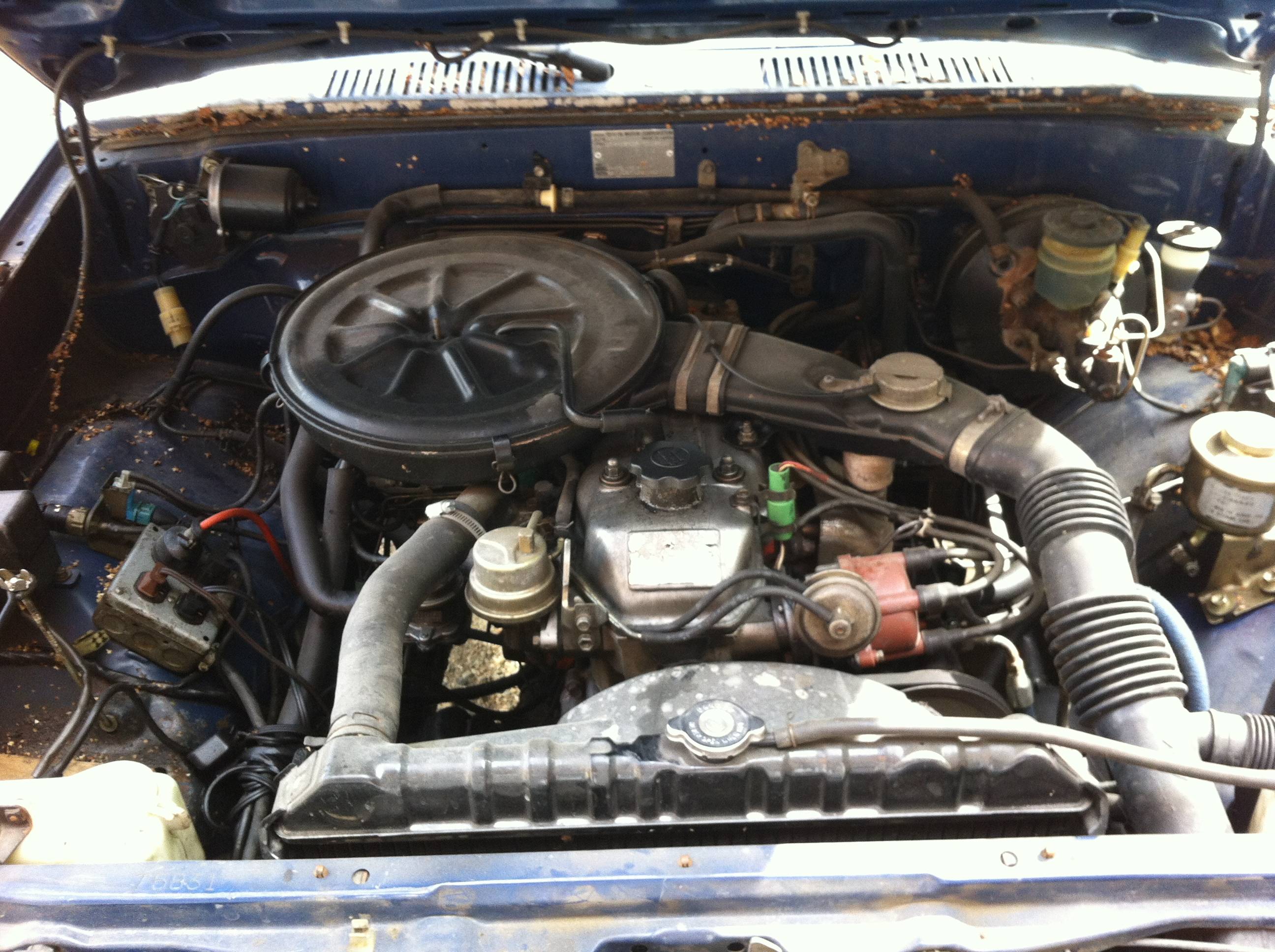

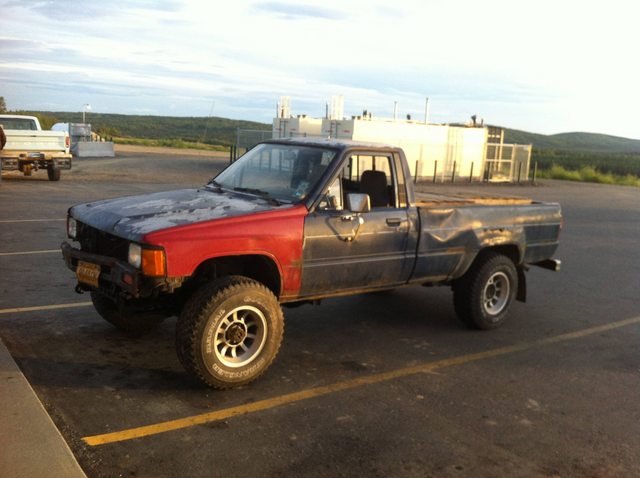

The truck is started. I have the Asian carb fully desmogged, and as far as I can tell it is running great. I made my own vacuum caps with 1" bits of old tubing and RTV silicon, but I'll be upgrading to real caps in a bit. I set the timing and idle speed, and it runs fabulously.

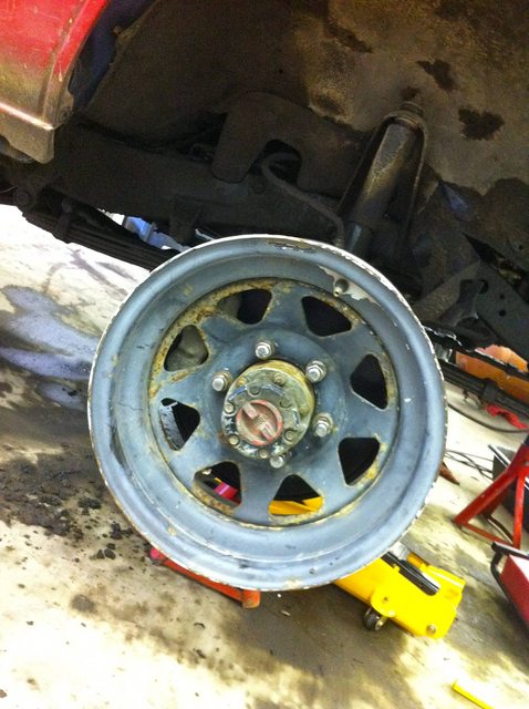

Now I'm running into different issues. The PO put some mag rims on that don't fit very well, they were actually rubbing the wheel weights against the tie rod ends. I bought some small spacers to fix that problem, but I'm still searching for a 15x8 rim with under 3.75" backspacing. I'd like to run a 265/75/15 tire, ideally a Toyo Open Country AT II, which is what I've got on my Land Rover in 16's, and I don't think they will fit on a 15x6 rim.
I get really bad wobble if I go 35 mph, which is probably because my wheels are out of balance and are really worn down. I'm hoping that the wobble will go away with new rims and tires, because I don't want to spend a lot of time messing with steering and bearings.
Well.. Good news is that I don't need to spend 300 bucks on a Weber kit. If you're doing a desmog, try your ASIAN first.
Some pics:
Welding an oil pan crack:
Test drive to buy beer:

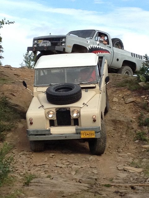

Also did a 60 mile trail ride in the Land Rover on Sunday. It was pretty awesome. Didn't miss a beat.

Well, I found rims that fit. They are ugly as sin, but with some black paint they should look much better. I like that they have easy lug nut access. Much better than the mag rims. Good tie rod clearance as well. They are 15x7, so I can fit a decent sized AT tire.
