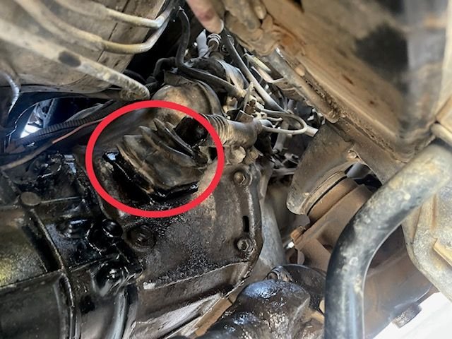

Thanks for the information! I haven't begun work on it yet. Upon further inspection it needs a full tune up and other things so I ordered new spark plug wires, spark plugs. I need to get some hoses (just need to identify the ones on top of the valve cover) and a few other other parts. I found a pretty good video on YT showing a front main seal leak repair that tackles my oil pump issue. He goes over the two methods you mentioned about removing the crank pulley. The starter bump seems like the way to go..
I have a question about that fork dust boot (circled red in the above posted image)...How does the boot attach to the bell housing? I thought it would slip over a lip or something on the square opening, but it's just a hole. Do I just stuff that boot in the hole? That doesn't really make sense though...Thanks again for all your help...New to the Toyota world, and I definitely want to be mechanically proficient on this thing so i appreciate the knowledge.

Yes, the rubber peice on the bell housing has a ridge around the bottom (the big end) that just seats down in the square hole. Easy to install.

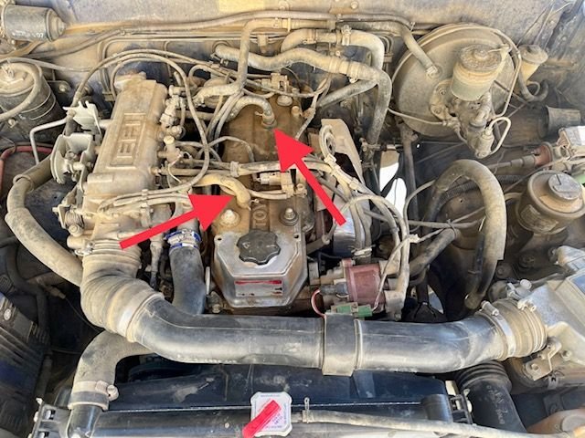

Sorry for the delay in the update! Had a baby last week so she's been ruling my life..Finally have some time to handle some business.
Heres a pic of the engine bay..I just need to identify these two hoses so I can complete my parts order. I really need to get this thing up and running again. I have a valve cover gasket set. The engine is dirty because my radiator was kicking coolant out and dispersing it all over the place..Changed that a while back.

Those are the two hoses for the PCV system. Positive Crankcase Ventilation. The PCV valve is between the hose and valve cover in the rear. Be careful removing the PCV valve from the valve cover. The grommet that seals it to the valve cover get's brittle, and can disintegrate easily. It's best to remove the hose from the Throttle Body, and then remove the valve cover before you remove the PCV valve. That way, the bits and chunks don't fall down into the valve train.
It's a good opportunity to test or replace the PCV valve, too. Do NOT replace the valve with a auto part store generic cheapie. Always go with OEM!
It's also a good opportunity to set the valve lash. The FSM has a very good, easy to do, write up on "how-to". It's a bit of maintenance that really should be done once a year, or every other year, at the least.
An easy way to keep the valve cove gasket in the groove in the valve cover while installing it back onto the engine is to put a little dab of thick, heavy duty grease in a few locations around the valve cover's circumference. The grease holds the gasket in place while setting it down onto the engine, but doesn't interfere with the fit of the gasket at all. It just squishes out of the way down the groove.

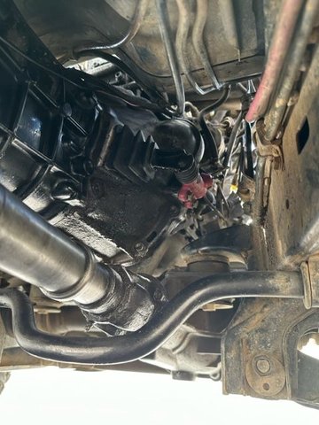

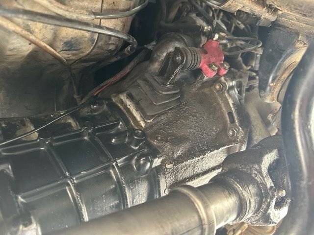

Here's a little update with pics...sorry for the long delay.
I have a leak somewhere and seeps through the fork dust boot cover. It doesn't look like it's oil. I hope it's not trans fluid. I had the transmission and clutch replaced last year.
