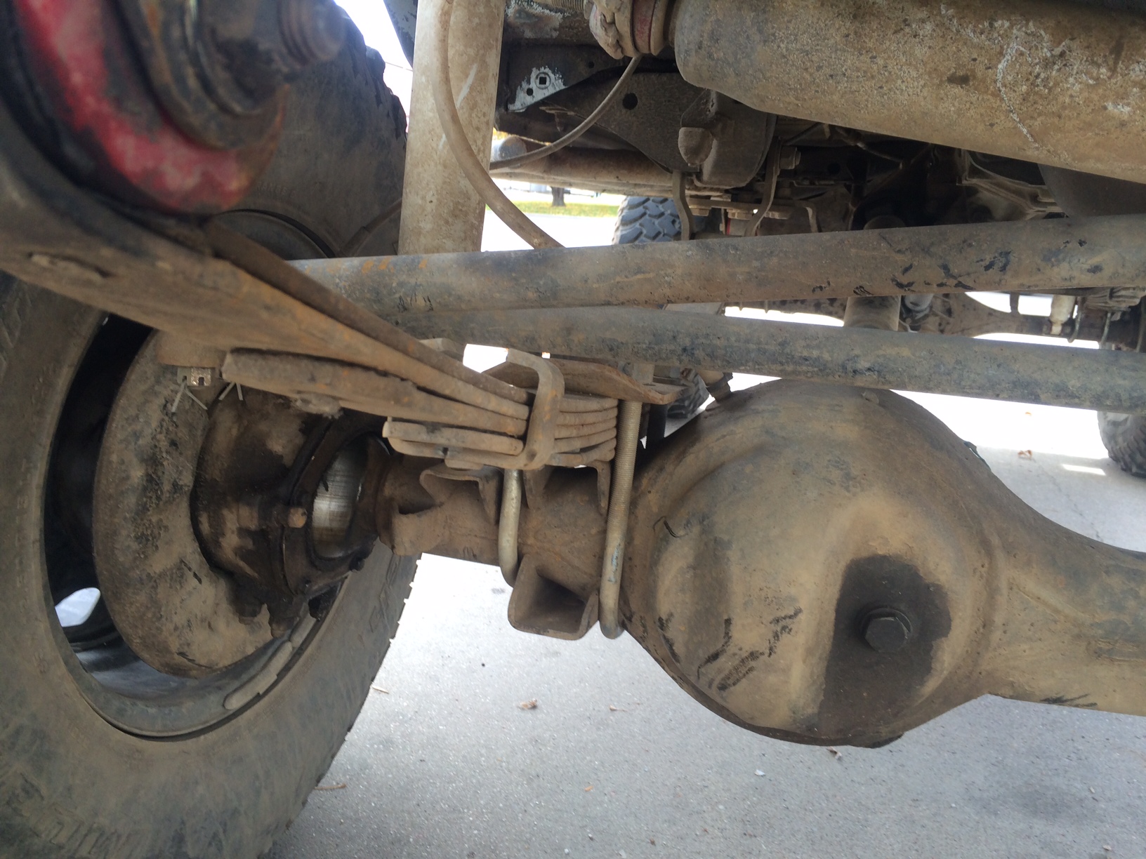

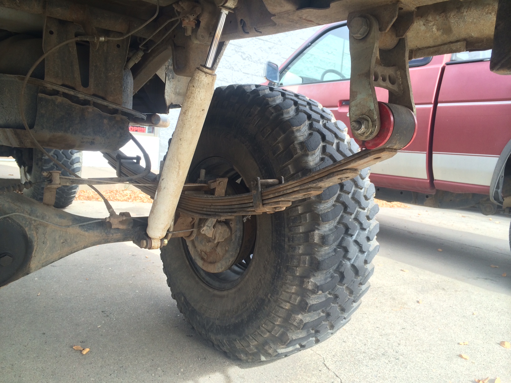

Here are pics, 8 leafs in the rear packs and 6 in the front.

Alcan said they never recommend removing leaves. Basically they will be too soft (they are already really soft) and the shackle angle and placement will be all wrong.
All well I guess 27" frame height with 35's at street pressure isn't toooooo crazy.
