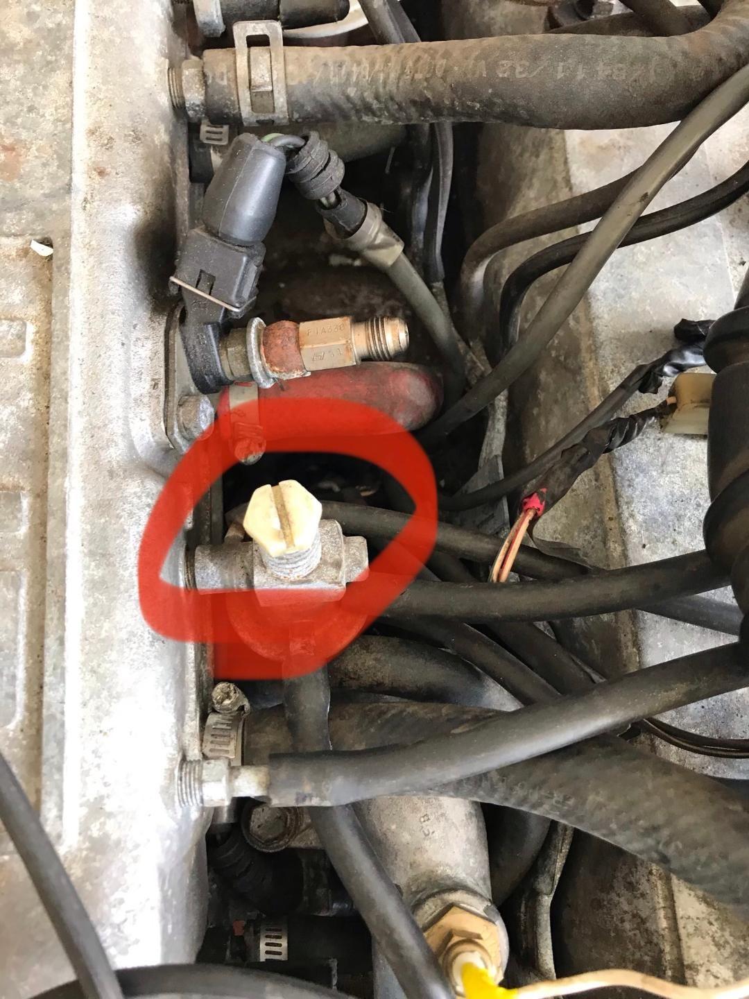

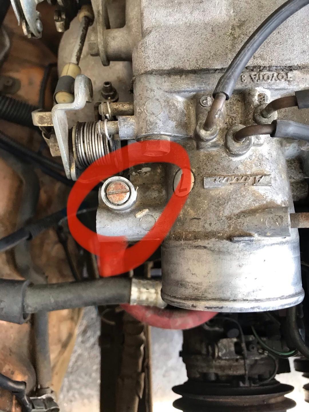

hey guys I'm new to the forums and I am looking for some help. I got an 85 4runner that I can't seem to get to hold idle/ start. the car will crank but not start and if it does start it idle real low/rough, it will start if I put starter fluid in it but will die as soon as I take it away. if I try to give it any gas while it idles it immediately dies. I'm getting fuel all the way up to the cold start injector. I've replaced the fuel filter, fuel pressure regulator,spark plugs + wires, pcv valve. I was messing with these two adjustment screws and that how I was able to get it to idle, but dies when I give it gas

Well, the first screw you showed is to cause the engine to idle up a certain amount, set by the screw, when you crank the wheels all the way to the end of their travel, to help around a tight corner. For now, II suggest setting it about 1/2 way out, and leaving it for now. You can come back and work with it later, but for now, it's not really relevant. Just be sure it's not out so far it allows air to leak in around it. Even all the way down until it bottoms out is acceptable.. For now.
The second screw you show is actually the cover to idle speed adjustment screw, which is located under the one you showed. If you tightened it down, it may have pushed on the idle speed adjust screw, causing the idle to drop, or it may have sealed the idle speed adjustment screw, stopping air leaking past it, thus causing a lean condition. That;s what you need to focus on. Take the cover off completely, and then count the turns needed to tighten the idle speed adjustment screw down till it bottoms out. Not super tight, just until it stops. Once you know how far out it was, how any turn from bottom it was, take it all the way out, and inspect the o-ring on it. At least it should have one. I wager it's either dried out, damaged, broken, or missing. I suggest replacing it on GP. You can find o-rings that fit all over the place. Very common item.
Once you have a new, properly sized o-ring, on it, put it back in, and screw it all the way down, then back it out until it's at A) the place it was before, or B) the idle reaches 800 RPM, whichever comes first. The correct idle IS 800, set with an external tachometer. You can get one cheap from Harbor Freight, or most auto parts stores. Good item to have. Use it after replacing almost any ignition part, or when setting the timing, again, after replacing almost any ignition part. Distributor cap/rotor, Wires, anything. A little bit of Vaseline on the o-ring will help it seal better, and last longer. Good idea to use it. Just a very little bit on the actual rubber of the o-ring is a good idea, as long as it's not in contact with gasoline.
