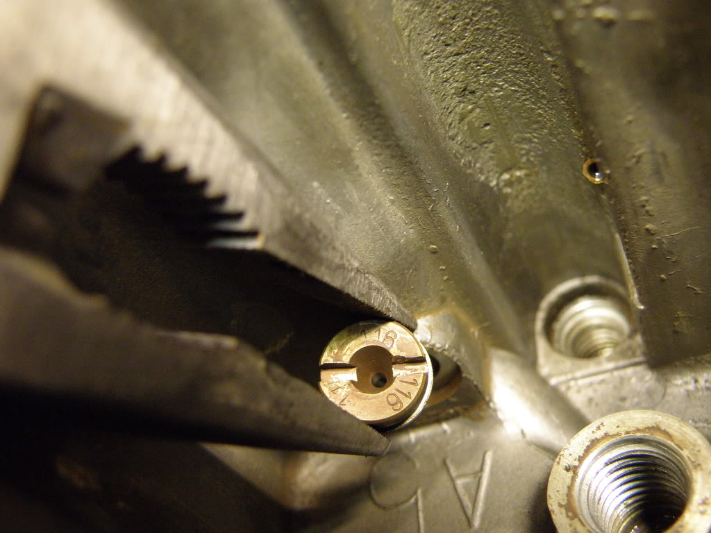

I found it helpful to take pictures of how stuff comes apart JUST in case.

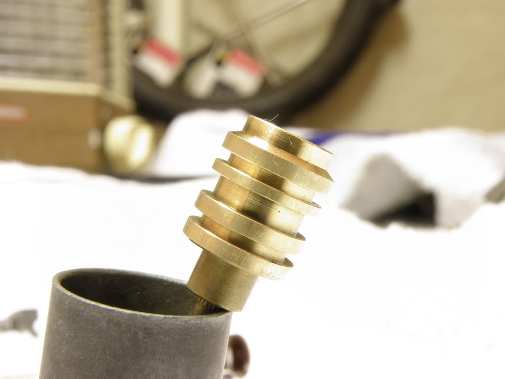

Take pics of the jets as they come out, some of them look very alike

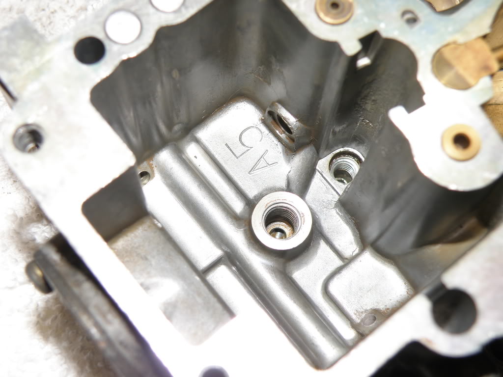

Make sure she's all nice and purdy

I think I'm in trouble here. Couldn't find a way to remove check balls from the auxiliary accelerator pump on this same carb from an 85 22R. They are visible through the holes in the diaphram areas of the AP and AAP sides, but there is no obvious way to remove them.
In trying to push the brass piece up through the hollow on the auxiliary pump side of the carb through the hole where the ball is visible, the end of the brass tube that I think the ball seats against broke off, and I still don't have a way to remove anything.
In hours of extensive searching, I can't find anything regarding how to replace these check balls, despite the carb rebuild kits having them included. Does everyone ignore these?
