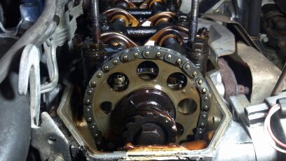

Possible issue: Driving to work the other day I was stopped at a light. Looked down and noticed RPMs Oscillating between 1000 and 1300- I found it odd but kept driving anyway, I figured I would be chasing a vacuum leak later when I got home. Fast forward through the work day- I am getting in the truck to leave, cranked it and had this stout screeching noise not unlike a slipping belt. I did the only honorable thing and passed it off as a slipping belt :-) Got to the house after a 23 mile drive, popped the hood (by this time the rpms are holding a steady 1000 rather than the usual 750ish) and immediately made note of the "timing chain running against the housing noise"- a pretty unmistakable noise in an easy to identify location.
At this point I have parked the truck in the shop, torn the valve cover off expecting to see a demolished rail and generalized carnage, what I see instead is a perfectly intact timing set and a fairly clean head for the mileage. It is hard to tell if the timing set has been replaced since I'm not sure I've ever seen a "factory" set right next to any replacements, but I assume it has given the mileage and the fact that the dude I bought the truck from "thought his brother had had the engine rebuilt" at some point.
What I did find odd though is that the "bright" link that I thought was supposed to be parked on top of the index marks was hanging out 6 links counterclockwise of the mark (see attachment).
Assumptions I've made so far: My tensioner is giving up and I probably need to lay in a timing set. Additionally, I figure the timing set has already been replaced "at some point" and the person that performed the duty didn't use the "bright" links to their full capacity...
If it jumped 6 links wouldn't I be putting a head on it? Also, wouldn't the link tend to jump in the clockwise direction?
I haven't gotten too far into it and if I don't have to tear it down, I'd rather wait. As far as precise measurements what I can say is that the chain has about 5deg of crankshaft rotation worth of slack while on the truck- this seems acceptable to me but perhaps everyone here can shed a little light on the matter.

Bright link is lined up on assembly. 2 sprockets are diff sizes, so it will not line up everytime.
If you jumped timing...you would know it. It would buck...backfire...etc.
Screeching...maybe waterpump? tensioner? fan? poke around some more.

That thing is way off...if it's at TDC on the compression stroke.
It can jump time due to a worn out tensioner. I would get it to TDC on the COMPRESSION stroke and see where your marks are at. To make sure your at TDC, the two valves on #1 should be loose.
Take a picture and post it...then we can tell you for sure if you jumped time.

Yeah, I got to thinking after a while and figured the links only line up on occasion after install. I'm beginning to think it may be a wasted bearing somewhere- the more I listen the more it sounds like a grinding bearing rather than a chain skidding across something. I poked around with a screwdriver to my ear and found most of the noise SEEMS to be coming from the water pump housing. The noise goes away if you rev it but seems to come back after a while of idling. I buttoned everything back up and decided to drive it 'till the water pump pukes or something else makes itself blindingly evident.

check timing by setting crank pulley on TDC mark, #1 piston at TDC and rotor button pointing at #1 lobe on dizzy and #1 cylinder valves are closed. think there is an o mark on top of the cam sprocket too.
go ahead and change the water pump before it seizes and leaves you stranded like mine did on my 79 4x4 about 40 miles from home.
