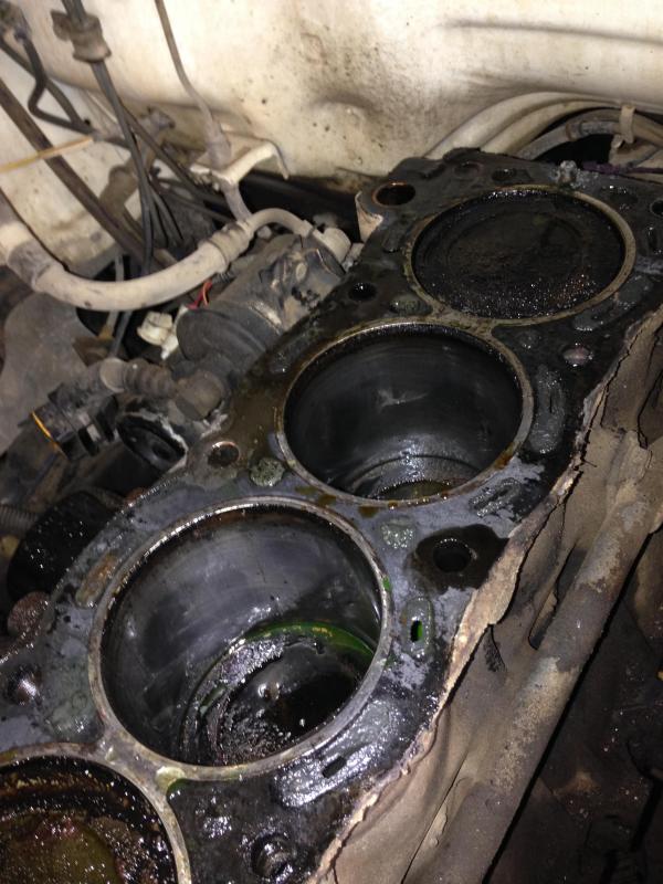

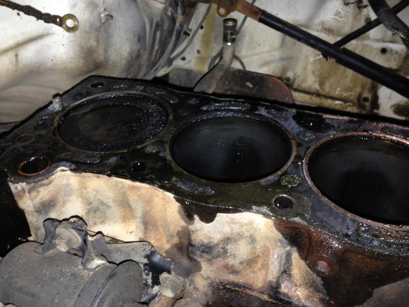

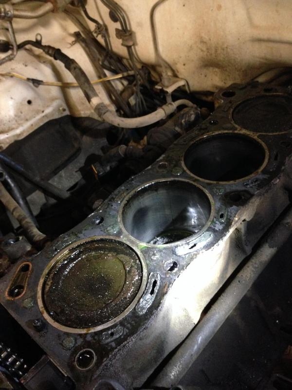

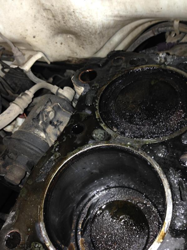

Long story short: timing cover hole, coolant in oil, had to drive it home (one of those days), overheated, headgasket failure. And yes, I already know I'm an idiot.
Looking back on it, I believe I ran it for several days with coolant in oil. There was large amounts of coolant/oil in the intake manifold, head, and block (lots of water/oil mix when I drained the oil).
My concern is the amount of time water was in the motor (while running) and having bearing failure a few weeks after sewing this thing back up.
I'm at a decision point: should I proceed with the HG and see how it goes? Or should I just cut my losses and pick up a long block? Are there any other tests or things I can check to help my decision?
Also, there is a ton of build up on the pistons (more so than some of the other pics I've seen); should this be cause of concern?
(Of course, I'll be checking deck and head, etc. before I continue with HG)
Thanks!

How much coolant do you think was in the oil? A small amount is one thing, gallons is another.

Shows how tough the 22r is right here!... When i first got my truck I went through the same issue as you did. I was inexperienced with the 22r and ran it for about 1000 miles like that. My head gasket blew and i was leaking into cylinder no. 2, just like you i did not notice for sometime. I ran about 1000 miles, filling up the radiator every time i filled up fuel. Now i had the truck barely 3 weeks and had been fixing a million other problems as well. After a few good dudes on here lead me to know my HG blew i replaced it. 300 miles later it blew, then my oil pan seal, i replaced that. it blew again and i noticed gold flakes in the oil from the bearings... needless to say it was over at that point. Rebuild the bottom end as well is my advice!

Antifreeze will destroy the bearing material.
If it was just plain water you might squeak by myself I would not take the chance.
May as well fix it all now.

Re-reading, I noticed "lots of water/oil mix"....yes, it's time to do the lower end too, IMO.

Now I concur. Might as well re-build. On mine, shop found typical wear on my cylinders and I have no maintenance record from PO, so I decided to have complete rebuild (with metal timing chain guide), and replace everything to protect the engine from overheat- new hoses, water pump, belts, radiator (because it's got a repaired rad on there).

a set of main and rod bearings with thrust washers is only $70. I just did mine and it was SUPER easy, just had to go slow to get everything to seat properly. bearings are cheap, replacing a failed rotating assy isnt.
if your's look like the top bearings you'd might as well replace em.
