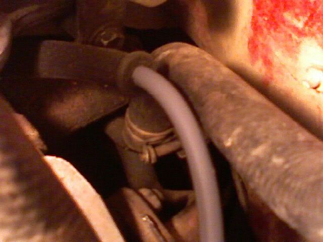

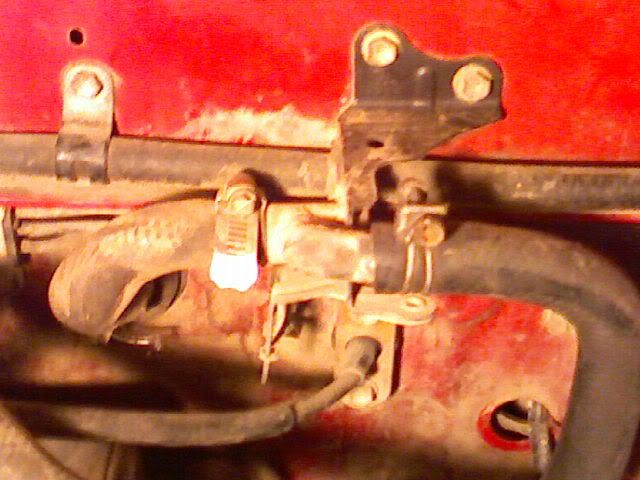

Can someone confirm this is all correct before I start tearing things apart?
I'm guessing this is the outlet of the heater core
This must be the inlet and the metal piece in between the hoses is the heat valve?
I'm also guessing this where I should disconnect the outlet hose for the flush
And this where I disconnect the inlet hose for the flush
I must have the heat valve open to do the flush and use low pressure when doing it and alternate sides inlet outlet until the water flows clear and fluently though.

I just pulled the inlet and outlets off... at the valve and at the firewall as you have you in your pictures..
took the garden hose with an oldschool spray nozzle. Full blast, blasted the effer clean. worked flawlessly, heat went from 0% to 100%.
you mentioned low pressure, why? Just blast water through the son of a gun
