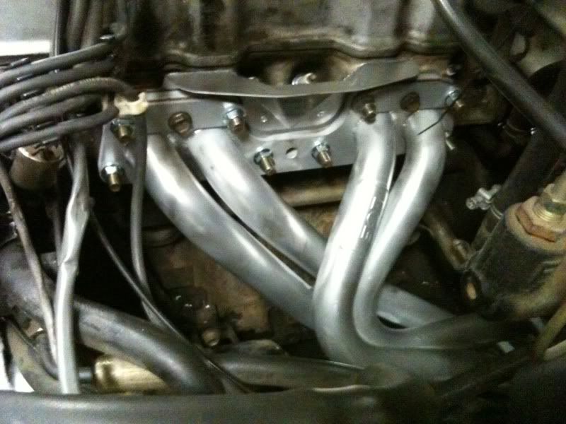

Phil, I will measure up the cuts and let you know. And I have been taking some pics to appease BBP. Or he'll never believe it happened.
I ended up cutting the pipe between the cat and the muffler up near the muffler slip fitting, and I cut a little off both sides of the connector pipe so the bend sat over the crossmember.

Phil, these are for you.
So I cut that slip fitting up high in the last pic about 3.5 inches.
On the header/cat connector I cut 2 off the front, and 3 from the back to keep the O2 sensor over the crossmember.
Everything went in well, no O2 codes running it around on a test drive. The rear slip fitting in the pic has a little leak, I will address it tomorrow when it cools down. Let me know how yours goes.
