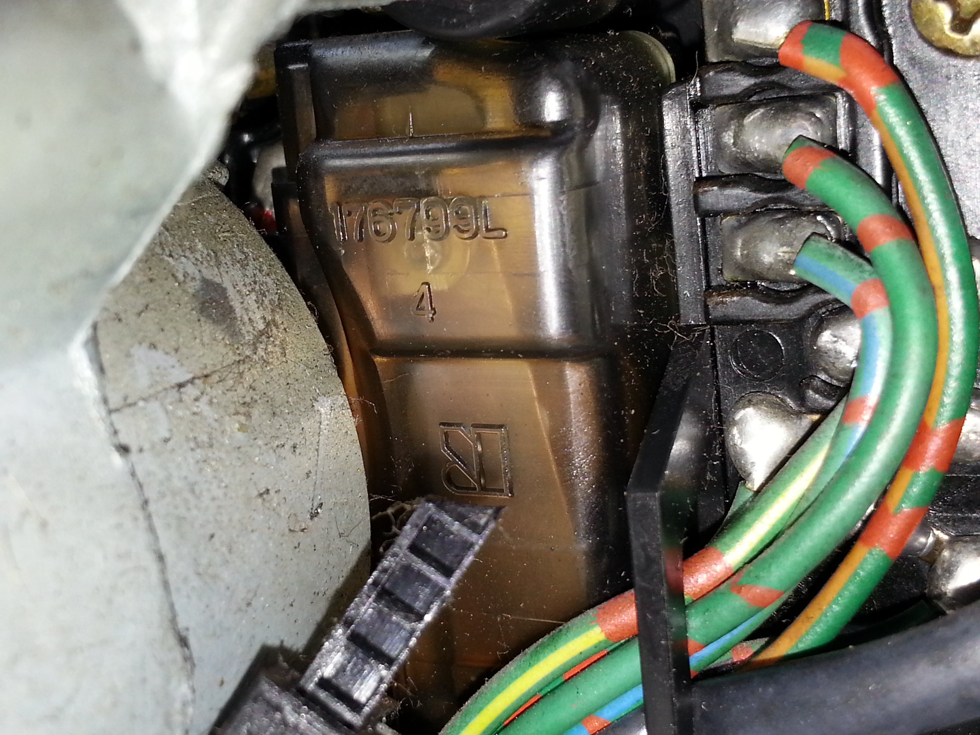

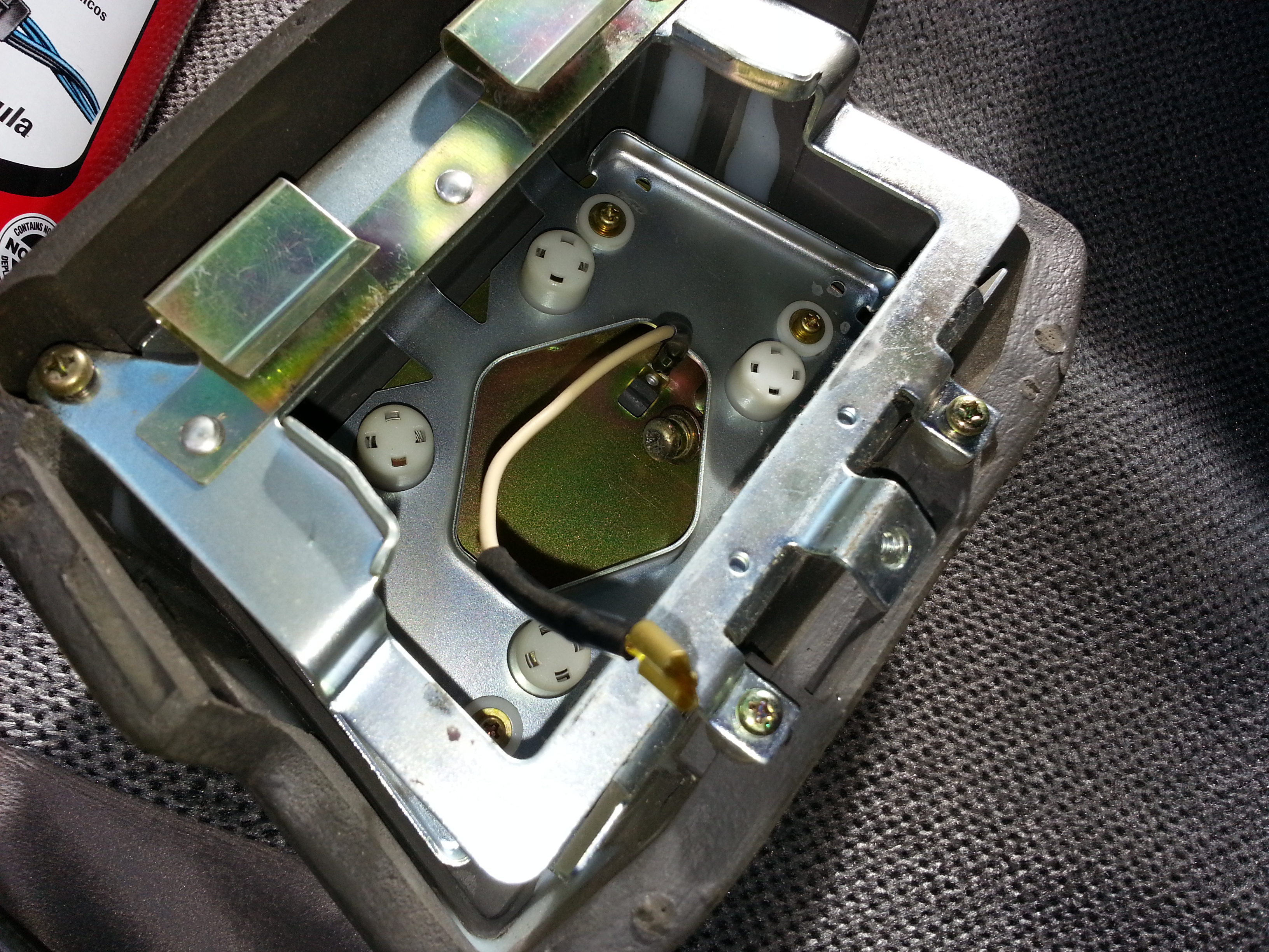

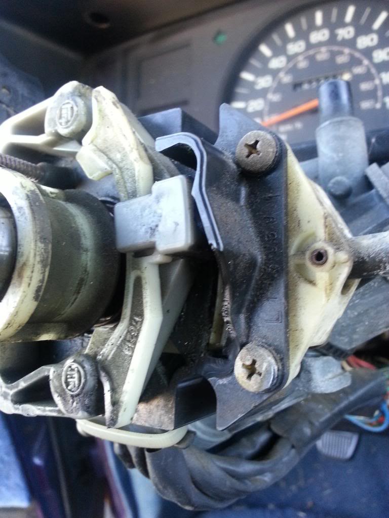

Hey man... Could be the steering wheel being for a different year might be causing some issues. I'm not sure that it could break off the portion of your left and right turn signal operation... I guess with some pictures with the steering column cover removed, we can go from there. I just want your some of this with the turn signal issue... It is pretty clear of the turn signal apparatus but is connected in ways. I took quite a few photos and I believe I have them in their own album in Photobucket.... My username there is imachefbrotha .... I believe the album is called "A Turn Signal drama" ? Lol.....

Thats all I have right now... I think I have some more my phone that I never uploaded, & I know I have some video explaining the operation of the turn signal actuator. If you look at those pictures you can see how the horn works on an 87 4runner. ... I believe on the pickup on some 85's the horn was actually on the wheel hey arm portions Connect the center to the outer portion. Two little buttons, one on each side where your thumbs would push. Clearly on mine it is a completed ground as you pushin the pad, which makes contact with the circular desk that you were talking about under the steering wheel. I'm very exhausted and on some medications at the moment... No, nothing illegal! Lol. Just not myself 100 percent... Anything I can do to help I will. Also there's a buddy on here that I'm sure will jump in.... Excellent dude! I don't want to give out his name without his permission... So I will just see if he wants to stop by. He's a master electrician.

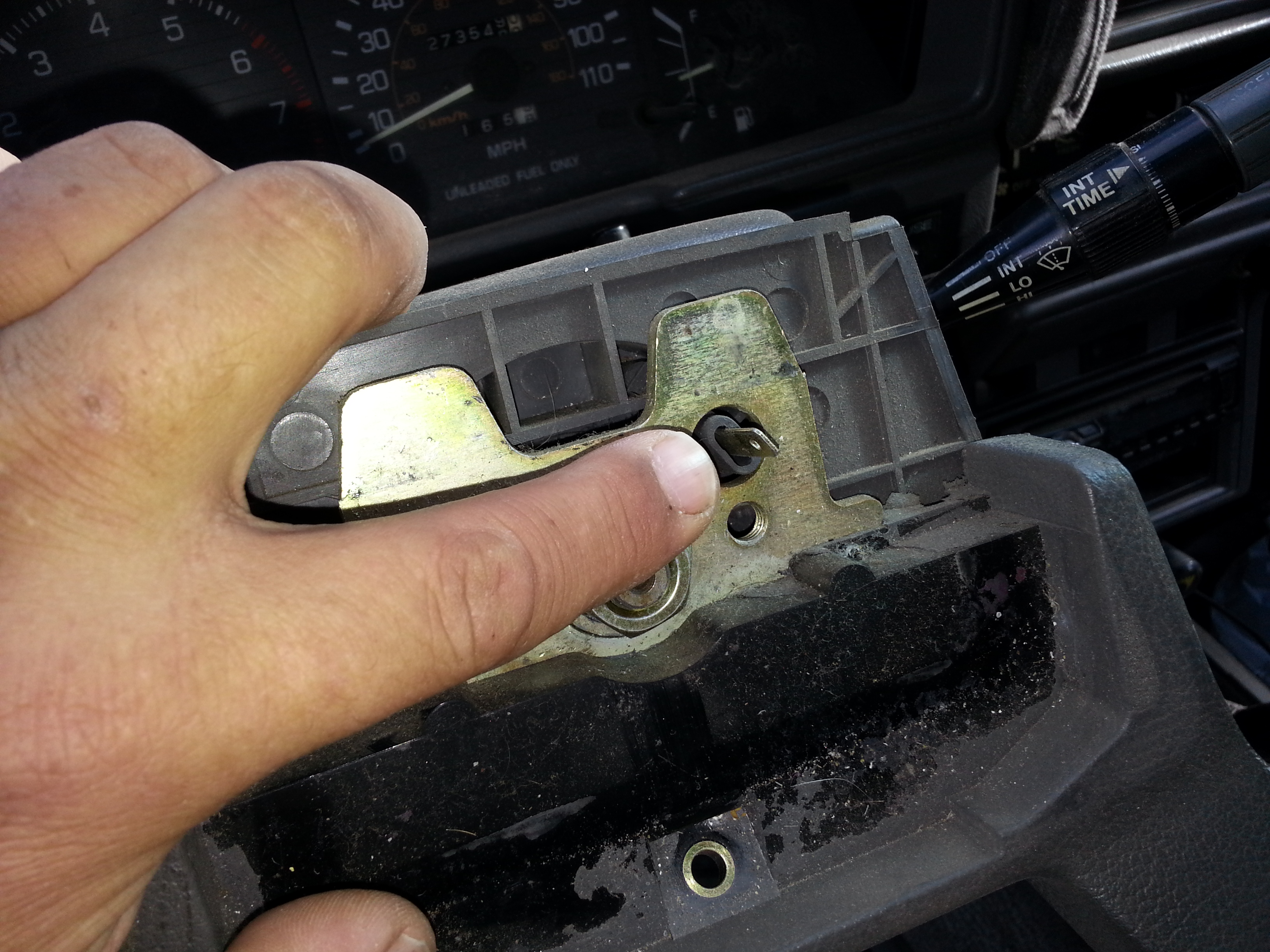

When I was taking the old wheel off i chipped the plastic track that the turn signal rides in. Not sure what this part is called. I found the missing piece of track and glued it back on. Hopefully it lasts long enough for me to get a replacement part. If anyone knows the name of the little black piece that is cracked please let me know.

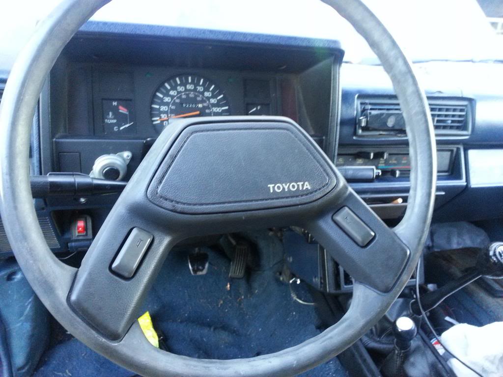

So I now have working turn signals. Now I have to decide whether I want to get another wheel or stick with this one. The only problem with this wheel is that my factory horn does not work. But the aooga horn that the PO had installed does work. I just have to press this button to the right of the wheel to make it work.
The position of the button makes it awkward to hit the horn when I actually need to use it.
