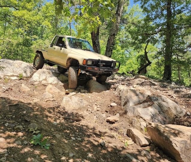

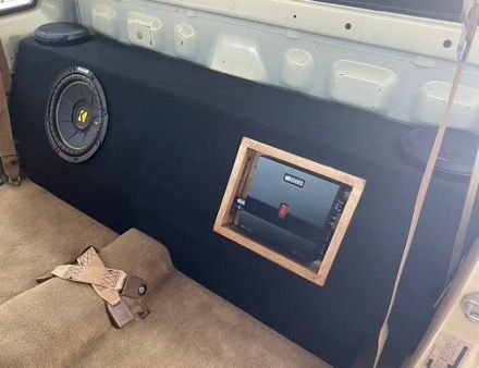

Wow. Been a while since I posted. The truck looks exactly the same. But, lots has changed:
- Upgraded the sound system: Sony CarPlay headunit, MB Quartz amp, Kicker 10" sub and 6.5", Kenwood 4"
- OME springs, shocks, etc.
- Eaton eLocker (R) and Aussie locker (F)
- Regeared to 4.88s
And, the big news (for me)... for the first time since the restoration/build the truck went further than the shop (18 miles)! I drove to Alabama - 115 miles each way - to play at the Chocoloco off-road park. The truck did amazingly well. I mean, locked on 33s, weighing 2,800 pounds should do well. Even the road trip was great. I am LOVING this little truck even more now!

Love your truck, I've seen some of your posts on IH8MUD. How was turning on those trails with the Aussie in front? I have an Aussie in the rear, and other than the occasional bang when it slams in, or the clicking in parking lots, I don't mind it....do wish I had selectable in rear.
Old May 15, 2023 | 11:57 AM
  #71
Manhattan's Avatar
Joined: Jun 2019
Posts: 99
Likes: 74
From: Atlanta
Thanks! Yeah, I've had a few trucks with automatic lockers like the Aussie in the rear, and you're right - the clicking, an occasional pop, tire chirping is about it.
Since this truck will see only occasional 'wheeling, I definitely wanted a selectable. The front auto locker wasn't bad at all. The truck has selectable/manual hubs (and a transfer case ;-) ), so the front's obviously not an issue daily on the road.
On the trail the only negatives were two things - a bit more work, effort to steer and there is some loss of turning radius - as the truck pushes with that inside tire. BUT, the truck was like driving a tiny Abrahams tank! I just went wherever I pointed it. It was so damn fun.
