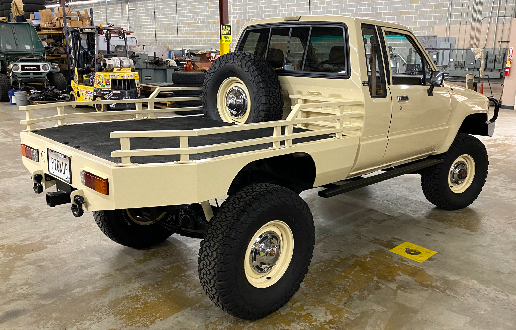

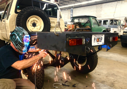

Lono&theGremlin and I bringing back the flatbed/trayback! Check out his badass rebuild of his '85. He helped a bunch in the planning of mine - sending pics and measurements.
First off - I do have a factory 4x4 bed for the truck. It's sitting on top of a shipping container at the body shop that did the work on my truck. It's going to stay there for a while.

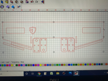

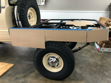

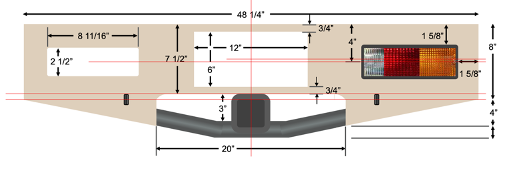

Dugan at ACC Garage is a killer fabricator in addition to being a killer Toyota and Land Cruiser builder, restorer, etc. And fortunately for me, scraping the flatbed the PO built, and starting over was his idea. I spent a few (okay, lots and lots) of hours designing, redesigning... cutting cardboard... redesigning... before landing on the final design.
So far:
- Frame is done
- Sliders are built and headed to the powder coater
- Spare mount is done (will hold spare without strap once pin is in place)
- Three of the rear panels are done
- Lights mounted and wired
Left to do:
- Remaining side panels - (cut, need to be attached)
- Receiver hitch
- Rear panel support and frame tie-ins
- The deck
- Headache panel/tube
Once those are knocked out, it all gets taken off and sent to the powder coater... even the deck - that's 1/8" plate with a bunch of tie-down cutouts. (it helps to have a badass plasma table in the shop!)
Computers are great, but there's no substitute for a "3D" mockup...
Round wheel well - note the string on hubcap ;-)
Matching the shape of O.E. front fender and bed...
My design...
Converted to a file for the plasma table...
Files coming to life...
Later, we're going to add folding and removable side rails - similar to the new 70 Series Utes we don't get on this side of the planet.

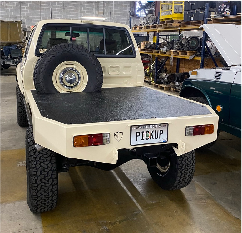

Got a little more done on the bed...
Next up:
- Remove the bed, weld/grind, flip it, weld grind
- Bed goes to powder coater - will be body color
- Headache rack
- Receiver hitch and cross member
- Fold-down/removable sides

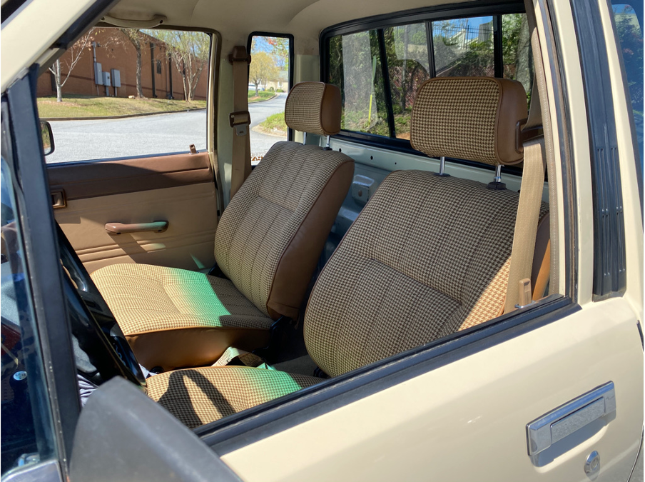

Some progress....

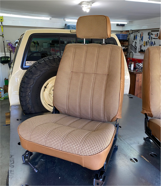

- Seats reupholstered
- Bed's been powder coated and Herculined
Next up: Sides

Sweet. How much did it cost to reupholster and how long did it take? Where did they get that upholstery material? It looks very early 80s authentic.
Old May 21, 2021 | 11:47 AM
  #57
Manhattan's Avatar
Joined: Jun 2019
Posts: 99
Likes: 74
From: Atlanta

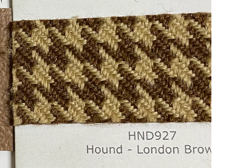

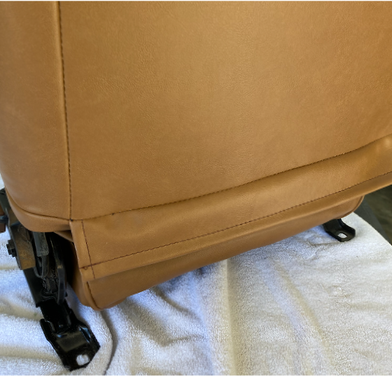

Thanks. After talking with four upholstery shops in/near Atlanta - getting prices from $1,400-2,000 PLUS materials... I found Tony's Upholstery in Norcross, GA (about 20 min. outside of Atlanta). They had great reviews... and quoted $800 including materials. Tony recommended the two-tone headrest and added a flap to the back to hide the hog rings and seam... and rebuilt the foam. He had both the vinyl and houndstooth in stock. I spent like 3 min. picking out materials - saw the houndstooth, then picked a brown to match. Boom. The seats are so (!) much more comfortable. I didn't realize how much the foam had degraded.

He did an awesome job and that's about 1/3 of what I expected it to cost. I really like the fabric choice. Most people would think it's OEM. I'd love to redo mine.
