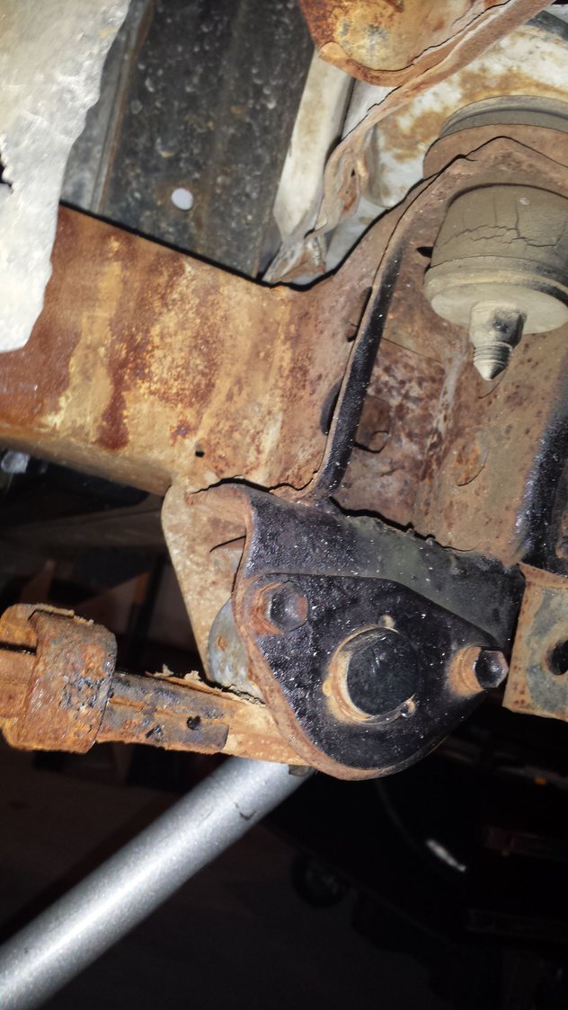

Is this the stock front leaf spring bracket?

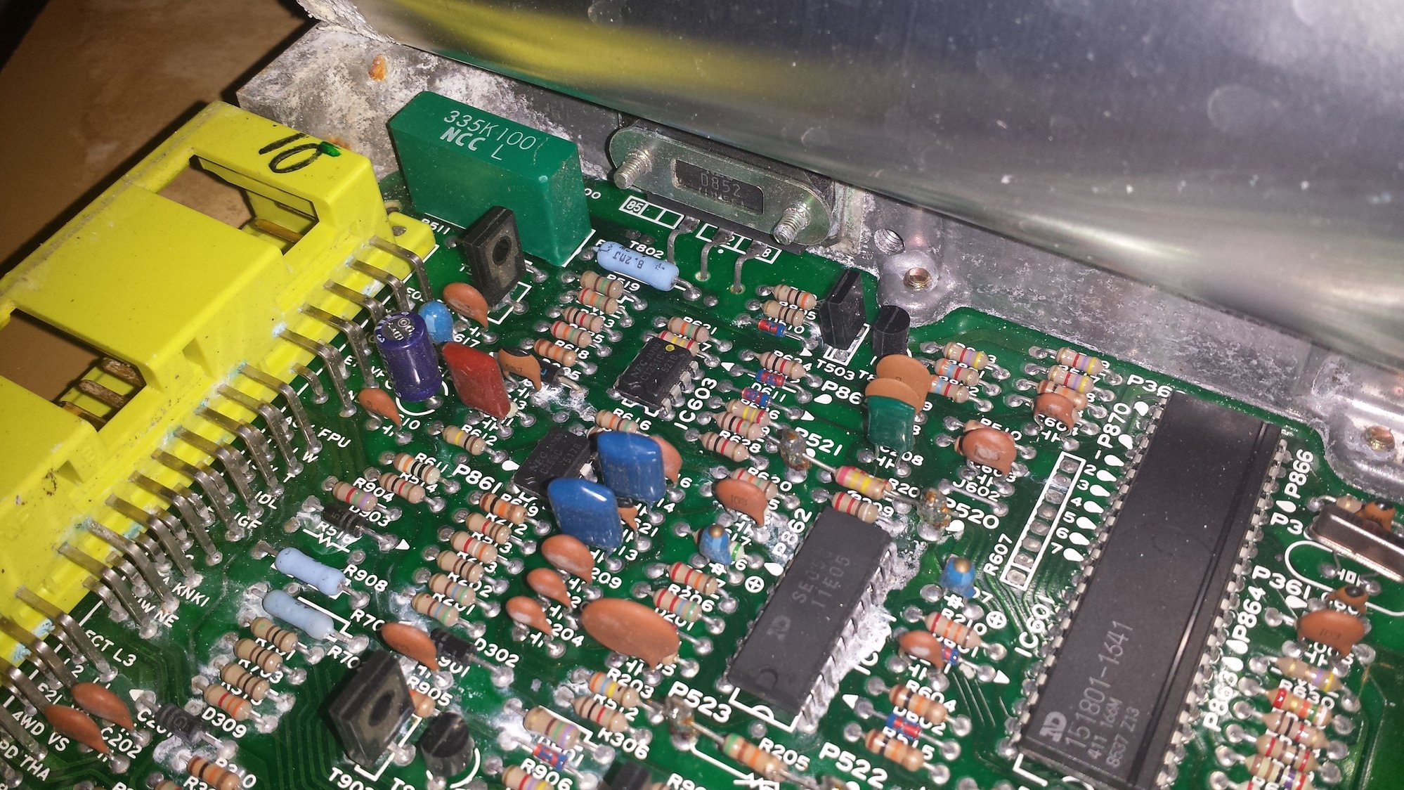

Does this ecu look fried? I tested at like 162v with the ignition switched in the on position and the tester leads connecting the B+ and E1 with the harness connected.
The engine isn't getting fuel and I tested from the fuel pump to the circuit opening relay (COR) and they test good when jumped from a battery. The CEL isn't coming on and the COR isn't clicking with the diagnostic fuel jumper installed and the ignition turned on per the FSM.

the ecu doesn't show any burned areas, nor any blown-out areas on the chips, right? put your nose against it, and see if anything smells burnt.
follow this guide to attempt fixing the fuel circuit, and to see if it's throwing any codes: http://www.4crawler.com/4x4/CheapTri...CheckConnector
i don't know about the spring mounting, my rig is heavily altered.

Looks like its the stock spring hanger, but if not why does it matter?
