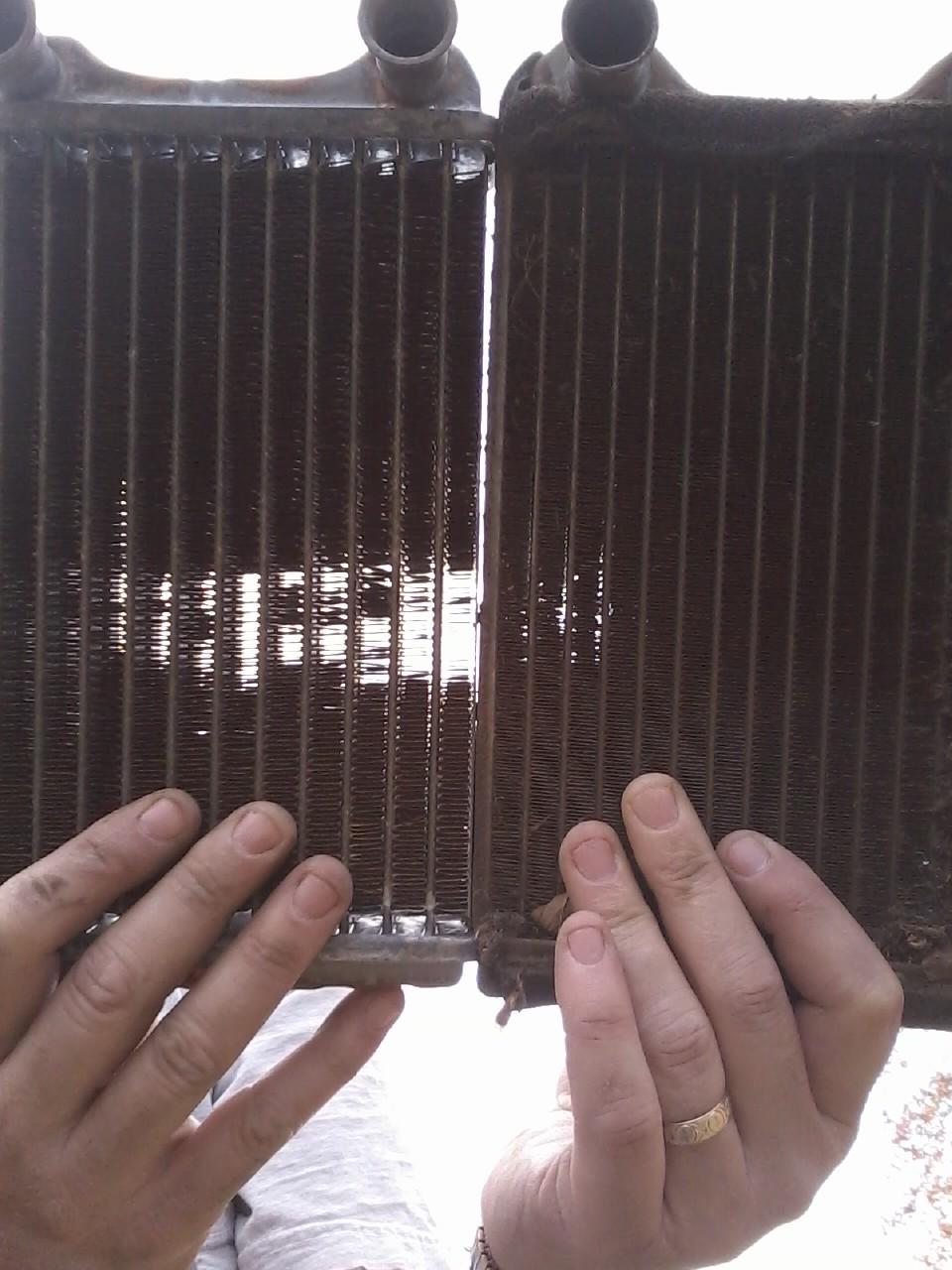

Does your truck have ac? If not, you will have a square tube behind the glove box that takes the place of the Evaporator. Pull the black plastic box/connector and see if alot of debris is clogging the fins of you heater core.
New one on left and clogged one on the right. If you are getting hot water thru the core but not out into the cab, the below could be a possiblity

Old Dec 22, 2015 | 04:13 PM
RBX's Avatar
RBX
Joined: Jan 2010
Posts: 3,795
Likes: 33
From: Bloodymore
^^^ good point. Could have debris blocking the core air flow

A truck with AC, the evaporator will catch all the debris, a truck without AC will let the debris go straight to the heater core. https://www.yotatech.com/forums/f116...trucks-286766/ The plastic piece between the blower and heater core is easy to take out and you might be able to vacuum it out and get it heating better. If you do have the evaporator, the heater core wont be dirty. If the heater core is dirty from not having an evaporator and vacuuming it out wont clean it, you are going to have to pull the heater core which is not a fun job but not as bad as it is made out to be.
