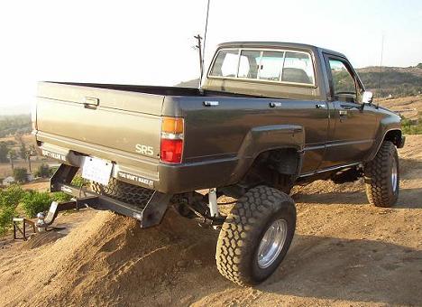

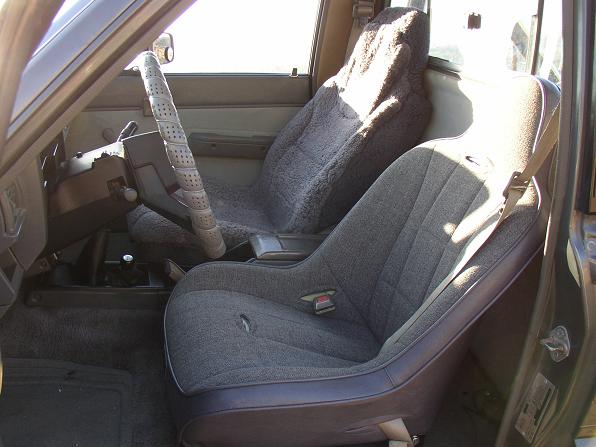

Alright, I finished up my lift and i ended up with doetsch tech 8000 "prerunner" shocks which have heavier valving. The ride is a lot better then it used to be even with the stiff shocks. Ive been running this setup for months now without any problems. I also got rid of the body lift. Doing new energy body mount bushings help ride quality A LOT!! attached is a pic of my truck doing a little flexing. I could go a little more then in the picture. Its sits so high because the body lift was still on. Also attached is another little project I did over the summer.
