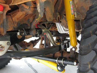

I replaced mine with a Marlink heavy duty tie-rod with FJ80 ends from Marlin Crawler ($127). Here is the link:
http://www.marlincrawler.com/htm/steering.htm
It is very heavy. I don't have a great photo of it but you can at least see the diameter in the attached photo. This tie-rod does not have the stock steering stablizer attachment point. You have to have an adapter bracket. Most after stock steering stabilizers come with one or Marlin can also supply you with one.
