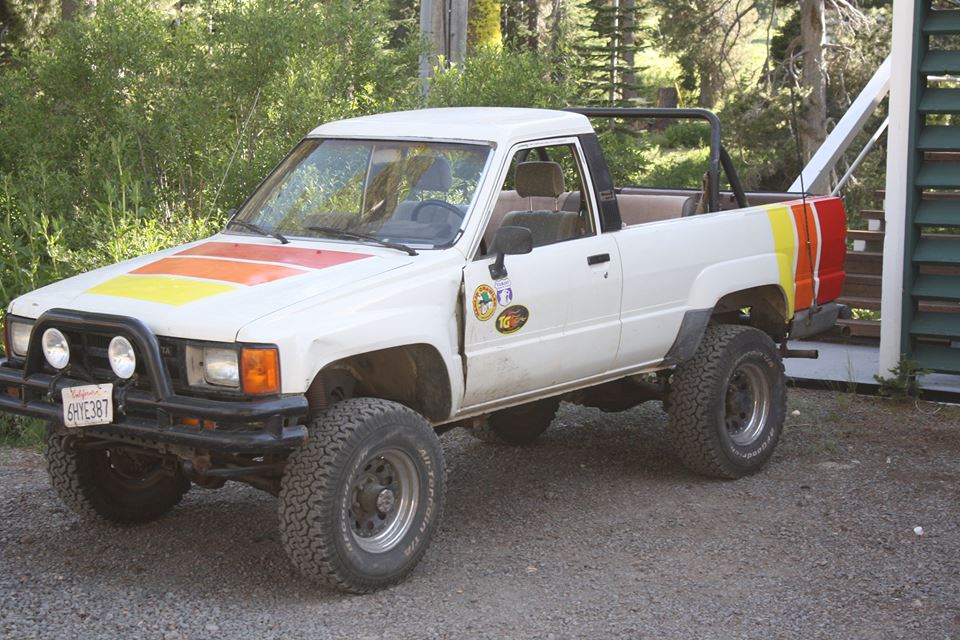

Bonus: picture of my rattlecan paint job.
