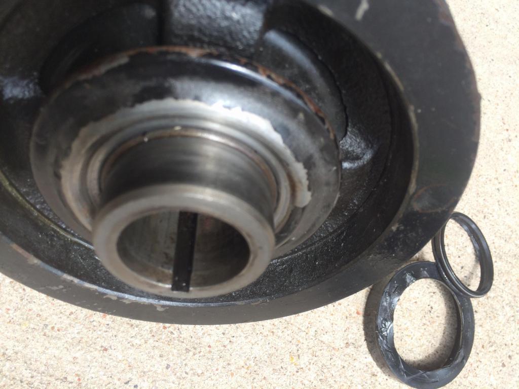

So I posted earlier about a leaking oil pump after timing chain replacement. I took everything apart and resealed timing chain cover and oil pump. All that is good now. I put in a new front main seal and it started to leak instantly.

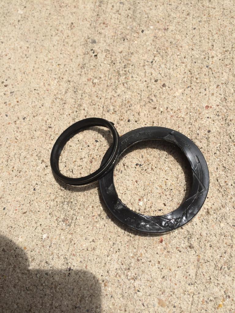

I just tore it apart again and found this: Looks like seal separated some how. What would cause this? It was lubed up prior to install. The outer ring is damaged from me removing it.

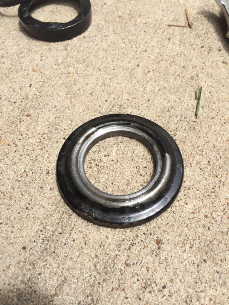

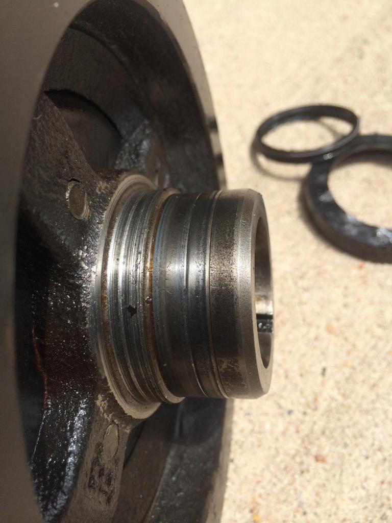

After further inspection, it appears my pulley has 2 groves in it. I guess my only option is to replace or sleeve it. I noticed this metal ring on the back of the pulley also. Is that a stock ring? It looks like it was added to push seal out to a different spot on pulley (hence 2 grooves).

Sleeve it or replace the pulley, but since you bought an offset seal try that.

...you put the oil slinger plate or whatever its called on backwards, at this point I would just remove it.

Gonna try the offset seal. I also found out that metal ring is the dust seal and is usually pressed on (yes I have it on backwards in my picture). I tried to press it on, but it was VERY loose. Toyed with the idea of JB welding it on, but decided not to. To prevent another seal getting eaten up, I am not going to re-install it with the pully.

my 20r had the same problem, i found a stainless sleeve that goes on the pulley.
worked for me.

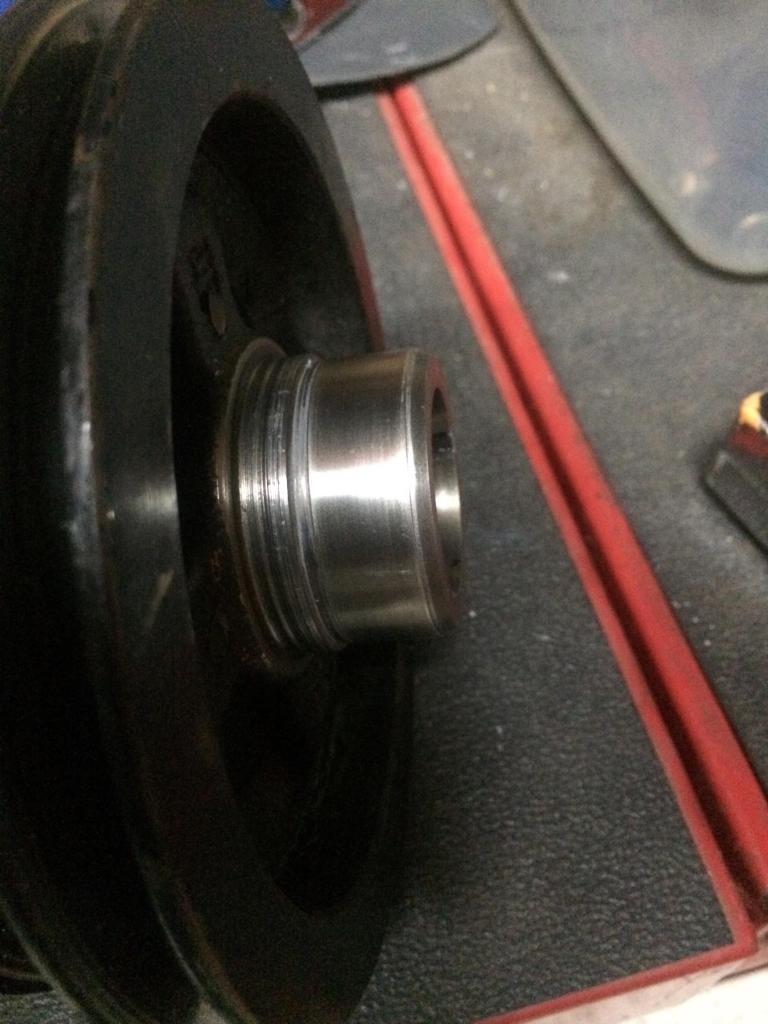

Ditched the dust cover and put a sleeve on. Figured I had it off and did not want to do it again. Gonna do the slim seal since I have it. Figured I can switch to the full size seal when I rebuild down the road.

That should do the trick.
Good Move...

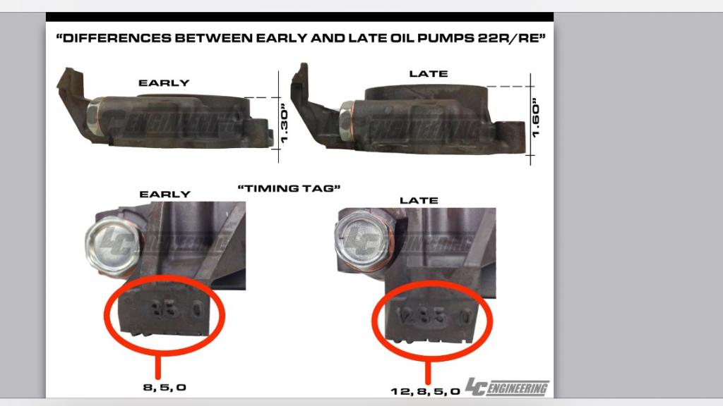

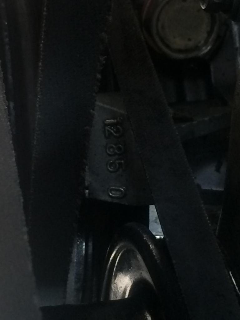

Just found this tid bit of info on the LCE website:
I looked at mine, and from the timing marks, it appears Autozone sold me the wrong pump.
I have an early casting 1984 22R. I cant measure it yet, but quick glance it appears to be the wider one. So I assume every time I put in a seal, the crank pulley was basically mashing into it and causing the leak. I had Autozone order another one so I can take a look.

DONE! Turns out I bought an oil pump from Autozone that was in the right box and barcode, but wrong pump in the box! SOB! There goes a week of hair pulling, 4 seals and a speedi sleeve. Autozone reordered the pump, and this time the correct 22R pump was in there. It would have been less expensive, quicker, and just plain smarter to buy the pump from the people who know Toyotas - LCE!
