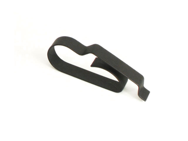

I wanted to update this because I hate seeing threads without the fix. I removed the transmission and found that I was missing one of the two clips that hold the throw-out bearing to the fork so when I would push the clutch in only half of the bearing would apply pressure. I also decided since I was this far to replace the input seal and then I found my input bearing broken so I torn the trans apart and it looks good except for the chipped tooth on 5th gear but that will be a later fix.
