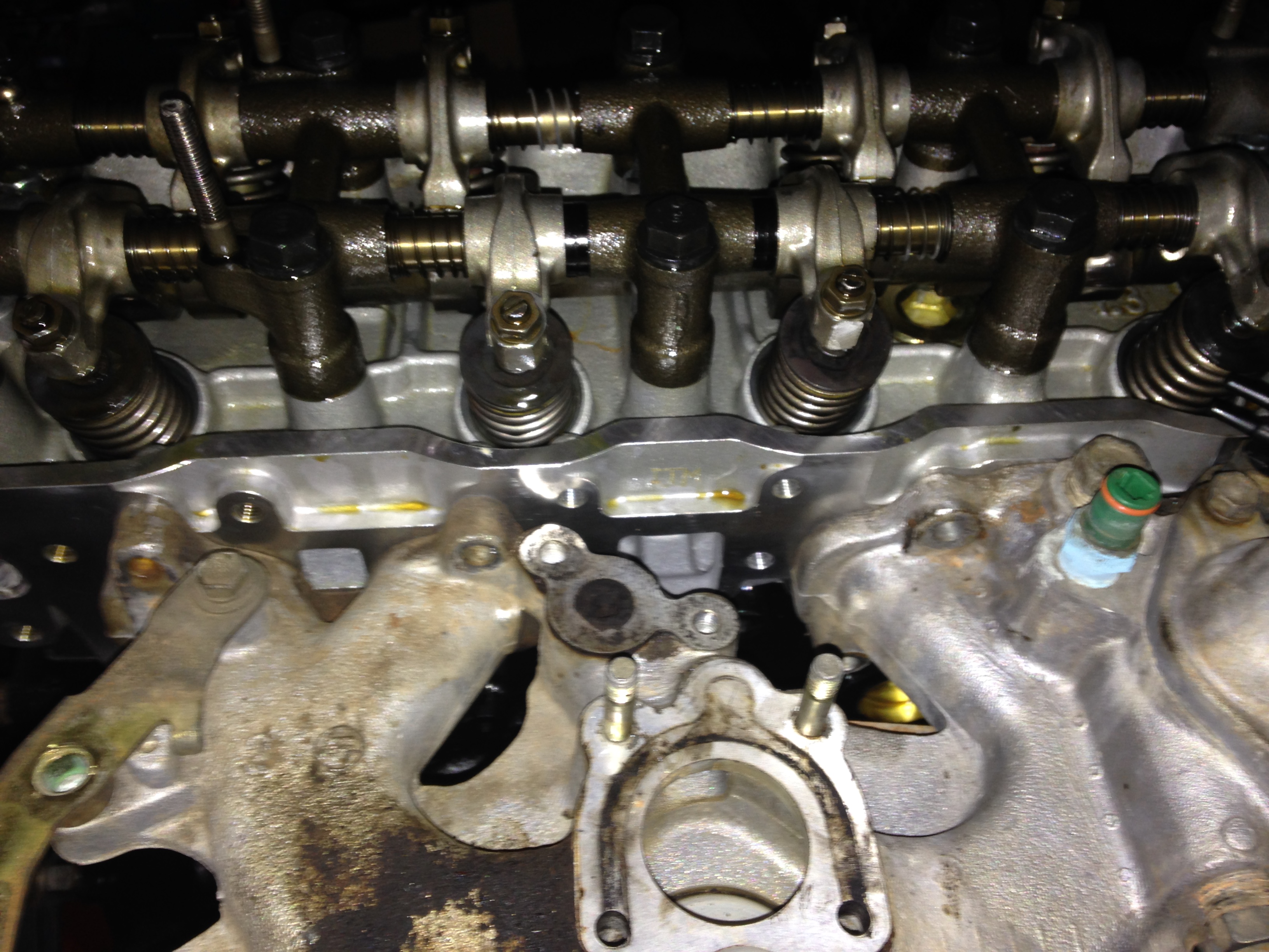

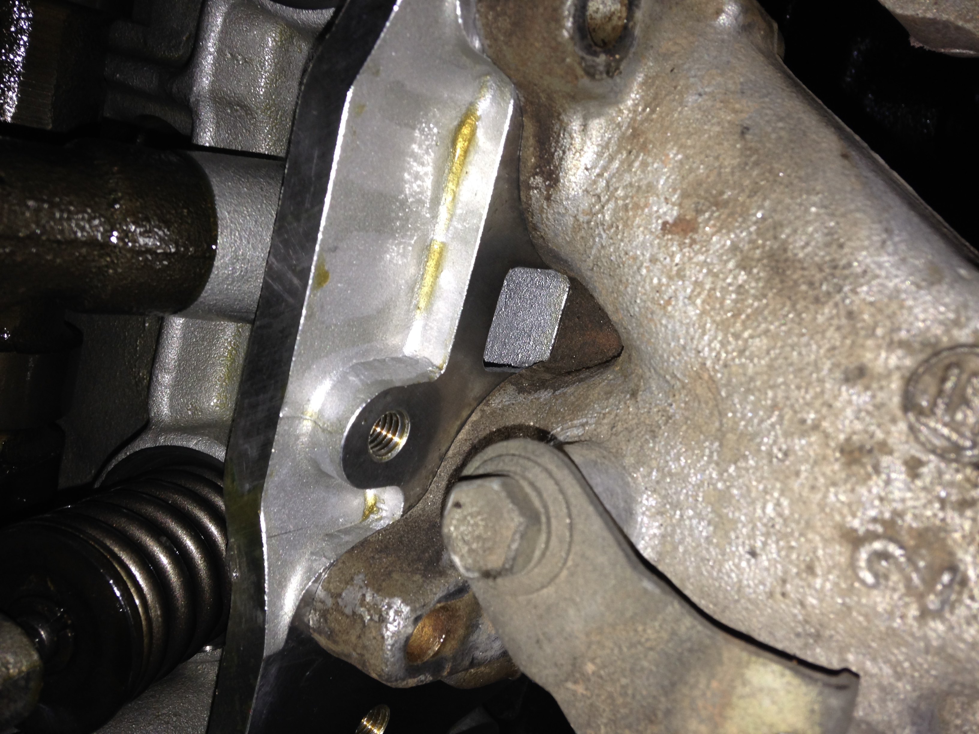

MY QUESTON IS: Can I use my intake off of the early engine? The guy at LCEperformance said that some were different and wouldn't work. How do I know If I can use my original intake? Im confused about 1 part of the head where there is a water jacket that is exposed between cylinder 3 and 4. see the picture

I see, between 3&4. If I recall that hole is very shallow and does not go into the water jacket. I also belive it serves no purpose. For your sake I hope I'm right...
That hole between 2 and 3 coresponds with the inlet heater tube that wraps behind the cylinder head at the firewall. It also has a bimetal VSV for the choke operation at that location and it needs to be installed before the intake...
I know the deck height of a pre '85 block is different and you will need the correct timing cover but your old intake should bolt right up with no issues.

That is the same intake I've put on a number of 22r motors, all '85+.
I've seen cast marks with a shallow depression at that location but never into the water jacket, even on EFI...
Are you absolutely sure its a coolant passage?

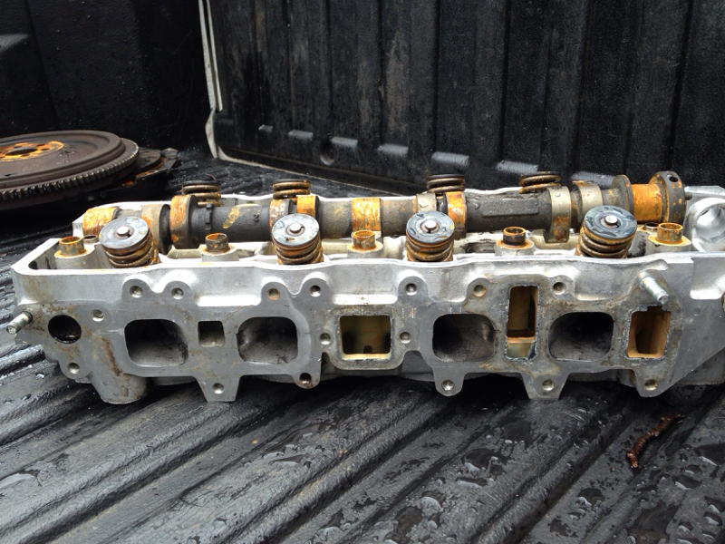

If you are absolutely positive I will go ahead and order the block off kit from LCE. I don't think it is a coolant passage. Take a look at the old head... Building 22R long block, I need advice!-image-1315328302.jpg
