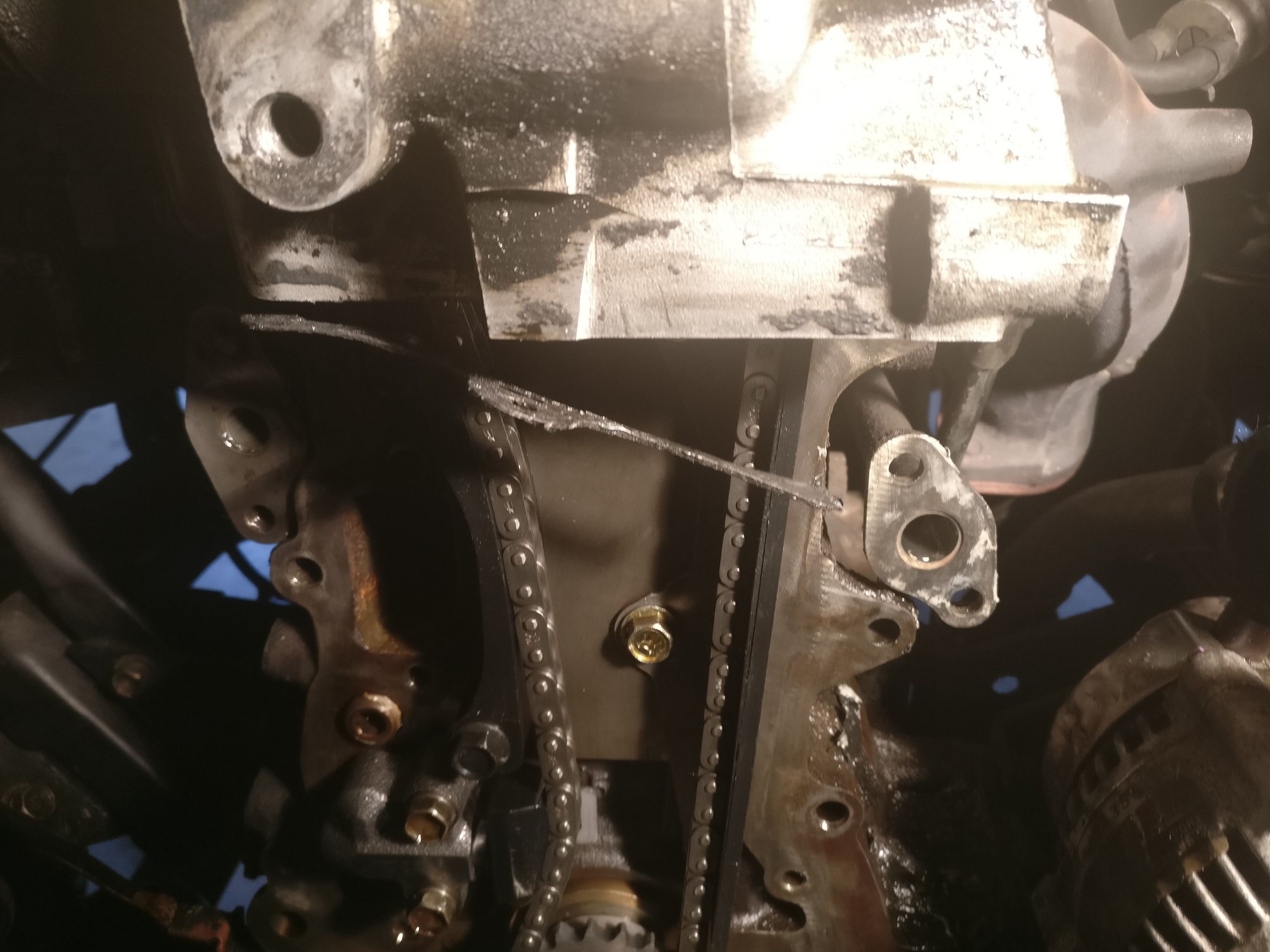

Where the hidden bolt is, the head gasket broke. I would hate to pull the head if it's not needed. The head gasket itself is fine otherwise. Just concerned the timing cover will leak oil since the gasket broke. Was planning to put additional rtv around the broken area to avoid oil leak.
Bad idea for extra RTV. Don't forget that if you have a chunk break off inside your motor it can float around and plug something. It has happened a lot.
Head gaskets are usually less than $50 at the dealership. You will damn near spend that in other gaskets plus the head gasket if/when it leaks and you decide to fix it properly.
Ultimately its your rig, but if you have a broken piece of your head gasket, no matter where it is, then your going to develop a leak. I have had one leak there due to a damage head gasket.
Edit: Can you post a picture of the damage?

I agree with fishguy, that gasket is too damaged. You could try to rtv it back together and if you're lucky it'll hold, but will drip oil from that broken corner forever and you'll hate yourself for not fixing it right the first time. A head gasket isn't any harder to do than a timing chain, just loosen the bolts in the correct order so you don't warp the head.

Thanks guys. Against all recommendations, I decided to wrap it up. Got it running yesterday. Holding on for now. More than the money, I needed it running today. So it was a time based decision. I'm hoping the RTV holds up for a few months. Based on your recommendations, I do have this in mind and will probably just do a full rebuild next year sometime in the first half. Even though the motor is running good, it does have 200K miles. I'll start buying parts and plan to set some time aside.
