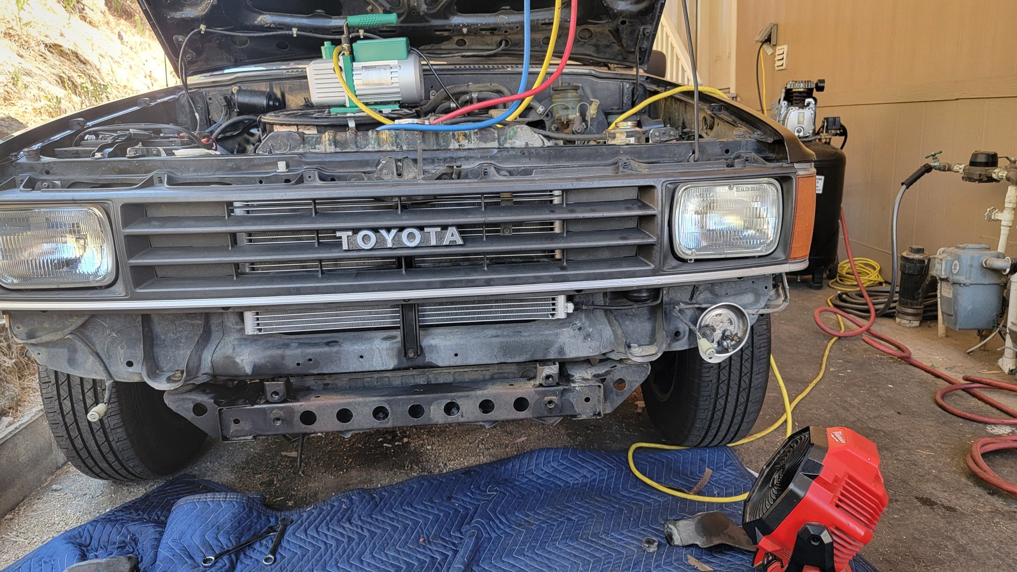

Ok. 22R, pushed in the AC button to hook up equip. RPM went to 2200 and never changed while charging. She blowing cold air, but that rpm won’t fly in traffic!

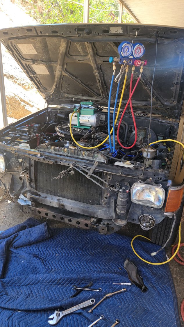

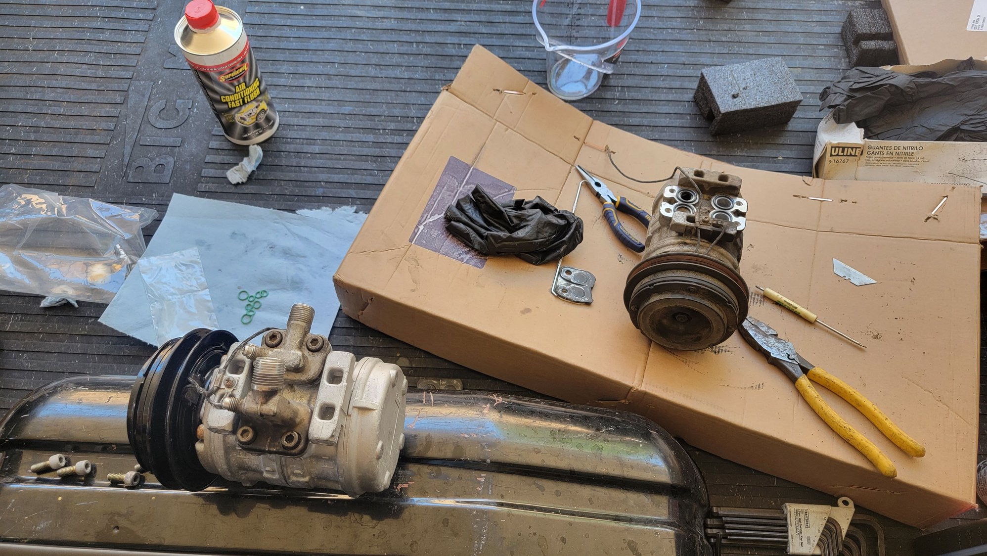

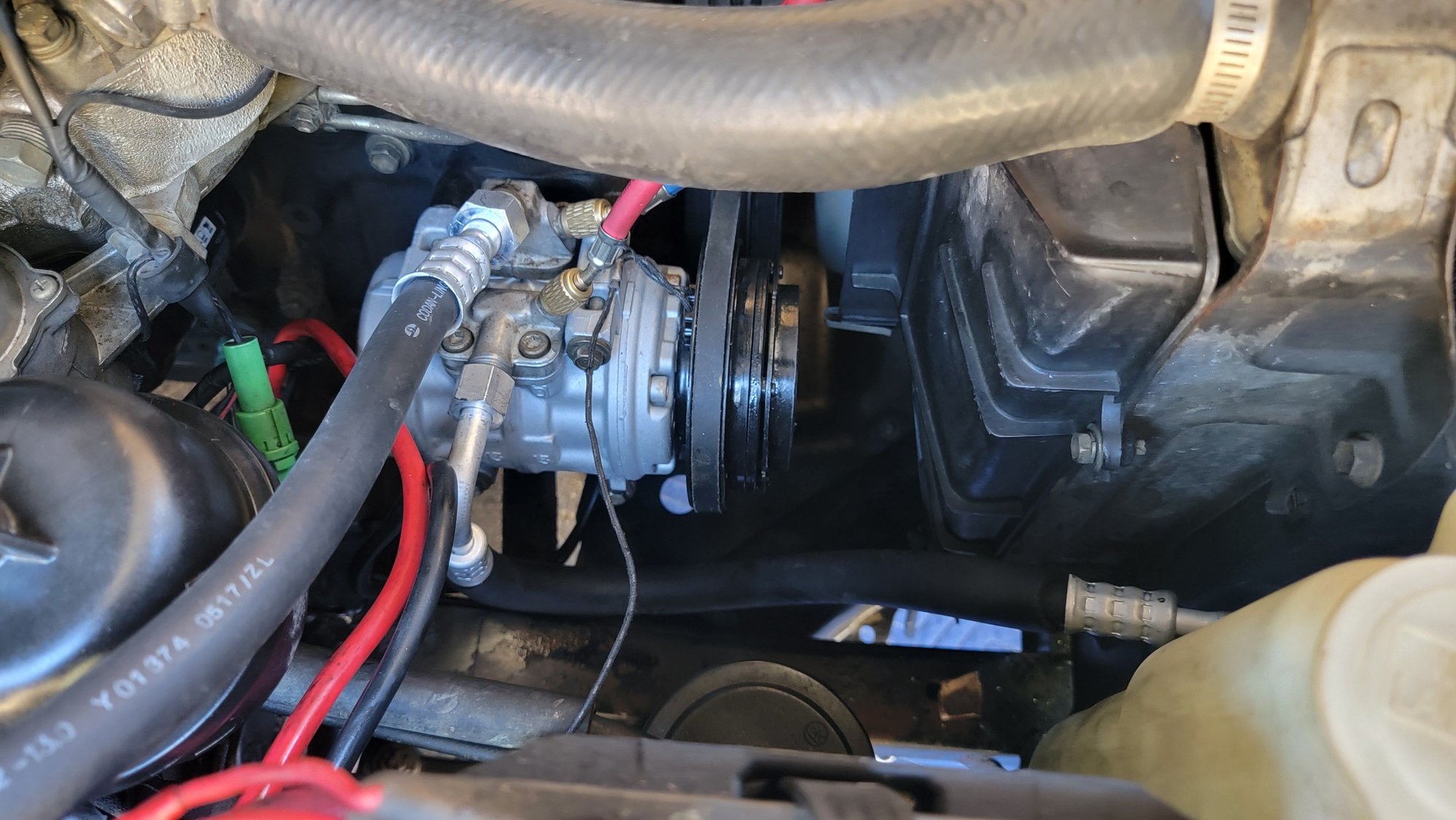

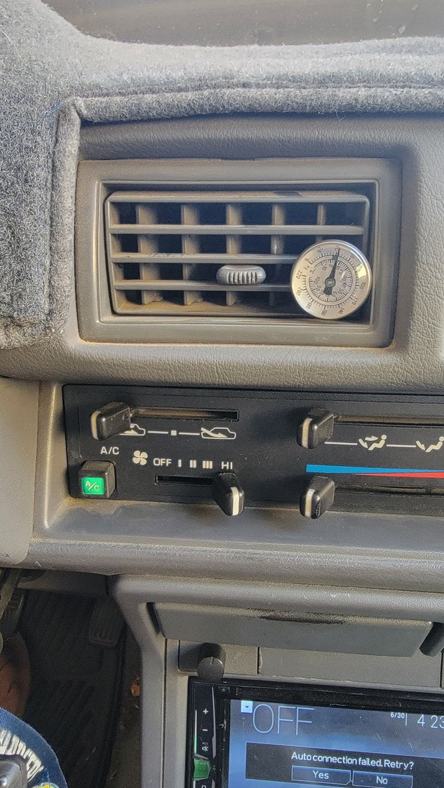

I just finished my 87 22r AC today. Replaced Compressor, condenser, dryer, and pump hoses. All new o-rings and fresh mineral oil and a R12 charge. Getting 39⁰ at the vents and it's 95⁰ today! She never had AC since I've owned it for about 2 years now. Anyways, I had high idleing and it would surge. I turned down the AC idle up screw half turn to the left to lower the rpm and all good now. You can search "Idle adjustment 1982 22r" on this forum and there is a thread on it with a picture.
Best of luck!
She went to 39⁰ on the freeway!
