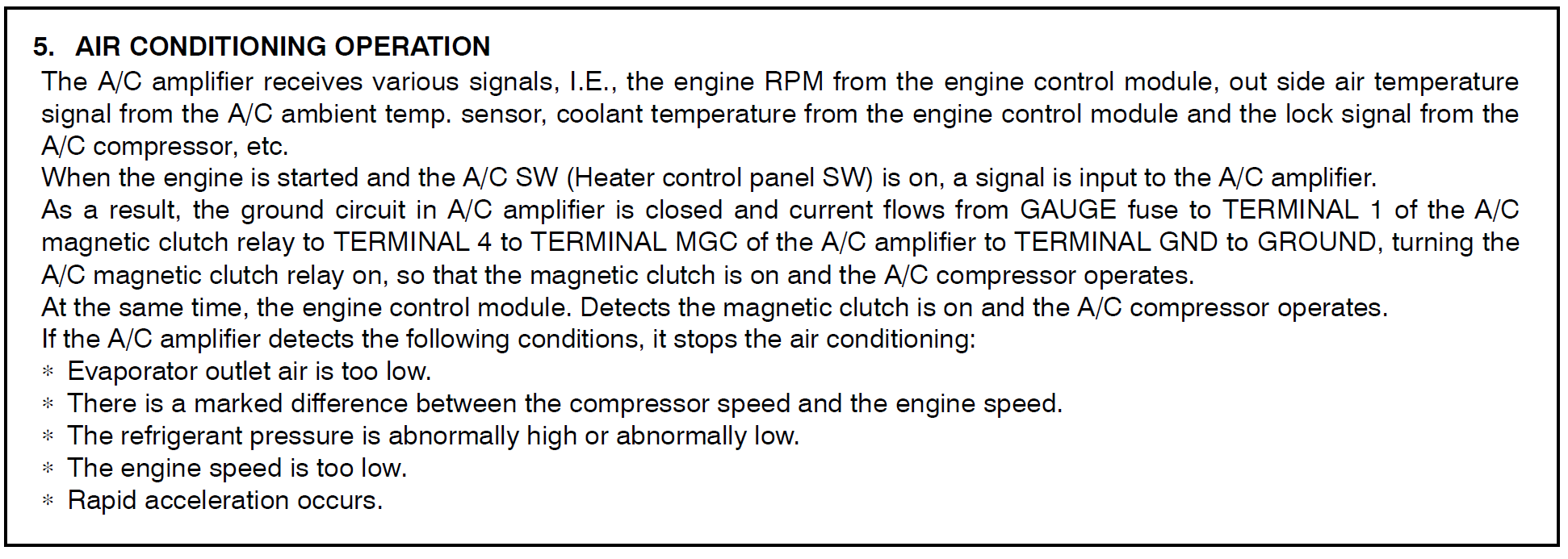

I hopped into the EWD book and interesting the section is called "Automatic Air Conditioning". Here's the description of the AC system, kind of sounds like it does operate in a somewhat automatic mode, but it doesn't actually say the situations where the auto on would activate.

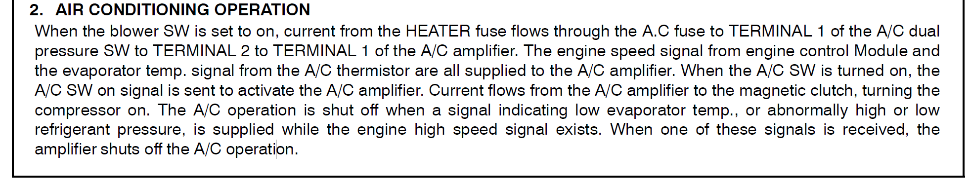

There's also a section for manual AC, here's the description from that section.
Just guessing, but I suspect the "auto ac" is probably push button style AC controls while the manual is the old school manual slider/turn dial type.
Anyway, as stated above, with the blower motor completely off, you shouldn't see the AC run at all, if it does, there's clearly an issue and I'd agree with checking the ac amplifier first. Another possible idea could be the relay stuck on (if you have auto ac, manual doesn't have a relay).
