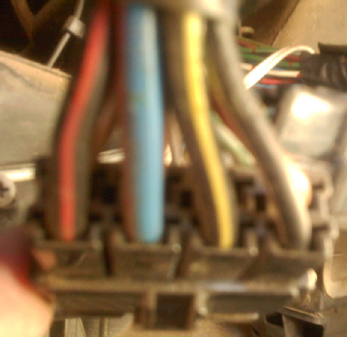

I was thinking to myself . . . “How can I help Ray help me?” Well a picture (a.k.a. 1000 words) of course. So, as you were posting this I played twister and got into (and more importantly out of) a position to take the pic below.
Logic . . . one of those words I love to hear. I probably shouldn’t get into some of the other ones I like to hear in case someone's children are reading this.
Anyway, you’re saying it could be a brown wire – of which I saw 3 on the other side of the pictured connector. So, I’m gonna take an Advil and re-pretzel myself to see what I have on the truck and what my Haynes manual says. And, my trusty HF meter shall be in hand too. Stay tuned.

Annnd, we’re back. With the column trim off the Ignition Switch’s contacts are bare nekkit and labeled so I verified that there is 12 volts at IG2 when the key is on and 0 volts with the key off. Then further down to where the pictured connector is the wire turns to Black w/red so I tested that and it is the same. I’ll be able to work with that wire easily and without tearing the Ign Sw pigtail and protective cover apart. Does this sound about right?
FWIW, I can’t really trust the Haynes wiring diagram here because it covers 1979 to 1995 and only designates “early” and “late” models, but does not indicate where the break point is. It also shows a starter relay which mine did not come with.
Now, as far as making the connection goes. Given the space limitations and ease of installation my first thought was a Scotch Clip. Is there a better, but similarly easy to install option? If I had better room to work I would have more options.
Sidebar: I also discovered that 3 of the 4 bolts that hold the turn sig and wiper stalks to the column were very loosy goosy. Could it be that 30 plus years of rattling shook them loose?

Brown-Red, Blue-Red, Brown-Yellow, (what's right-most wire?)?

...Then further down to where the pictured connector is the wire turns to Black w/red so I tested that and it is the same. I’ll be able to work with that wire easily and without tearing the Ign Sw pigtail and protective cover apart. Does this sound about right?...
Sounds good.
BTW, if you see "Pin 7" somewhere, that's added affirmation.
I don't trust "vampire" taps; they suck.
On MY truck, to tap from along a straight wire. I take some Advil, carefully strip about 3/8" of insulation from main wire, making sure I do not cut any strand, wrap stripped wire of my tap completely around the exposed main wire, then solder.

From left to right you see: Brown/red, Blue/red, Black/yellow, Black/white. If I were Ansel Adams would you be asking this question?
No pin numbers on the connector.
OK Igor I get it. Yes vampire connectors suck and they sure aren’t the preferred choice. So I did a search about alternatives to ScotchLoks. The only thing I found, besides soldering, yes soldering would be the best but far from easiest in this case (see my Advil comment below), is CAREFULLY pre-slit the insulation you’re tapping into to get a better connection. I’m gonna give that a good look-see. I’ll also look at the “vampire” to see if I can help it . . . help me.

OOPS, Sorry about wire colors (Again, not sure how it goes on your year), but on 1988 22RE...
