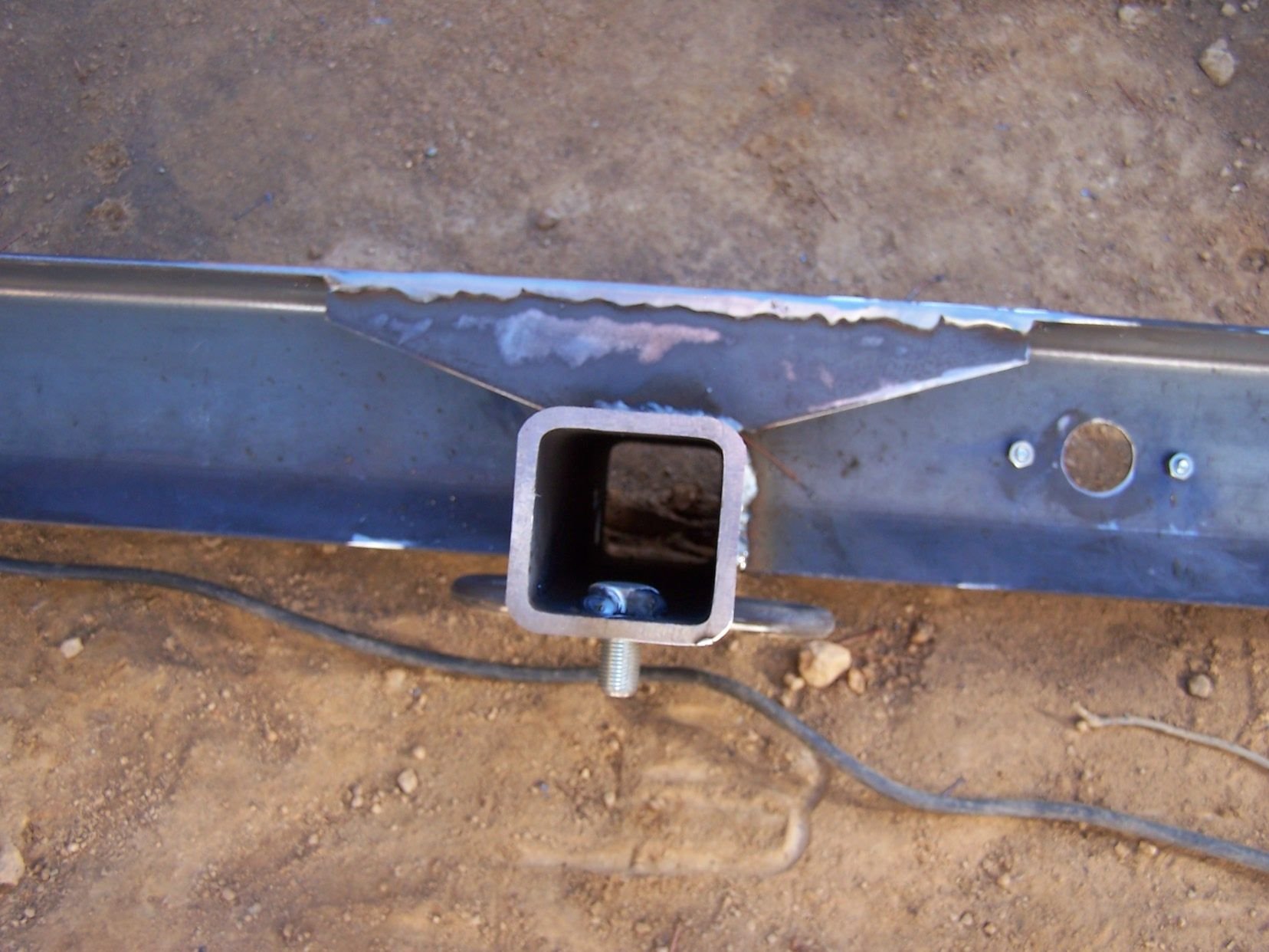

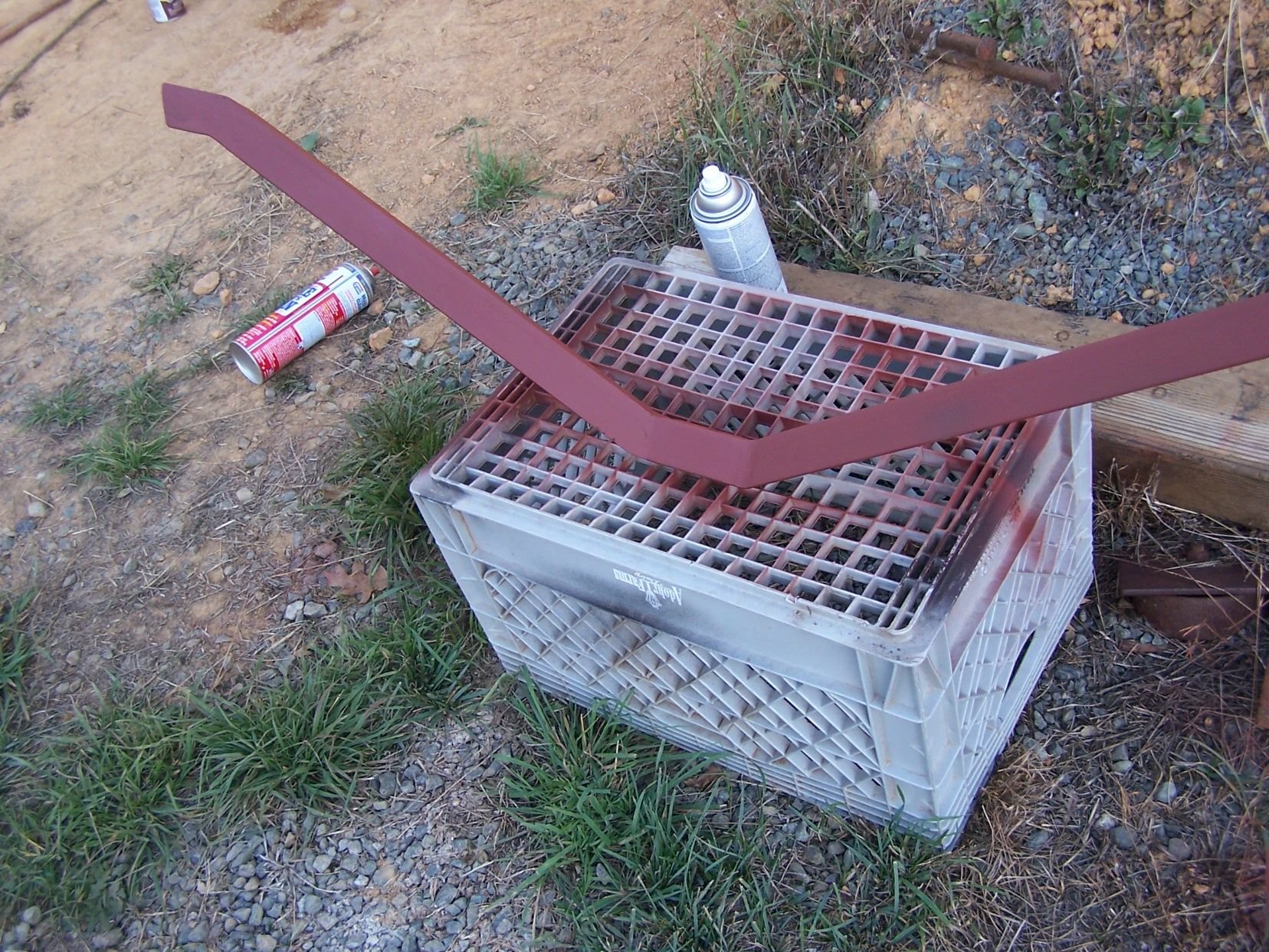

Making my own rear bumper. Haven't seen anything out there that makes want to purchase. Next step---Make my own. Few pics for ya. Waiting for the receiver chunk to come in Friday

I would be worried about that bottom lip "scooping" or catching if you drag the bumper off anything.

Yeah, when I first got the steel from them folding it I thought the bend was a little bit too shallow, but the bottom of the bumper is 24'' from the ground and I am not going to do any type of serious wheeling with this truck. This truck is going to be a daily driver for me and a winter truck. In the sketch I gave them to have it folded I had put down to do about a 20 degree bend. I should have gone for a 45 or 60. I don't like 90 degrees on the bottom as it acts like a lip and mud and crap stays there unless you're always hitting it with a hose

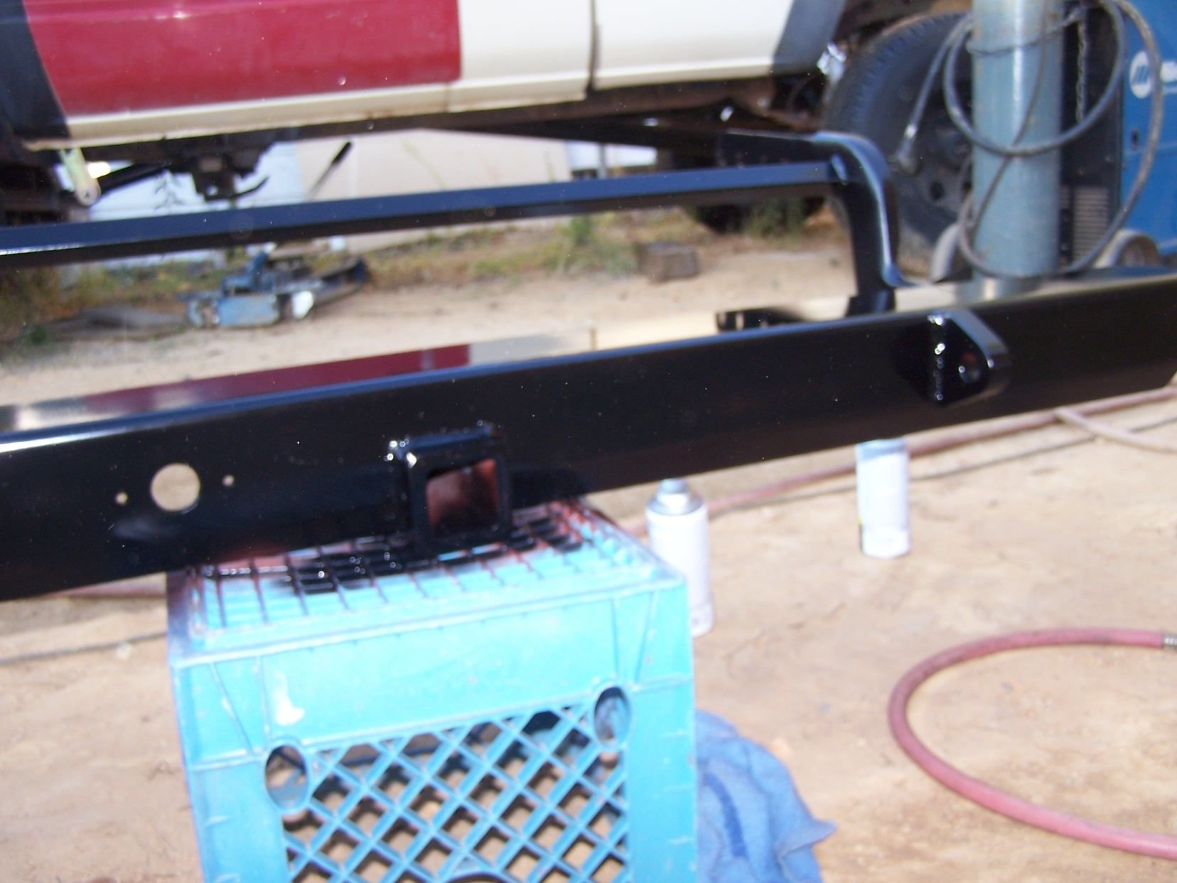

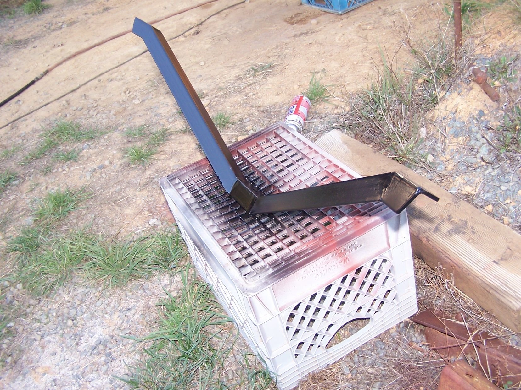

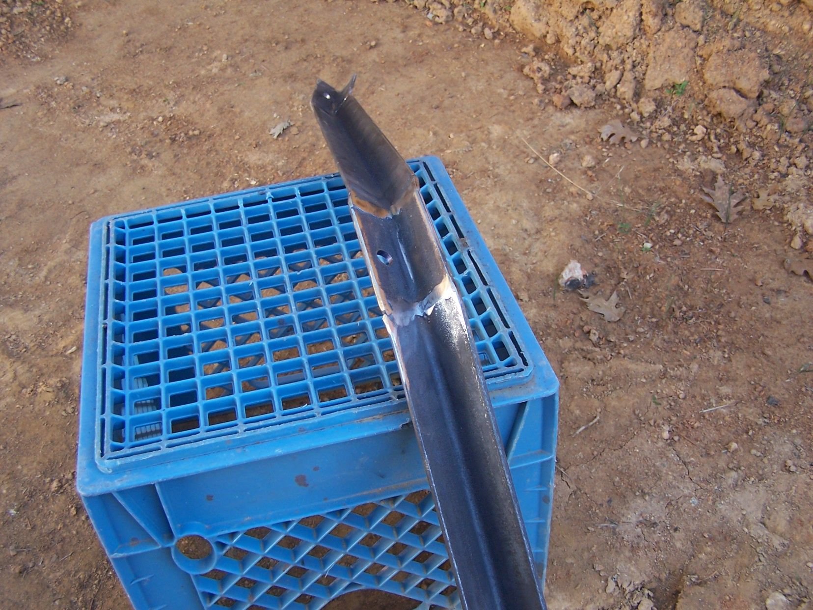

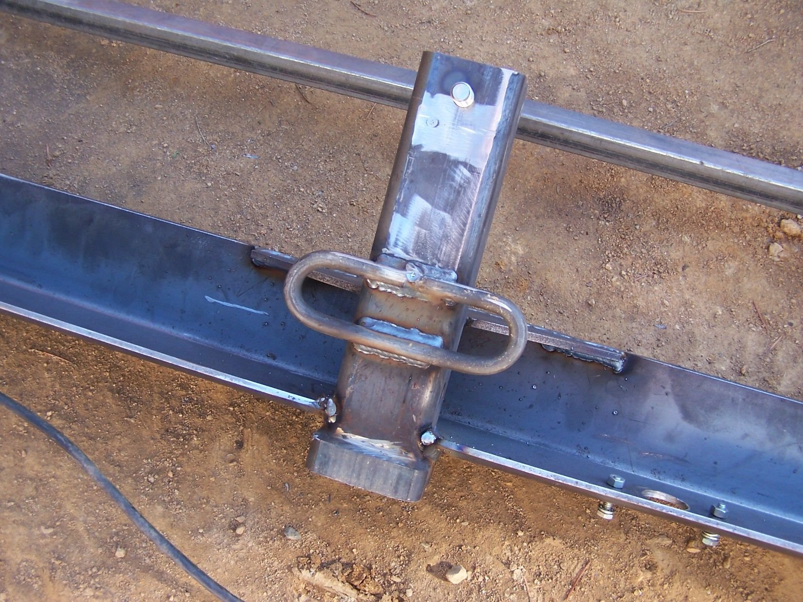

Progress Pics,,, got the receiver piece a day early and the chain holder

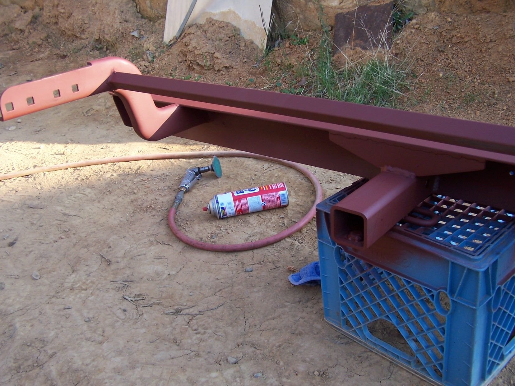

More pics coming after I paint and install it. Should be good for a 3500 to 4k trailer

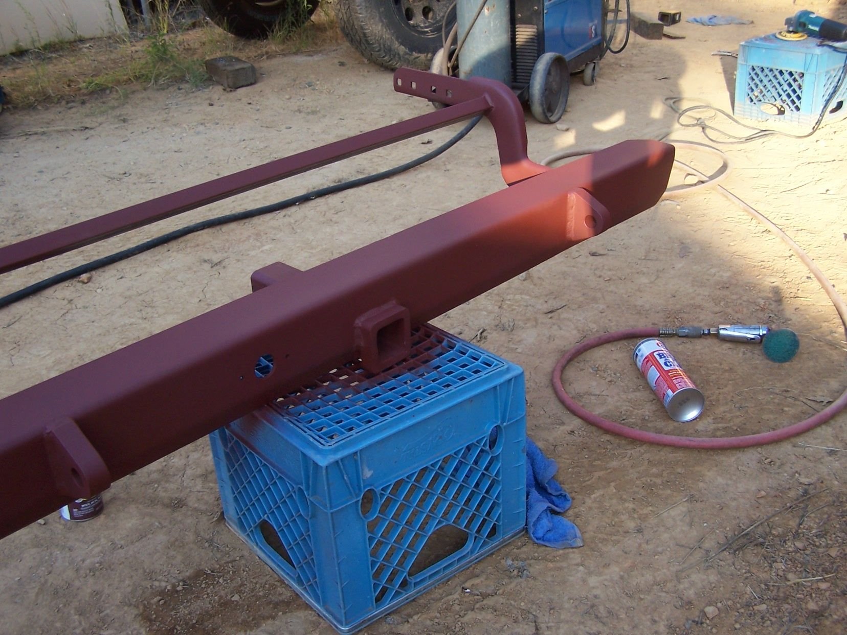

Painted
