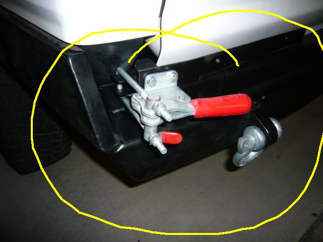

Looks good man , where did you buy the hardware
Attached Thumbnails Yet another 3rd Gen rear bumper thread-spindle.jpg   Yet another 3rd Gen rear bumper thread-latch.jpg
Old Oct 18, 2009 | 08:28 PM
Pikeman's Avatar
Joined: Jan 2009
Posts: 53
Link to the website
http://www.emsoffroad.com/store/inde...roducts_id=181

That thing turned out SWEET! Just because someone owns a shop doesn't mean the quality is going to be better. I've seen nicer things come from garages for alot less. Big props to you for making your idea come to life especially with the curcumstances you were forced to deal with. (I know them all too well myself!) Did you get those thick shackle mounts at the same place you provided the link above for?
Old Oct 19, 2009 | 08:51 AM
Pikeman's Avatar
Joined: Jan 2009
Posts: 53
Shackle Mounts came from Rockstopmer, they also have Tire Carrier hinges, but they dont offer as a kit with the latches.
http://rockstomper.netfirms.com/shop...b4400de64b7536
Thank you for the compliments.

Hopefully those links help you guys out. Beefed Taco, on the Rockstomper site they offer a builders pack on the carrier pivots.
