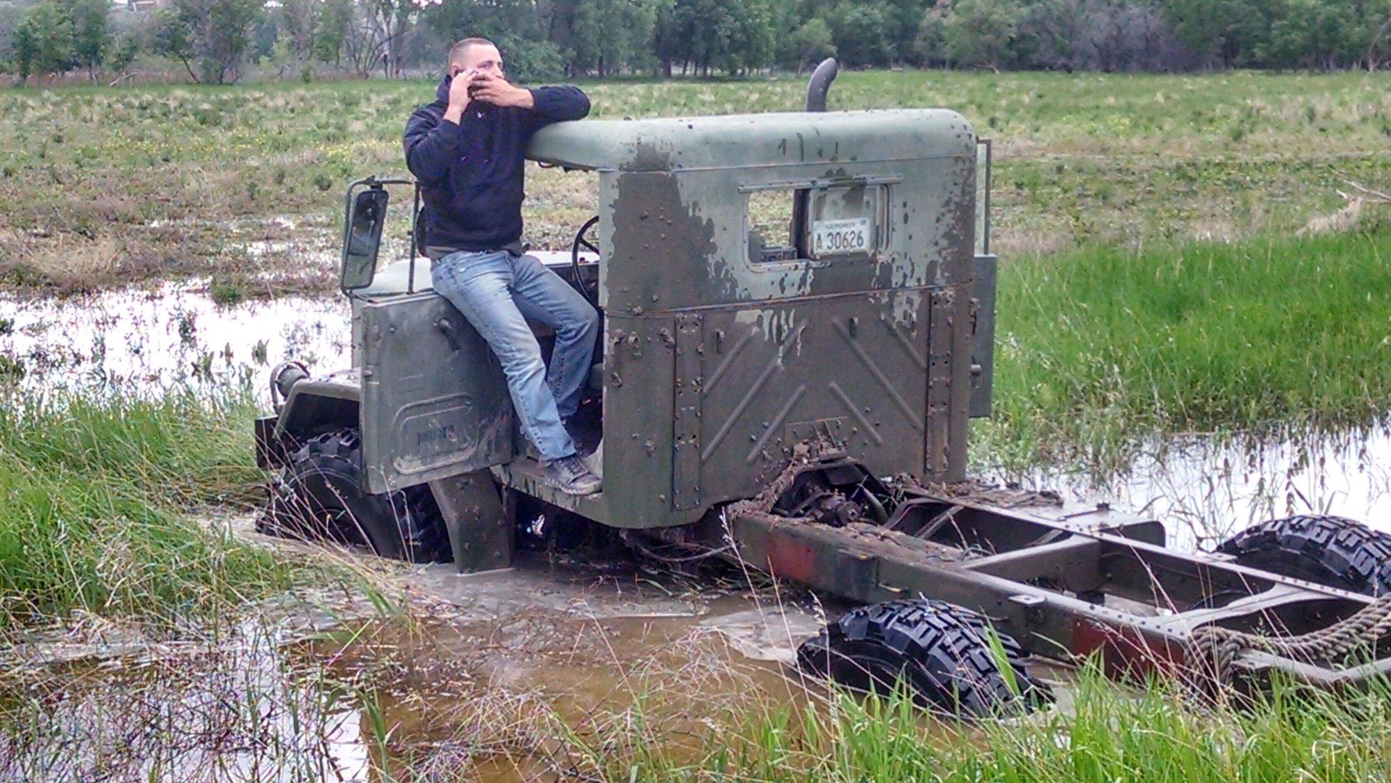

I dont wanna go mudding I have a bobbed deuce and a half for that (although it loves digging a hole haha) So ya... I guess just slowcrawling.

BTW, thats a badass deuce and half.

ah Thanks for the info I'll try pirate out. And thanks about the deuce too she's an eye catcher, and fun to drive, but it gets interesting working on that big of stuff all the time haha. Really gotta be ready for big jobs with it even relatively "little jobs"
