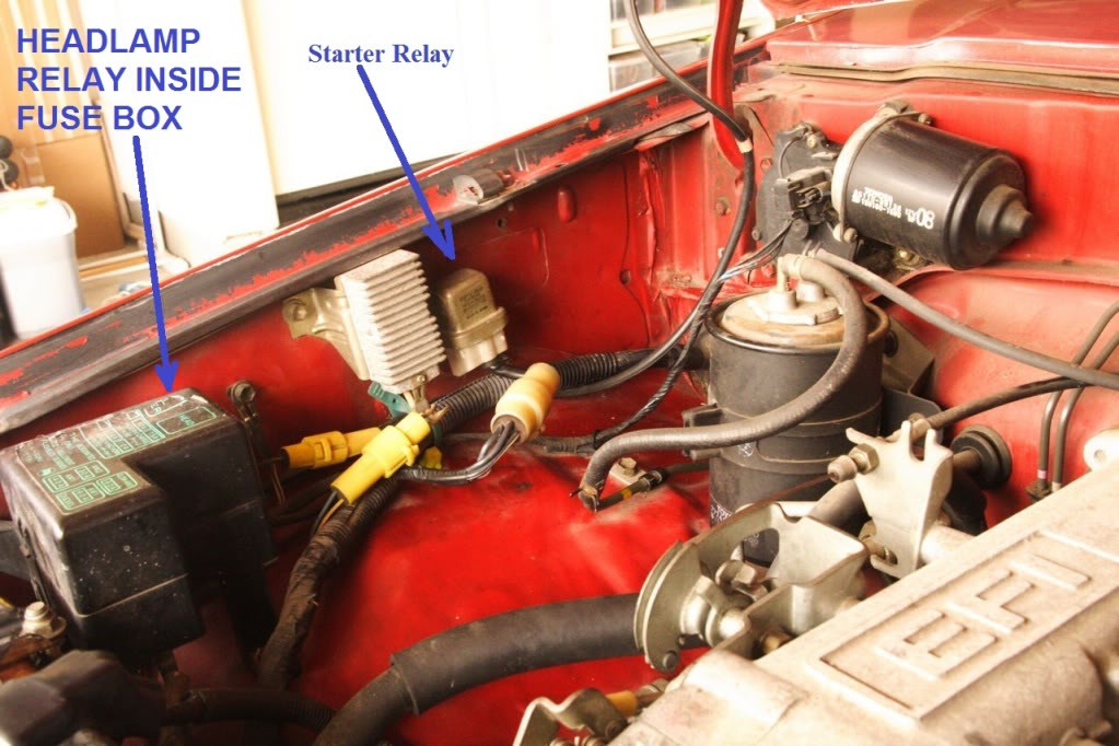

Here. Pic shows starter relay on Mid-86 to 88 4Runners with 22REliable.

Picture just happened to be labeled that way. Ignore headlamp stuff. not related.
