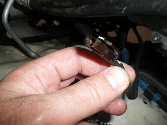

hello , I have a 85 4runner , 5speed, 22re, I was changing the oil and when I was taking off the oil filter , this wire came loose somewhere , and now the truck wont start , do you have a picture of where this wire goes . thanks

don't have a pic but i do believe its off the starter the clip if kind of hidden u might see it from under the truck. between block and side area i want to say.

It plugs into the starter. You might have to climb under and look at the starter from the front of the motor towards the back. Should be plugging into black plastic on the starter.

i agree with everyone else. it clips onto the starter.. look at the starter and you should be able to find it..

you guys are great , it was the starter on the bottom kinda hard to find
