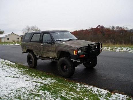

'85 4Runner Build...
After wheeling a Domestic SUV IFS...

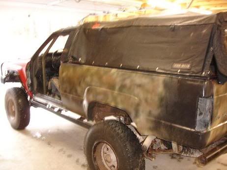

I finally wised up and bought an '85 4Runner last december...
Completely rolled it shortly after doin about 40 (No seat belts) and landing back on the tires ... Can anybody say dumbass . I Drove it home with some carnage and missing the antenna . I was deffinently impressed with the fact that other than cosmetics it ran like a champ and I have been wheeling it every weekend since but now its time to get it back on the road (Legally )
Credits to Josh the PO & what I got for 4000$
Mileage: 167,000 (Rebuilt engine 30,000)
Truck Rebuilt After First Roll (Put in Cage)
Hard Top
Steel Frame Cam-Back (NEW)
Northwest OFFROAD
Cam and Headers
Adjustable draglink
Anti-sway disconnects
SD Tyrod
3.5 inch springs (Rear)
1.5 inch shackles and shim (Rear)
Downey
3 inch springs (Front)
3/4 inch shackle and shim (Front)
Bilstein Shocks
Poly .5 body lift and bushings
Custom all-pro based T-case mounted disc E-brake
FJ-40 vented rotors w/ 95 V6 calipers
Custom
Rock sliders
Rear bumper
Full Interior Roll Cage
Frame - No Rust, urethane painted
Body - Re-done no rust
TJM Front bumper (Bullbar / Winch bumper)
Stainless Lines
This has made for an awesome base for me to start expanding on with everything I've learned from Pirate4x4.com. I've been reading thread after thread on anything and everything for the past few month's and am now ready to start 'attempting' to fab my own shat and pretty much make this truck bomb proof.
Past Weekend... Started Strippin the '87 Donor truck 250$ still runs , trimmed front fenders 2.5" (Rear soon to come), half doors (started), Lots of dent pullin
Before May 20th & Boot Camp ... Diffs. with 5:29's spool in rear (Marlin), Dual t-case adaptor (Marlin), Rear axle swap from the '87 w/ 1.5" spacers for front, Rear springs up front, Rear bobbed ?"s, gussets, Diff. guards, 2" BD, Brace the cage a little more, Clean-up Interior
After Boot Camp... 39.5" Swampers, Either ARB or AussieLocker up front, High Steer (Marlin)
Eventually... 30-spline chromoly super set (Longfieldsuperaxles.com), 4340 Chromoly rear axles (Marlin), 4-Link XX Rear and possibly front, 4.7 gears for second t-case
Goal... Trail ready for just about anything yet keeping the street legality

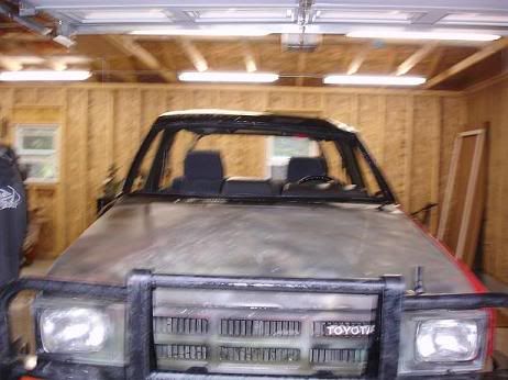

Pics of the Progress Last Weekend...
Carnage from the roll, Drivers side is sitting on the roll cage...

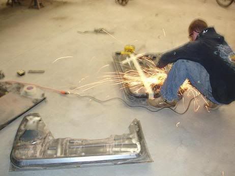

Half Doors Being Cut... Made a Few Measurements & Used Tape as a Guidline
Half Doors Mocked Up...

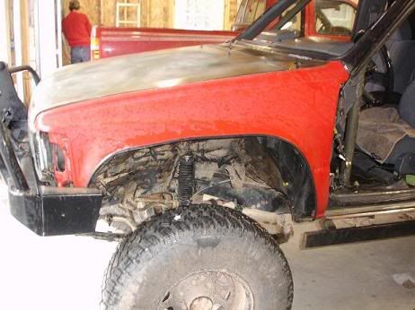

Fender Trimmed 2.5"s... Pic #1
The valence coming off the Brush guard was removed as well...
Fender Trimmed 2.5"s... Pic #2
