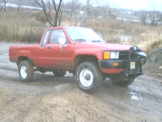

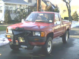

ok that is what i wanted to hear....well not really but yea.. thank you all for the suport. shell stay low for a lil bit till the spring rolls around.
heres sum pics for all of you for being so kind

85toy's Avatar
Joined: Jul 2007
Posts: 1,116
From: Arnold California
dang that is exactly the same truck i have same color and everything i wish mine only had 31k on it. nice clean looking truck.
Old Dec 24, 2007 | 11:50 AM
dropzone's Avatar
Fossilized
iTrader: (6)
Joined: Oct 2005
Posts: 19,771
Likes: 456
From: PNW
31K on your '85????
Please take the plow off your truck!! I would to have your truck to start a build one..though a lot of folks would say leave it stock. Sweet truck!!
Keep us updated on your progress...
Old Dec 24, 2007 | 12:12 PM
85toy's Avatar
Joined: Jul 2007
Posts: 1,116
i would leave it stock just because its in such good shape and the low miles, maybe restore it back to new condition. i mean if you really want to build a wheeler ill trade you straight up for mine lol. but its your truck so your decision but if it were me id hate to see suck a nice specimin be hacked up into a wheeler.
