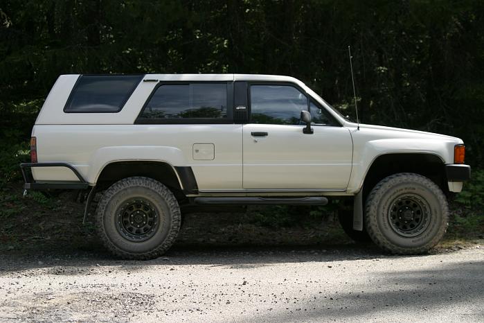

I have a 22re in my 1985 4Runner that just blew its head gasket. The engine was rebuilt about 30,000 miles ago. The engine was going through 3 quarts of oil every 3000 miles. My question is do I rebuild it with a new head or buy a long block from Oregon Engine rebuilders. My concern with rebuilding my current engine is that I will still be consuming all that oil. Is there a way to tell were the oil is going? I never notice it smoking. I would hate to put the money in a new head and have the bottom end be a problem. I'm leaning towards a different engine. I appreciate your opinions.

damn good looking rig....
If you got the money, want to save time, and are going to keep the rig for a long time.
I would go with the new motor, might as well put on a performance head. Less worry in the future and you have a spare motor to build or sell.
If you like tinkering want to save some money, have a spare car then rebuild.
In the end it seems to really be a factor of how much money you have.
