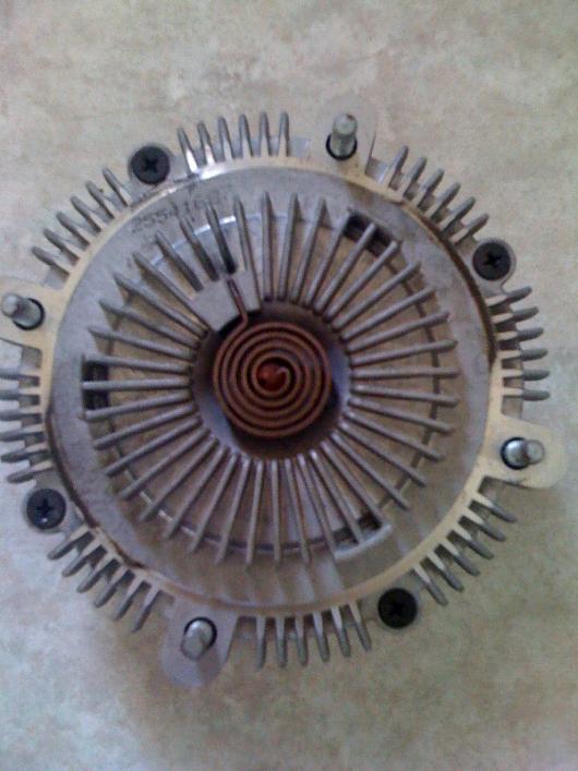

I finally got the time to pull off the fan clutch off my 1985 22R Pickup for service/rebuild. I was experiencing a rise in temperature at idle and determined that the fan clutch maybe the source of my problem.
Please see picture. I think the one I have is a replacement one and not the original OME AISIN one. Am I correct?
If that is the case, is it worth servicing/rebuilding it or should I just get a OME replacement? I read somewhere that the non-OME replacement ones are not very good.
Let me know what you guys think. Thanks for your help.

You mean OE- original equipment, OME is Old Man Emu, lol. Here is some info on a good clutch, same one thats on my 84.
Manufacturer- Hayden
P/N- 2554
In stock at CSK or O'Reilly auto parts
Edit--- here ya go---- http://shop.oreillyauto.com/ProductD...pe=176&PTSet=A

I put in a new AISIN fan clutch and problem solved. Thanks everyone.
